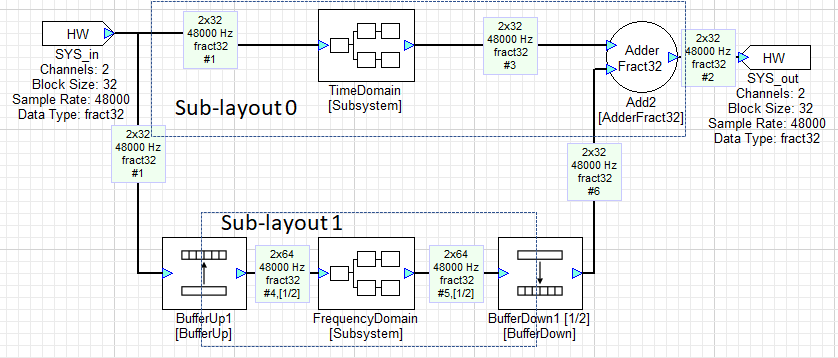

Multi-Rate Processing
The AWE Core OS library allows audio to be processed at multiple block rates. For example, consider a system with two processing paths: one that processes time-domain data in blocks of 32 samples and another that processes frequency-domain data in blocks of 64 samples but at 1/2 the block rate of the time-domain path. Each of these processing paths is called a sublayout, and each has a clock divider property equal to the inverse of the relative block rates. In this example, the sublayout with 32 samples has a clock divider of 1, and the sublayout with 64 samples has a clock divider of 2. Such a system is shown in the figure below. It uses BufferUp and BufferDown modules to connect the different block size domains. These modules effectively partition the layout into 2 sublayouts operating at different block rates. When this layout is pumped, the sublayout of 64 samples will only be processed half as often as the sublayout of 32 samples.
../images/multirate-layout.png
Real-time constraints dictate that if the 64 sample sub-layout is executed in the same context as the 32 sample sub-layout, both will need to complete processing before the next block of 32 samples arrives or real-time will be broken. This imposes an unnecessarily strict constraint on the 64 sample sub-layout – its processing need only be completed before the next block of 64 samples is accumulated. Thus, its processing time can, in principle, be spread over 2 of the 32 sample block times without breaking real-time requirements. The internal scheduling of layout pumping in AWE Core OS handles this spreading of sublayout execution times to allow for effective multi-rate processing.
See the CPU Affinity for Multi-Rate Designs section for more info about threading and CPU affinity.
When profiling multi-rate layouts, AWE Designer's Manual Profiling tool may provide more accurate results than the real-time profiling tools. The Manual Profiling Tool uses a simulated audio callback to manually pump samples through each sublayout in a multi-rate design. The tool can be found in AWE Designer's top bar, "Tools->Manual Profile Layout".

AWE Core OS internally creates/manages a unique processing thread for each sublayout in a design, as well as a mandatory "workThread" and an optional "socketThread" per AWE Core OS instance. For example, the design shown in the Multi-Rate section, consisting of a single bufferup/down module (1 clockdivider + base layout), would create two pumpthreads when not running in Low Latency (LL) mode. If running in LL mode, a single pumpthread (awe_pumpthread0) is created only for the second sublayout, because the baselayout is pumping within the user audio thread. See the Low Latency Pumping section for more information.
It is important to note that these threads are independent of the user's audio callback thread (where aweOS_audioImportSamples / aweOS_audioExportSamples and aweOS_audioPumpAll are being invoked). The user's audio callback fills the aweOS import buffers with new samples, calls aweOS_audioPumpAll, and then exports the latest available data from the AWE OS output buffers. The aweOS_audioPumpAll function then coordinates the created pumpthreads to execute as needed. Normally, the aweOS_audioPumpAll function does not block until the individual pump threads are completed, and returns immediately once the pump threads have been signaled. See the Low Latency Pumping section for more information.
In design described above, the following threads would be seen in top/htop in a Linux system while NOT running in Low Latency Mode.

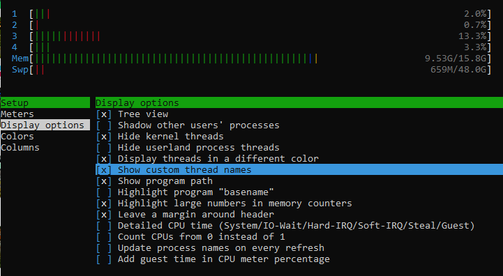

Note: if htop is not showing the names listed above, go to Setup (F2) -> Display Options and enable "Show custom thread names" as seen below. Enabling the Tree view display option is also helpful.
