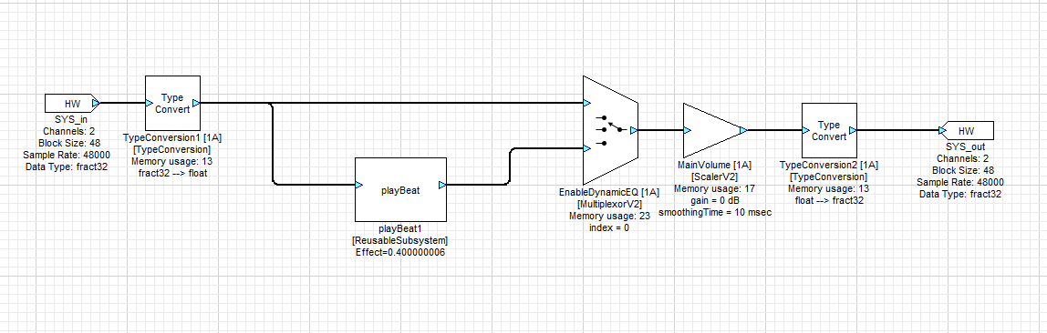

Figure 1 shows an example layout demonstrating the PlayBeat Reusable Subsystem. This example layout is designed to run in Native Mode with a file input; audio signals must be assigned to appropriate channels when running the layout on a target device.
In the example, a gain control module (specifically, the MainVolume ScalerV2 module) is placed after the PlayBeat Reusable Subsystem.
Figure 1: Example layout demonstrating the PlayBeat Reusable Subsystem

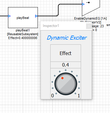

The PlayBeat Reusable Subsystem includes an inspector that lets users tune the strength of dynamic excitation (i.e., low-frequency beat emphasis) using an Effect knob. The Effect knob ranges from 0 to 1, with 0 yielding no effect and 1 yielding the strongest effect. DSP Concepts recommends using 0.4 as a default. A stronger Effect setting may cause low-frequency clipping distortion.
Figure 2: PlayBeat Reusable Subsystem inspector window
