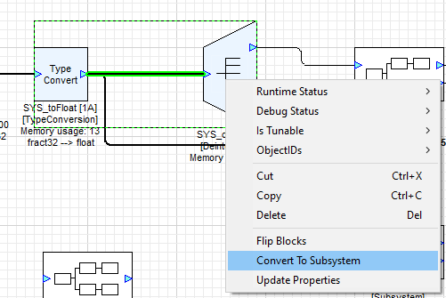

Select a group of modules and connections, then right click and select “Convert to Subsystem” from the popup menu. Pins will be created wherever your drag box crosses wires.

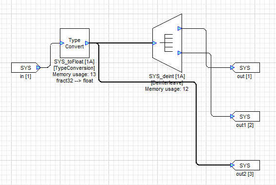

Existing connections are maintained through system pins.
Figure 4. System pins
In the subsystem, system pins are created for all connections to the next higher level.
Figure 5. Subsystem detail

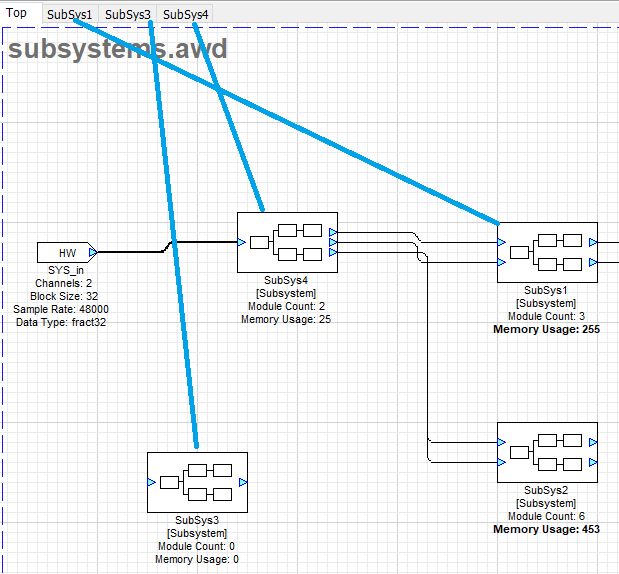

Subsystems are shown as tabs in the layout area once they are opened.
Figure 9. Layout tabs and subsystems
Subsystems can in turn contain additional subsystems resulting in a multi-level layout hierarchy. Double click on a subsystem block to go deeper into the hierarchy. To navigate to the next higher level, right-click on the layout canvas and select “Navigate Up” from the popup menu.

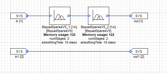

You may design a subsystem that passes an input pin directly to an output pin without any intermediate processing. If so, you will need to add a “Copier” module for the layout to be instantiated correctly. This Subsystem will generate an error:
Figure 12. Pass through signal in subsystem
Figure 13. Error Message

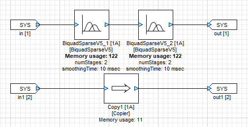

Adding the Copier module prevents the error. The Copier module uses a small amount of memory, so unless this pass-through signal being part of the subsystem is necessary, it would be better to avoid it.
Figure 14. Add a Copier module
