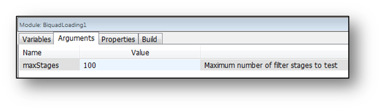

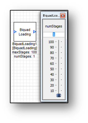

Biquad Loading
This module builds virtual biquads in memory with a number of max stages, and a variable that “turns on” the filter function. As data passes through, the mips and memory will update in the server window. This is useful for evaluating what kind of processing works and fits on a target. Set maxStages in the Arguments tab.

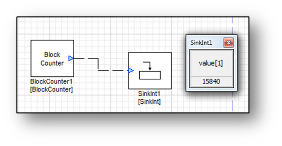

Block Counter
This module outputs the number of blocks processed based on the system BlockSize. This source increments for each block called at the hardware defined samplerate. It then outputs this value. This is useful for determining how many blocks get processed in the system, typically for debugging.

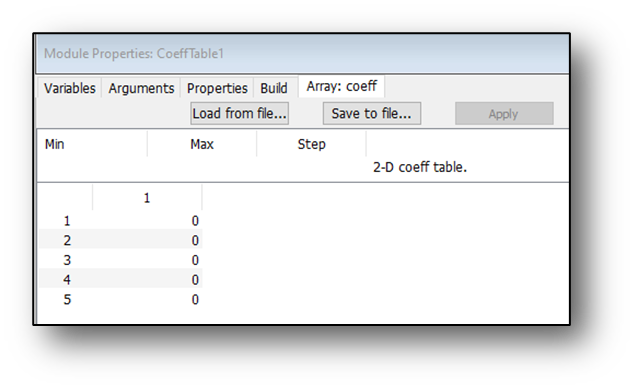

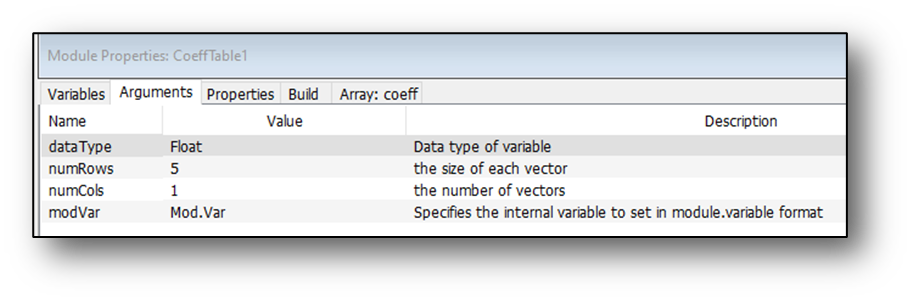

Coeff Table
This module is similar to paramSet, except it sends a vectored variable rather than a singular numeric variable. Set the coeffs to be sent to the variable by typing into the properties sheet, then clicking apply. Upon clicking apply, the coefficient data is sent to whatever module lies within the modVar argument.

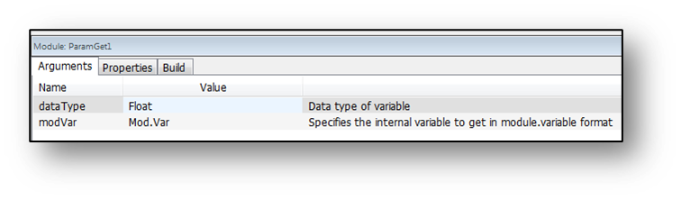

Param Get
The ParamGet module reads the value of a parameter from an existing module and outputs it on a wire for use elsewhere in the system. Which parameter to output is specified in the module properties, with “name of the module”.“parameter to be output”. An example of this module can be found in ParamSet and ParamGet.
ParamGet | Outputs a parameter from a specified module |

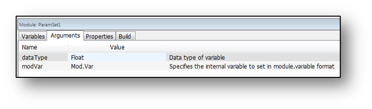

Param Set
The ParamSet module does the opposite: it takes an input from the system and sets its value to a parameter of an existing module. The key is that this module can set parameters of any type of module, which eliminates the need to create separate controllable versions of each module. An example of this module can be found in ParamSet and ParamGet.
ParamSet | Sets a parameter of a specified module |

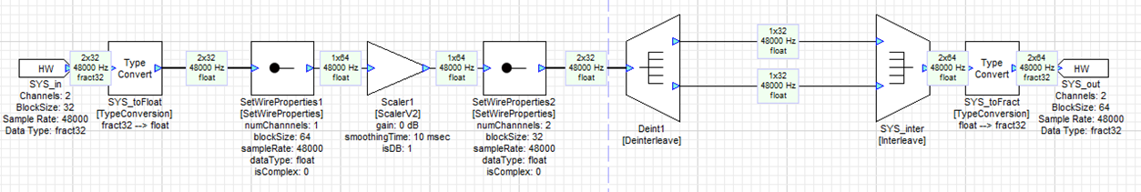

Set Wire Properties
This module is used to change wire properties for a more direct handling of audio weaver data values. It works by treating the samples as different block sizes, channels, data type, sample rate, and complexity. The only rule is that the samples in must equal the samples out. For example, at 48k and a block size of 32 stereo signal, that means there are 32 samples every block, or 64 samples per block of stereo information. These 64 samples can also be represented as blocksize=64, one channel. Notice the wire info and SetWireProperties modules in the following design:
While this doesn’t give much advantage in the time domain with standard audio data, this module is especially strong in the frequency domain to handle signal flow.

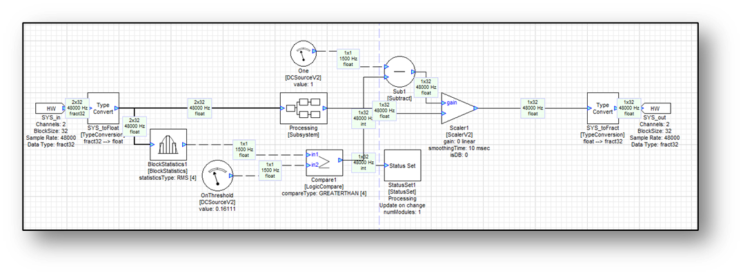

Status Set
This module can change the “status” of other modules in the design. This is useful for limiting compute cycles during runtime. To bypass a module during runtime, the status set module is given a variable name of where to point, and four controls for the status states: Active, Muted, Bypass, and Inactive. The input takes in an integer signal 1-4, with any other number gets treated as 1. These numbers represent the four states. If this control signal gets bypassed, then the status set module cannot turn itself back on. The diagram below is an example of a very low power “processing” system, which takes advantage of the status set module.
