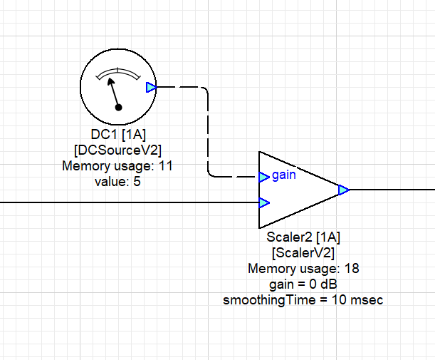

Wired control signals (Figure 1) such as the DC Source module, can be used to adjust parameters of modules, but this can also be accomplished with the ParamGet and ParamSet modules.
Figure 1: Wired Control Signal

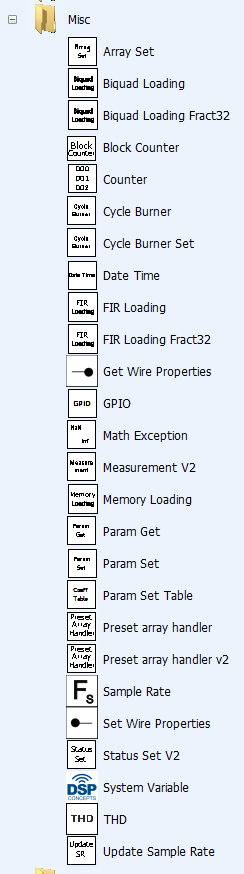

The ParamGet and ParamSet modules read and write parameters to and from existing modules in an Audio Weaver Designer layout, without the need of a wired connection.
These modules can be found in the ‘Misc’ module folder in Audio Weaver Designer’s module palette on the left-hand side of the Designer window:

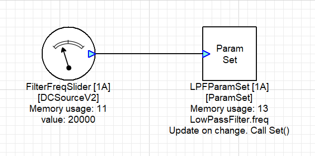

The ParamSet module takes a signal from an input wire and writes the incoming value to an instance variable in another module:
Figure 3: ParamSet Module
This module is useful for controlling the behavior of other modules in response to control signals or audio signals. This module can set parameters of any type of module, which eliminates the need to use and/or create controllable permutations of each module. The input wire can have any number of channels and any block size. The module only uses the first value in the wire and ignores all others. Internally the module uses two pointers. The first points to the base of the module being controlled. The second pointer points at the variable being written.

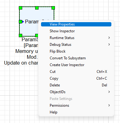

To set which module and variable the ParamSet module controls, right click on the ParamSet module while Audio Weaver is in Design Mode, and select ‘View Properties’ in the context menu:
Figure 4: ParamSet View Properties

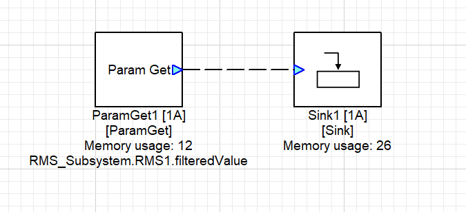

Param Get Module
Similar to the ParamSet module but opposite in functionality, the ParamGet module reads the value of a parameter from an existing module and outputs it on a wire for use elsewhere in the system.
Figure 9: ParamGet Module
Internally the module uses two pointers. The first points to the base of the module to get. The second pointer points at the variable to get within the module instance structure.

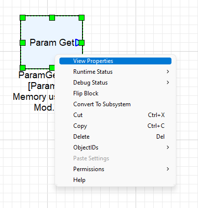

The parameter which the ParamGet module outputs is specified in the module properties. To set which module and variable the ParamGet module controls, right click on the ParamGet module while Audio Weaver is in Design Mode, and select ‘View Properties’ in the context menu:
Figure 10: ParamGet View Properties
The ParamGet module’s properties menu will appear at the bottom of the Audio Weaver Designer window. Navigate to the ‘Arguments’ tab to assign the desired module and variable you wish to control:
Figure 11: ParamGet Arguments Tab
Pictured above in Figure 11, you can see two arguments for the ParamGet module:
  • dataType
  • modVar
The functionality and syntax for each variable are identical to the ParamSet module, which are described in detail above.

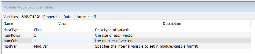

In the ‘Arguments’ tab, we can see the following fields:
  • dataType
  • numRows
  • numCols
  • modVar
Figure 18: ParamSet Table Arguments Tab
The dataType argument specifies the data type of the values in the coeffs array, defined in the module’s ‘Array:coeff’ Properties tab (float, int, fract32).
The numRows variable determines the length of each vector, and the numCols variable determines the number of vectors that can be stored in the internal table. It is the responsibility of the user to ensure that the numRows variable matches the size of the target module's array. If numRows and numCols are all = 1 then the module will assume a scalar value to write.
The modVar argument specifies the target module and array variable that the ParamSet Table module controls. The syntax is identical to the ParamSet syntax defined above in Table 1.
