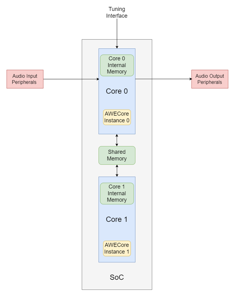

Consider a standard multicore SoC architecture:
Generic Audio SoC Architecture Generic Audio SoC Architecture
In this SoC architecture, there are two separate processing cores.
Core 0 has:
  • Access to the tuning interface
  • Access to all Audio I/O peripherals
  • Access to shared memory region
  • Its own internal memory region
Core 1 has:
In this typical multicore SoC architecture, an instance of AWE Core can be placed on each SoC core. The shared memory of the SoC is utilized by AWE Core to communicate between the two instances, as well as buffering audio data between instances. AWE Core handles all data exchange between instances; no user protocol or software needs to be written to facilitate.

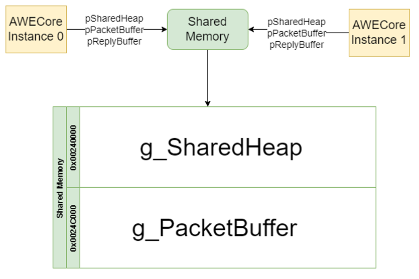

The shared heap is a contiguous section of memory which occupies the same physical address space for all AWE Core instances.
Shared Address Space Architecture
pSharedHeap points to this contiguous segment of memory. Every AWE Core instance in use is required to point to the same shared memory region address space. For this reason, shared heap must be placed in a shared memory region.
The size of this region is provided to AWE Core using sharedHeapSize.

Multi-instance AWE Core requires that the tuning packet buffer registered to each AWE Core instance occupy the same contiguous address space (see Figure 2).
Additionally, the pReplyBuffer reply buffer pointer registered to each AWE Core instance is required to point to the same packet buffer for multi-instance, as multi-instance AWE Core processes tuning packets in place.

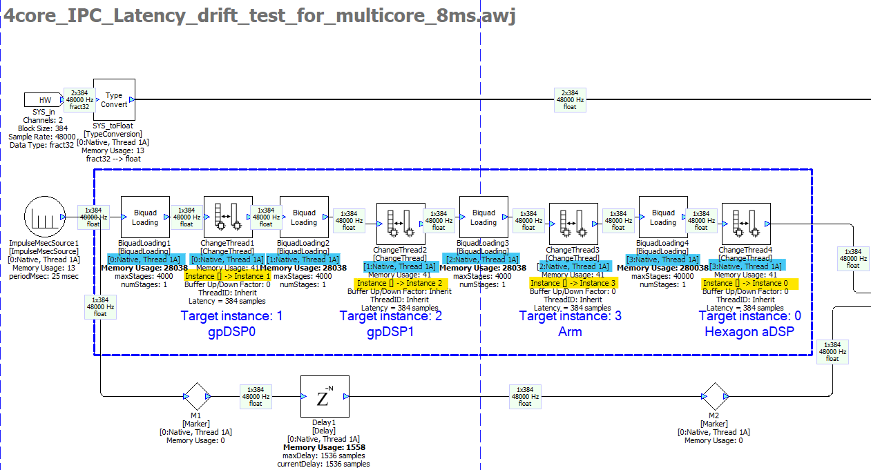

The Change Thread Module
The Change Thread module takes an input data wire, and using an argument targetInstance, directs this data to a new instance. Modules connected to the output of the Change Thread module will inherit this new instanceId.
Change Thread Example
You can also set these module arguments as needed:
  • numPins : number of input and output pins
  • bufferUpDown: change the block size if desired (defaults to "Inherit")
  • layoutSubID: Sub-ID of the destination clock divider (defaults to "Inherit")
The Change Thread module was introduced in AWECore 8.D.8/AWECoreOS 8.B.18 and supercedes the IPC Buffer module, which is deprecated.

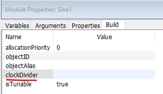

To reach the clockDivider field, right-click on the module and select View Properties.
In the Module Properties pane that appears, select the Build tab, and locate the clockDivider field.
Clock Divider Field

  1. Allocate a shared heap memory space in a memory region accessible to all AWE Core instances.
  2. Allocate the tuning packet buffer in a shared memory region accessible to all AWE Core instances. Initialize the reply buffer pointer to the same memory region as the packet buffer.
  3. For each AWE Core instance, provide the shared heap and shared packet buffer, ensuring they occupy the same address space in memory for each instance.
  4. Provide a unique instanceId to each AWE Core instance, with instanceId 0 reserved for the AWE Core instance connected to the tuning interface.
  5. Set the numProcessingInstances member of each AWE Core instance to the total number of AWE Core instances on the target system.
  6. Using a global software interrupt accessible to all AWE Core instances, trigger each instance to check their pump mask and pump. This trigger is required to be synchronous to the audio peripheral data passed in/out of AWE Core instance 0.
  7. Process packet buffer data using the multi-instance packet process API. For the tuning master instance, the API is called once a complete packet is received. For non-tuning instances, the API is polled in a low-priority task.
