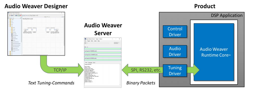

As shown below, there are 3 main components of an Audio Weaver system that require communication in order to tune an audio system. The Designer GUI will generate text based tuning commands (AWS) based on the layout and any user tuning commands. These commands are sent to AWE Server, which in turn compiles the AWS commands into binary commands (AWB) that are sent to the target running the AWE Core. The target processes the AWB commands and then generates a reply message that is sent back to the AWE Server.
The text-based commands may also be generated by external tools and scripts rather than by AWE Designer. Example scripts, written in Python and MATLAB, are shown below. These scripts connect to the AWE Server at TCP port 15007 (to bypass port 15001, which AWE Designer GUI uses) and reads and writes the ScalerDBControl module’s currentGain variable in an active layout in real-time. The remainder of this document describes the full set of tuning commands and arguments.

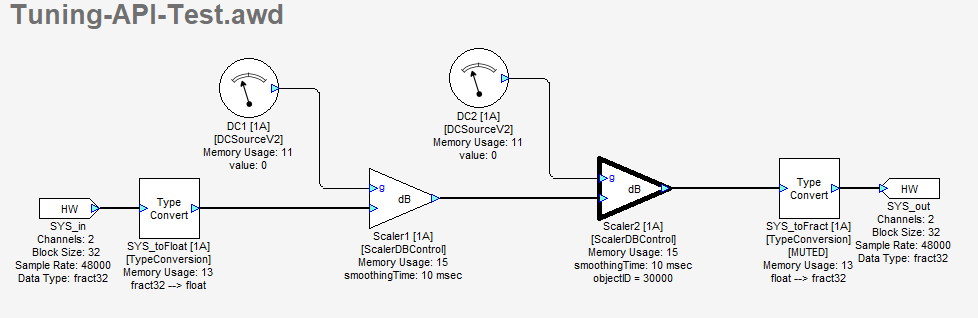

The AWD which works with these scripts is attached below. Load this AWD into Audio Weaver, then build and run the layout. Finally, run the script.

Note the integer value that comes after the “success” status in the responses. This is the parameter ID for the chosen module variable that you accessed using the Mod.Var format. In the case of Scaler1, no objectID was assigned, so this value is dynamically determined when the layout is built and run (i.e., unpredictable).
If you assign an objectID, as is shown with Scaler2 below, the value will be the decimal equivalent of that parameter’s handle, as shown in the generated ControlInterface.h file:
#define AWE_Scaler2_currentGain_HANDLE 0x07530009
0x07530009 = 122880009 (decimal)
