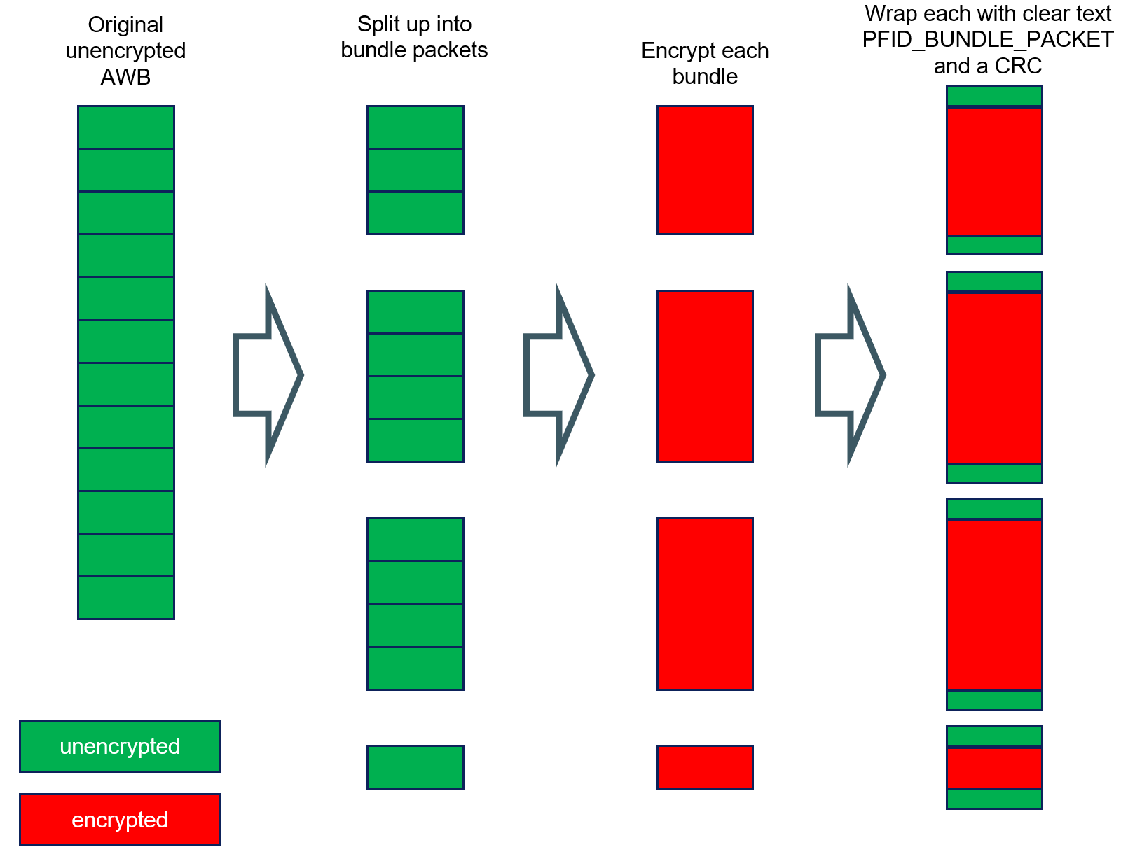

Details
The process of creating the Bundle Packets is illustrated in the figure below. It starts with an unencrypted AWB file on the left hand side. The individual commands in the AWB are extracted and then combined to form bundle packets. The size of each Bundle Packet has to be less than the (Tuning Buffer Size – 4) words. Only whole packets are combined – we never split packets between bundles. The size of the final Bundle Packets will vary based on the sizes of the internal packets.
The next step is to encrypt the Bundle Packets. This is optional but makes the contents opaque. Finally, the encrypted PAYLOAD is combined with the 4 additional words in bold.

The final result is an AWB file which is slightly larger than the original but has fewer total commands. The header information in the AWB is unencrypted (shown in green) and can flow through an Audio Weaver system using standard packet handling.
