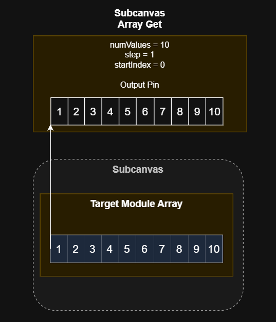

Perfect Overlap
This is the easiest case, and the most common. The target array is the same size as the module output, step == 1, and startIndex == 0. The target array is simply copied to the module output.

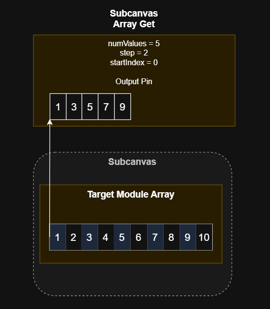

Perfect Overlap with Step
In this example, the output pin size is 5, the target array size is 10, and step is 2. startIndex is 0. With a step of 2, every other element of the target array is written to the first 5 elements of the Subcanvas Array Get output pin.
This is one way to extract the first channel only from an array with stereo data.

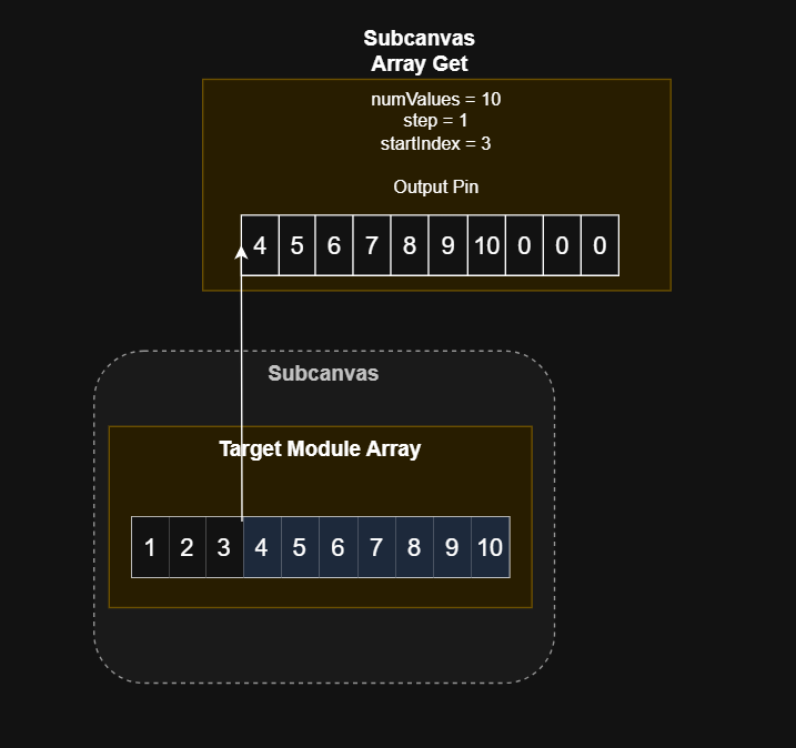

Partial Overlap, Positive Start Index
In this case, startIndex is > 0 and step is 1. This means that the overlap between the target array and the module output is smaller than numValues. The first numValues - startIndex values of the output will be equal to the startIndex:arraySize-1 elements of the target array. The remaining 3 elements of the output that do not overlap with the target array are zeros.

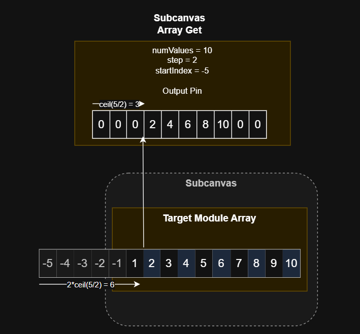

Partial Overlap, Negative Start Index, Non-Unity Step
In this case, startIndex is -5 and step is 2. This again means that the overlap between the target array and the module output is smaller than numValues. However, since the overlap covers the left side of the target array, the first startIndex / step values of the output will be zero. The remaining values will be copied from the beginning of the target array, at intervals of 2 until the end of the target array is reached.
As seen above, the first value that can be read from the target array is calculated as step * ceil(-startIndex/step). In this case, that means that we move forward 6 spaces in the target array, starting at -5. So the first element read is the second element in the array (array[1] in C syntax), which is equal to 2. Since step does not apply to the output pin, we skip ceil(5/2)=3 elements in the output pin and write the first value in the 4th element. We continue copying every other value (step = 2) from the target array to sequential values in the output pin until we reach the end of the target array. In this case, the final two values of the output pin are filled with zeros.
