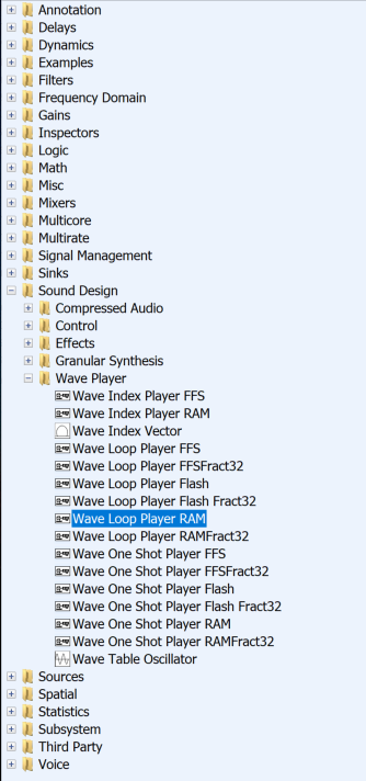

The Wave Loop Player module is a WAV file player. The module plays out the .wav file in a loop mode. The module can be found in Sound Design->WavePlayer-> Wave Loop Player in the Module Bar on the left-hand side of the AudioWeaver Designer.
Figure 1: Wave Loop Player module location

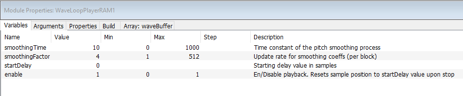

Variables:

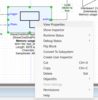

The variables are the first tab in Module properties which is Rt Click on the module View Properties.
Figure 3: View Properties
Arguments:

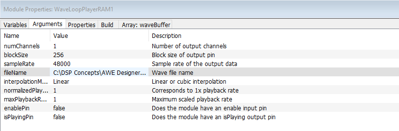

Arguments can be found Rt Click View Properties second tab in the properties as shown. The following table shows the list of arguments in the Wave One Shot Player RAM module, explanations’ along with their respective default values.
Figure 4: Argument Tab for Wave Loop Player RAM
Arguments Description Default Value
numChannels Number of interleaved channels in the audio output pin. By default, numChannels = 1.
blockSize Number of samples per output channel. By default, blockSize = 256.
sampleRate Sample rate of the output signal, in Hz. By default, SAMPLERATE = 48000.
fileName Name of the wave file to be played. By default, WAVFILE = ''.
InterpolationMode interpolation method.Linear Cubic By default, INTERP = linear. (Only in floating point variant)
normalizedPlaybackRate normalized playback rate. By default, NRATE = 1.
maxPlabackRate Maximum playback rate (relative to NRATE). By default, MRATE = 1.
isplayingpin Boolean that provides the current playback state (PLAYING=1, STOPPED=0)
enablePin Does the module have an enable input pin By default, False

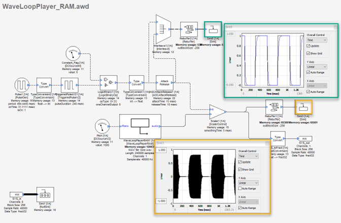

In the example shown below, we are using a Sine 1kHz wav file in the Wave Loop Player RAM module. Input the wave file path into the argument filename. For input to the fRatio we are using a controlled pitch to convert the continuous sine tone into intermediate bursts. The Pulse Gen module is onTime at 31msec which is used as a trigger for the Triggered Pulse generator. Both the triggered pulse and the continuous sine tone out from the Wave Loop Player are given to the controlled scalar module. The triggered pulse acts as the control to the scalar module input which the sine tone in our case. The output is the trigger-controlled bursts of sine tone.
Figure 5: Wave Loop Player RAM Example

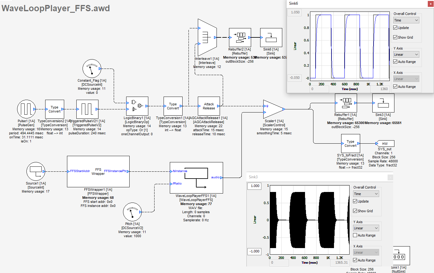

Workings
We are using the same example as for the RAM variant for the Wave Loop Player. In this case we the Sine wave file is being fed through the FFS Wrapper as a .bin file. The output is the same as compared to the RAM variant. The triggered pulse acts as the control to the scalar module input which the sine tone in our case. The output is the trigger-controlled bursts of sine tone.
Figure 7: Wave Loop Player FFS Example

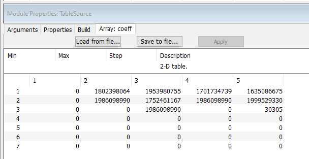

For Wave Loop Player Flash module, we need AWE Pro version with MATLAB. The example ‘WaveLoopPlayer_Flash.awd ‘ uses TableSource module with the names of all the wav files in order which is then fed via the Arrayset module to the WaveLoopPlayer’s fileName argument. To fill the TableSource module with the list of wave files in an excel sheet called ‘Create_wavemapping_table ‘ as shown below in figure 9.
The ‘create_wavemapping_table.m’ script reads the list if wave names in the excel sheet and converts them into appropriate format to be loaded into the TableSource coefficient’s table which looks like figure 10. The MATLAB script then saves a new awd with the loaded coefficients under the name _mapped.awd
Figure 9: Create_wavemapping_table excel sheet
Figure 10: List of Wave names loaded into TableSource coefficients.

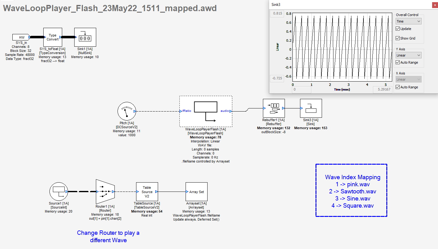

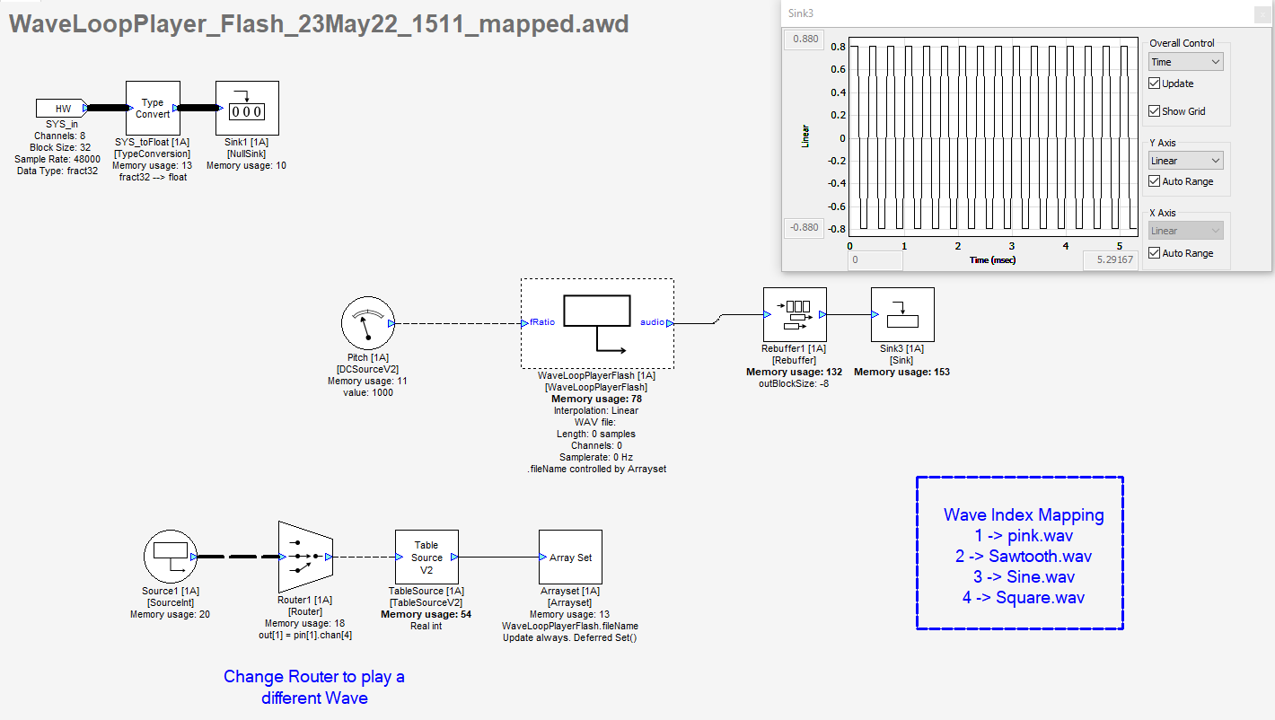

When the _mapped.awd is run, the wave files are played in a loop by the Wave Loop Player Flash in the order fed in the excel sheet. The input index can be changed by changing the router channels to play the corresponding wave file as shown in figs 11 and 12.
Figure 11: Wave One Shot Player Flash Example
Figure 12: Wave Loop Player Flash example with Sawtooth Wave
