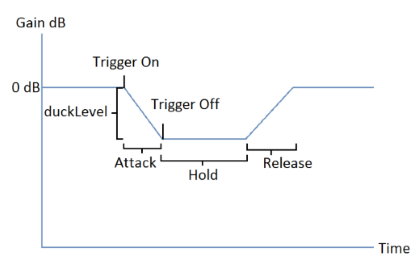

Ducker - use a trigger signal to determine when to boost or reduce gain of another signal.

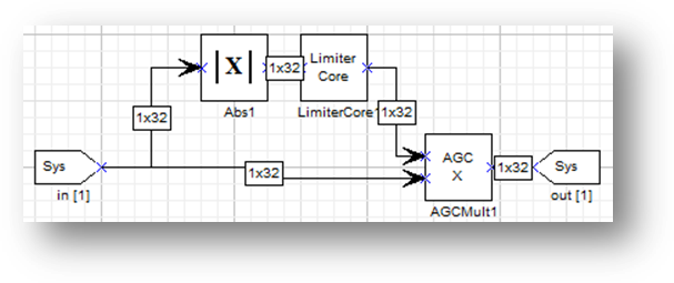

Limiters
The AGCLimiterCore module is parameterized by its threshold, ratio, gain, knee depth, attack time, and decay time. The AGCLimiterCore module computes the time varying gain.
Take the absolute value of the signal so that the AGCLimiterCore module treats positive and negative signals equally. The first pin on the AGCMultiplier is the gain to apply and the second input is the audio signal itself.
(standard arrangement for a mono limiter)

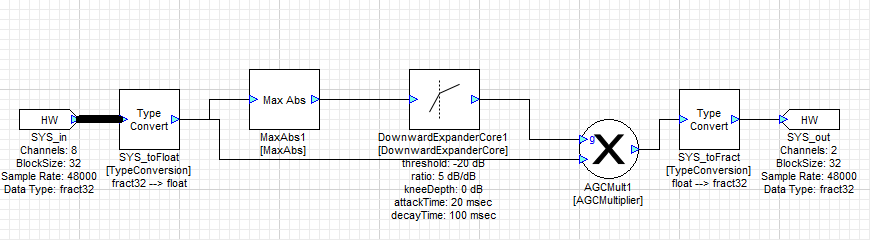

Downward Expander
The DownwardExpanderCore module is also a limiter with a piecewise gain, but its piecewise function is different. Whereas most limiters use a slope of 1 below a threshold and a reduced slope above it, this module features a very steep slope below its threshold and a slope of 1 above it. Rather than reducing the level of loud signals, this reduces the level of quiet signals.
The DownwardExpanderCore module’s response behavior
One use of this module is for filtering out low-level noise while retaining a louder signal. This is very useful for eliminating “hiss,” low level background noise in a signal. Like most dynamic processing modules, the DownwardExpanderCore is designed to take its input from the MaxAbs module and output its gain as an input to the AGCMultiplier module.
Example of a noise gate which eliminates low level signals

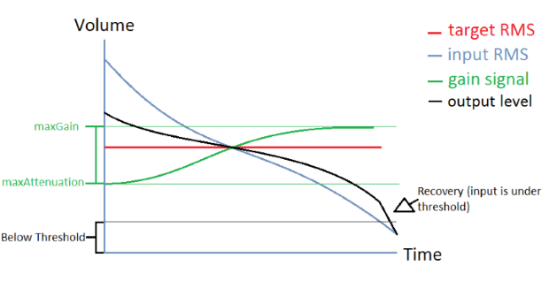

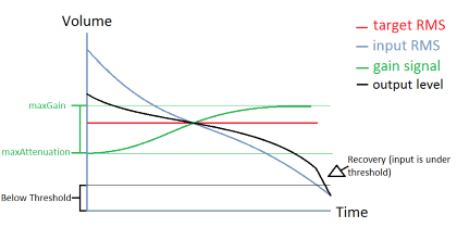

AGC Core
This module has a slowly varying volume control which transfers the input signal level towards a targetLevel, a specified RMS level. The input RMS is smoothed via the smoothing time variable. This allows the gain to change gradually. The gain is limited to the range [-maxAttenuation and maxGain]. The ratio control determines the speed of the gain change for all signals above the activation Threshold. When the level of the input signal falls below activationThreshold , the AGCCore holds the last gain setting. If the enableRecovery checkbox is checked, the gain will slowly return to 0 dB when not activated. The rate of return is governed by recoveryRate.
