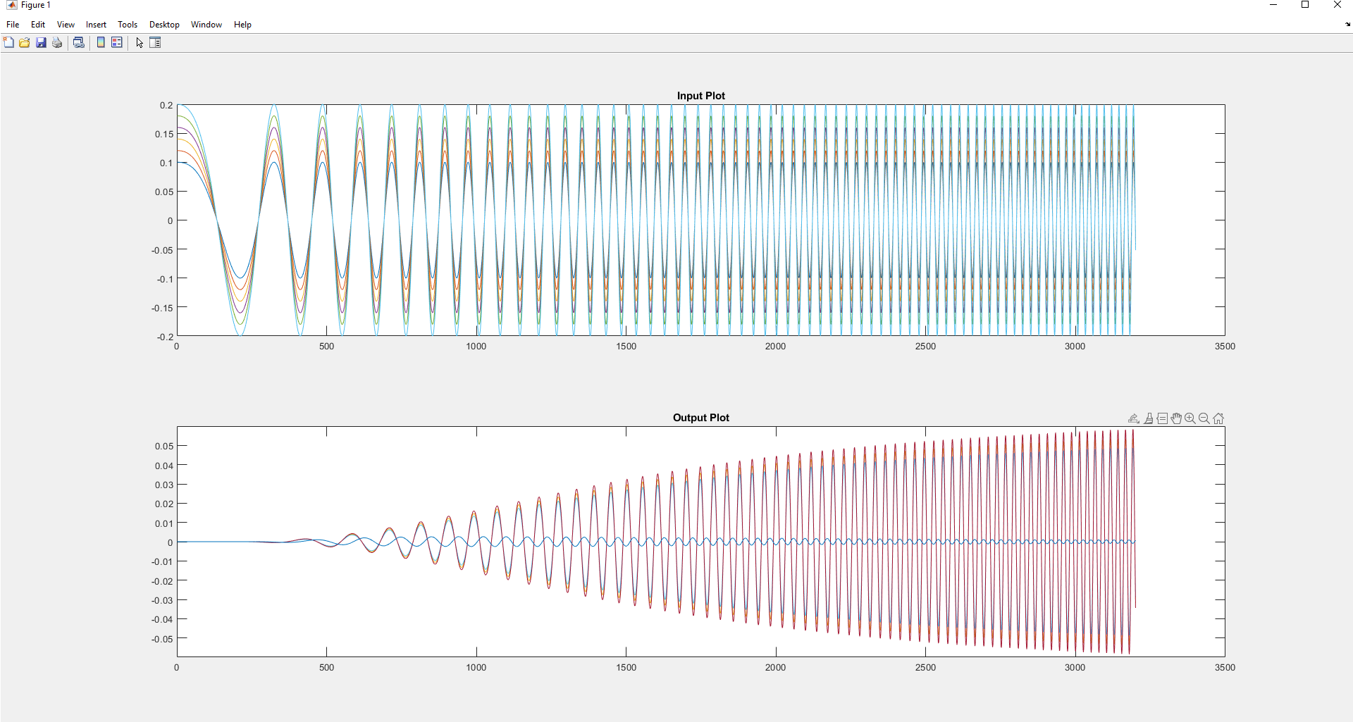

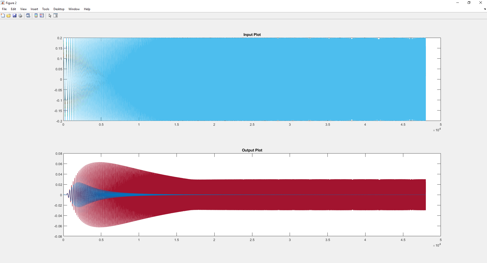

Output Processing
The processing can be configured by changing the number of audio blocks to 100 or varying it according to the block size in the AWD. The output plot for 100 blocks is as shown.
Figure 1 : Plot of input vs output for 100 blocks
Figure 2: Output vs Input Plot for 750 Blocks
