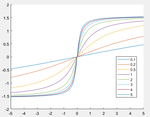

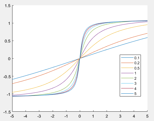

The arctangent function y = arctan(k * x) has this curve family for varying values of x:
Figure 2. function y = arctan(k * x) for different values of k

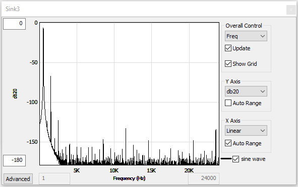

Figure 4. Baseline spectrum
Test signal = 500 Hz sine wave at 0 dB.

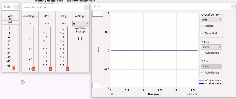

  • NumStages = 1
  • KPos = 0.1
  • KNeg = 0.1
  • InvStages = 0

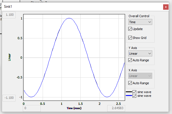

Figure 5. Waveform (kPos = kNeg = 0.1)

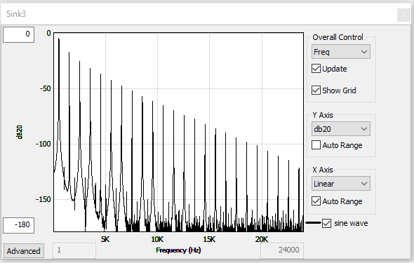

Figure 6. Spectrum (kPos = kNeg = 0.1)
Input = 0 dB. Input and output are overlaid and are so close that it is difficult to see the difference.

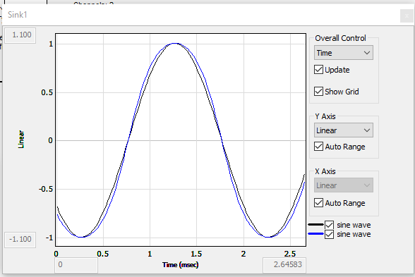

  • NumStages = 1
  • KPos = 1.0
  • KNeg = 1.0
  • InvStages = 0

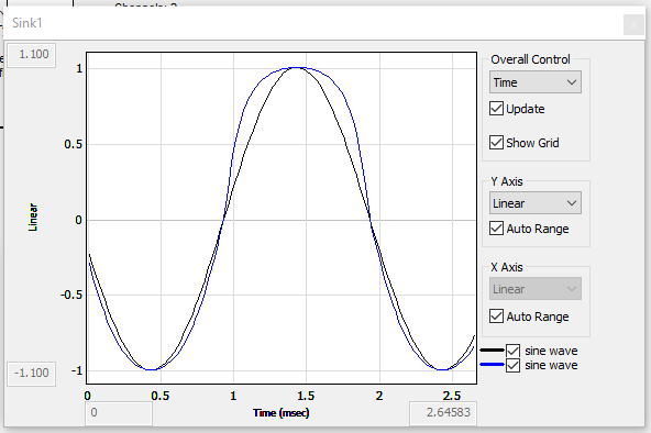

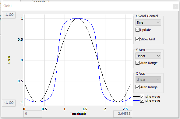

Figure 7. Waveform (kPos = kNeg = 1.0)

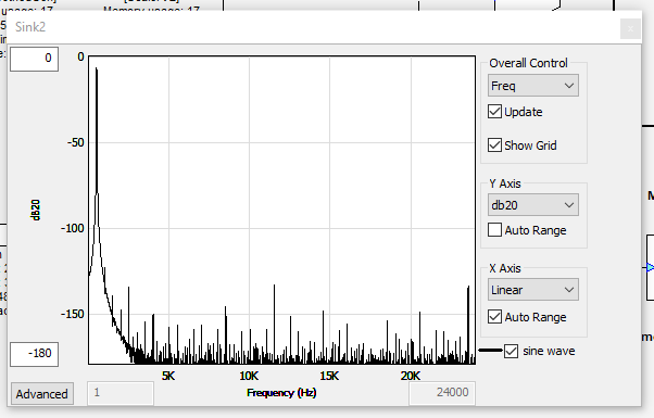

Figure 8. Spectrum (kPos = kNeg = 1.0)

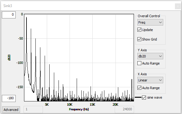

  • NumStages = 1
  • KPos = 5.0
  • KNeg = 5.0
  • InvStages = 0
Figure 9. Waveform (kPos = kNeg = 5.0)
Figure 10. Spectrum (kPos = kNeg = 5.0)

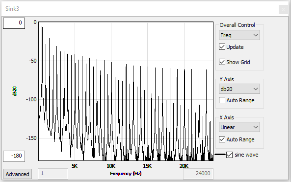

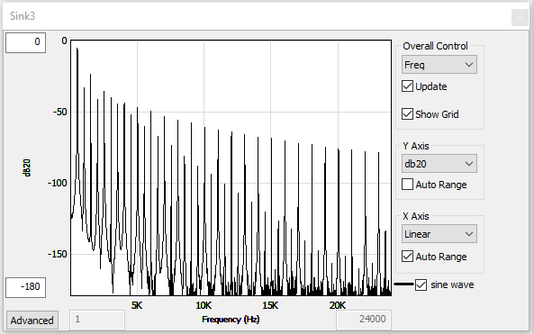

Asymmetrical distortion
Asymmetrical distortion can be implemented easily by using two different k-values, one for positive input samples and the other for negative ones. This asymmetrical distortion is found in Class-A tube circuits. Note that unbalancing the waveshaper introduces even harmonics.

  • NumStages = 1
  • KPos = 5.0
  • KNeg = 1.0
  • InvStages = 0

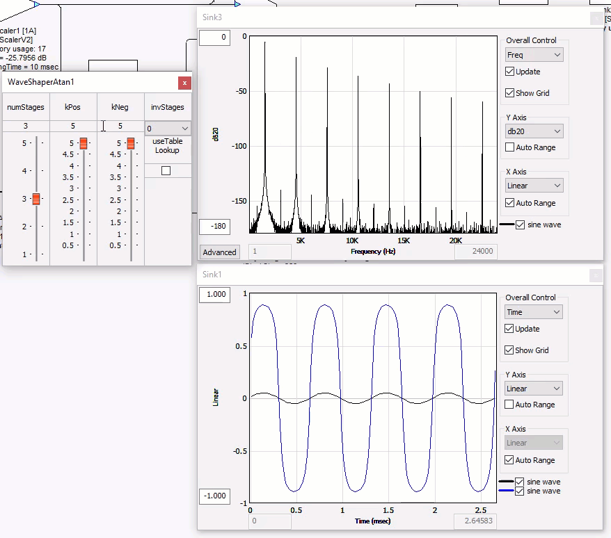

Multiple stages
Cascading multiple stages will result in more gain for low level signals. Ultimately, with high enough signal level, k and number of stages, the waveform will tend towards hard clipping. If you wish to distort even low-level signals, increase the value of k and/or the number of stages to get the desired result.
Figure 15. Effect of using multiple stages

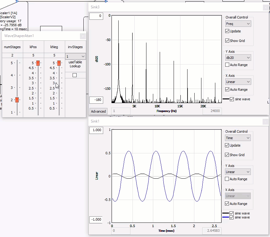

Inter-stage inversion
In many electronic amplifiers the gain curves are inverted in between each stage. The resulting sound is quite different than simply cascading the modules without inversion. These differences are accentuated when kPos and kNeg have different values.
Figure 16. Interstage inversion when numStages is odd
When using inversion, setting numStages to an even number (2 or 4) eliminates much of the asymmetry, regardless of the settings of kPos and kNeg.

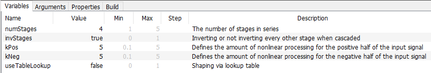

Figure 18. useLookupTable selection in module inspector
The number of data points to use is set with the “tableSize” argument.
The memory heap to use is set by the “memHeap” argument.
Figure 19. Module arguments

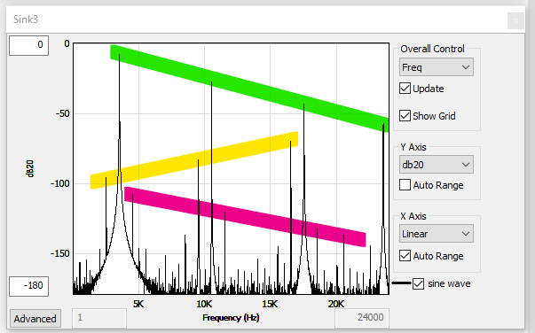

Aliasing
Note that it is possible to cause aliasing with sufficiently high settings of k, numStages, and/or the input level. The peaks highlighted in yellow and magenta below are aliased. For an example of using oversampling to reduce aliasing artifacts, review the “guitar_distortion.awd” Audio Weaver layout in the Examples folder. The atan shaper can be used in place of the soft clipping module.
Figure 20. Aliasing
