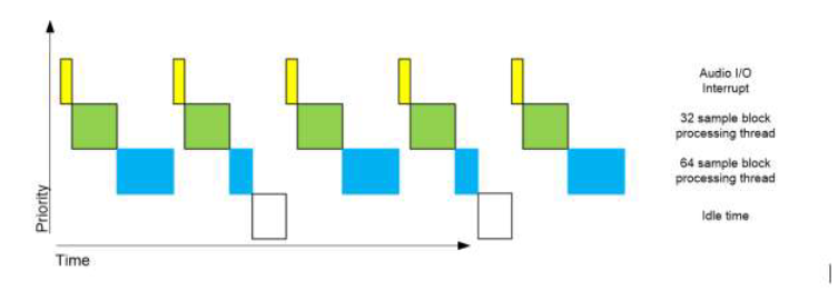

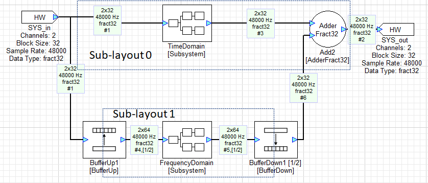

Multi-Rate Processing
The AWE Core allows audio to be processed at multiple block rates. For example, consider a system with two processing paths: one that processes time-domain data in blocks of 32 samples and another that processes frequency-domain data in blocks of 64 samples but at 1/2 the rate of the time-domain path. Such a system is shown in the figure below. It uses BufferUp and BufferDown modules to connect the different block size domains. These modules effectively partition the layout into 2 sub-layouts operating at different block rates.
../images/multirate-layout.png
The two paths are executed at different rates and AWE Core’s awe_audioGetPumpMask() API call provides a mechanism to determine when the processing for each path should be initiated. Consider the following pseudocode:
layoutMask= awe_audioGetPumpMask(&g_AWEInstance);
if (layoutMask & 0x1) raise(AWEProcess_HiPrio);
if (layoutMask & 0x2) raise(AWEProcess_LowPrio);
AWEProcess_HiPrio()
    awe_audioPump(&g_AWEInstance, 0); // small block size path
AWEProcess_LowPrio()
    awe_audioPump(&g_AWEInstance, 1); // large block size path
This code tests which sub-layouts have accumulated enough data to execute. The layoutMask variable contains a 1 in each bit position corresponding to sub-layout that is ready to execute. For example, if layouts 0 and 1 are ready to execute, layoutMask would be 0x00000003.
Lower numbered sub-layouts correspond to smaller block sizes. In the pseudo-code, a signal is raised for each sub-layout that is ready to be pumped.
High Level OS Profiling on Multi Core Devices
Profiling designs on high-level OSes is challenging because layout threads may run on any available core at any given time. An OS-level mechanism to lock a particular thread to a certain core may be available. If so, one can notify AWECore that a layout thread will run on a specific core, and more accurate profiling will be shown in AWE Server. These functions are awe_fwSetLayoutCoreAffinity() and awe_fwGetLayoutCoreAffinity(). By default, all layouts are assumed to run on core 0.
Multi-Rate Scheduling
Real-time constraints dictate that if the 64 sample sub-layout is executed in the same context as the 32 sample sub-layout, both will need to complete processing before the next block of 32 samples arrives or real-time will be broken. This imposes an unnecessarily strict constraint on the 64 sample sub-layout – its processing need only be completed before the next block of 64 samples is accumulated. Thus, its processing time can, in principle, be spread over 2 of the 32 sample block times without breaking real-time. In practice, this is achieved by executing the two sub-layouts in separate contexts. The sub-layout with the shorter block size should have higher priority so that it can preempt the processing of the sub-layout with the longer block size. In this way, the real time constraints of each sub-layout can be accommodated. The following figure shows the timing for this example:
../images/multirate-threading.png

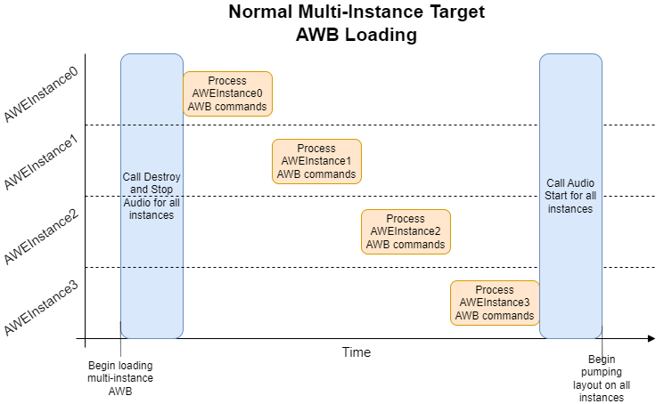

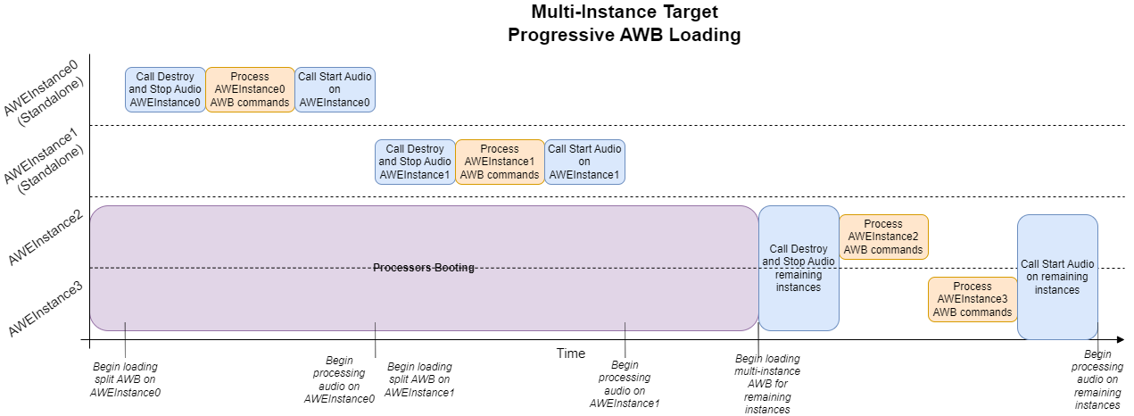

Multi-Instance Scheduling
In the multi-instance environment where instance 0 is the master with interface to audio IO peripherals, it's common to have bigger layout block size on secondary instances then the layout block size on instance 0. In this situation, it's not a good practice to signal secondary instances at the fundamental block rate. To avoid unnecessary overhead with signalling secondary instances at higher block rate, user must call awe_audioIsReadyToPumpMulti() API and if it returns TRUE then signal the secondary instance.
 if (awe_audioIsReadyToPumpMulti(&g_AWEInstance, 1))
     // Signal secondary instance to check for the pump mask, through either raise() or any other option depending on the target
  • If there are more than 1 secondary instance, call the above function in a loop and store the return status in an array. Then in another loop check the status from the array and signal the corresponding instance if the return status is TRUE. This guarantees all the instances starts at the same time. For example, if the system has 4 instances (instance 0 and 3 secondary instances), signal the secondary instance as bellow.
 INT32 pumpStatus[4] = {0};
 INT32 i;
 // First get the pump status
 for (i = 1; i < 4; i++)
     pumpStatus[i] = awe_audioIsReadyToPumpMulti(&g_AWEInstance, i);
 // Now signal the secondary instance
     if (pumpStatus[i])
         // Signal the secondary instance i
  • When this function is called with instance id 0 or invalid ID, it always returns FALSE.
Note: It is recommended to call awe_audioIsReadyToPumpMulti() just after calling awe_audioGetPumpMask() in instance 0, to keep the secondary instances pump start in align with instance 0.
    //Get the pump mask of instance 0
    layoutMask = awe_audioGetPumpMask(&g_AWEInstance);
    //Call awe_audioIsReadyToPumpMulti() to trigger secondary instances
    // Repeat for all secondary instances

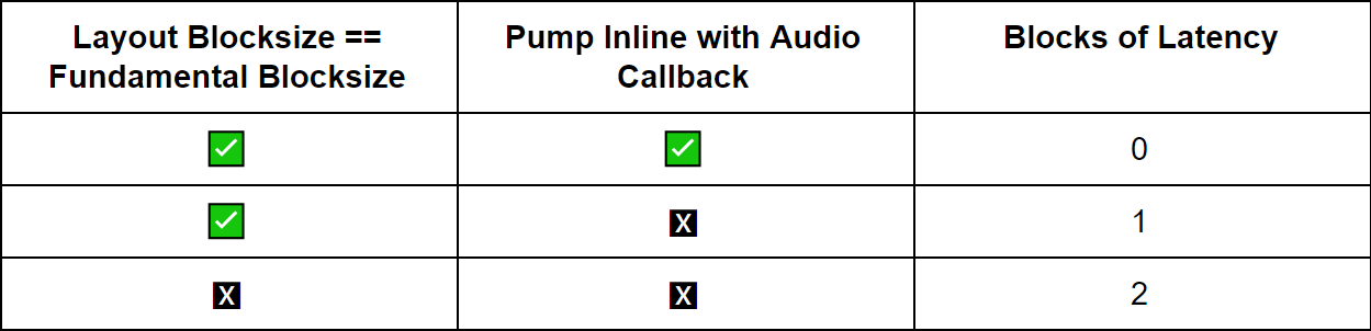

Preemption Overhead Outside of the Layout
In a multi-rate or multi-instance systems, when the low priority layout processing is preempted by high priority layout processing, the profiling overhead of the high priority layout processing is corrected by default within the AWE Core framework. To include overhead due to external events like DMA ISR, call awe_audioStartPreemption() and awe_audioEndPreemption as explained below.
  • DMA ISR without low latency audio pump:
 DMA ISR()
     UINT32 start_time;
     INT32 coreAffinity = 0;
     // For embedded targets, default core affinity is 0 in AWE Core.
     // For other targets like Linux based, get the core affinity from which this function is called.

AWE Core Scheduling and Priority
All priority and interrupt issues are managed outside of the AWE Core by the firmware integrator since the AWE Core has no knowledge of the supporting processing environment it is being integrated into. The following processing context may be implemented using interrupt handlers or using OS threads/tasks. The main requirement is that the processing context is implemented at different preemptible priority levels.
A basic Audio Weaver platform has a minimum of five priority levels of processing. From highest priority to lowest priority:
  • Priority 1: Tuning Communication I/OTask: Receives/sends data over the communication transport layer, for example RS232, USB, SPI, or Ethernet. Note: Tuning commands are not processed in this context; data is simply moved into and out of the tuning packet buffer.Action: Insert received data into the tuning packet buffer or send reply data from tuning packet buffer. When a complete packet has been received, signal the low priority idle task to process it.
  • Priority 2: Audio I/OTask: Complete audio frame has been received. Blocks of audio samples are exchanged between DMA buffers and the AWE Core input and output buffers. Action: Copy new audio samples into AWE layout input buffers copy latest AWE layout processed audio samples to output buffers if enough audio samples are available trigger Priority 3 and/or Priority 4 tasks to perform signal processing.
  • Priority 3: Audio ProcessingTask: Process one AWE layout-defined frame of audio samples. Action: At this priority level, the active signal processing layout is processed with awe_audioPump().
  • Priority 4: Lower Priority Audio Processing (multi-rate)Task: Process one larger AWE layout-defined frame of audio samples. Action: At this priority level, longer duration signal processing is initiated with awe_audioPump() but at a lower priority than the normal audio processing above.
  • Priority 5: Background ProcessingTask: In background / idle loop context, non-real-time tasks are processed. This includes the processing of tuning commands, deferred processing, and any Control Interface processing. Action:

Multi Instance Progressive Loading
In the multi-instance systems the signal flow for all instances is contained in a single AWD layout file. The AWE Core framework loads the entire AWB so that all instances load their respective layouts before calling PFID_StartAudio, which signals the system to start processing the layout. This strategy of loading all the layouts for every instance before starting processing guarantees initial synchronicity between all the AWE Instances. The diagram below shows the timing of normal loading an AWB for a Multi-Instance system.
../images/Multi-Instance-Normal-Loading-Timing.png
If the system has different boot time requirements for each instance (for example a 3 core system can have 2 cores with short boot time whereas the third core may have significantly higher boot time requirements), it's not possible to achieve these early audio requirements with a single AWB. To overcome this limitation, AWECore supports progressive loading of multiple AWB's one per instance on boot time. The AWE Core will ensure that audio remains synchronous between instances, even when loaded separately. Assigning AWE Instances as standalone only changes the timing of loading AWB’s directly on the target. The behavior of instantiating and tuning layouts over the tuning interface (like from Designer) is not changed. Following diagram shows the timing of progressive loading of multi-instance AWB.
../images/Multi-Instance-Progressive-Loading-Timing.png
Progressive loading can be applied to a multi-instance system with the following rules and constraints:
  1. A single multi-instance AWB must be split into a combination of standalone instance AWB's, where only a single instance has it's own AWB commands, and a single multi-instance AWB file with the AWB commands for the remaining non-standalone instances. All instances can be loaded standalone with individual AWB's, in which case there would be no remaining multi-instance AWB.
  2. If any instances are to be loaded in standalone mode, instance 0 must also be standalone.
  3. Standalone instances must all have a lower instanceId than the first instance included in a multi-instance AWB. That is, if instances 0 and 1 are loaded as standalone instances with individual AWB files, and instances 2 and 3 are loaded from a single multi-instance AWB, instance 4 can not also be standalone.
  4. To preserve synchronized and uninterrupted IPC, progressive loading of standalone instances must be done in sequential order of InstanceID's, beginning with instance 0, and continuing with instance 1 only when instance 0 is complete, and so on. Loading of a multi-instance AWB, if there is one, must only be done after loading all standalone instances.
  5. It is valid to not have any AWB's defined for any instances other than instance 0. That is, loading a standalone AWB on instance 0, and then a multi-instance AWB that targets only instances 2 and 3 is valid.
Splitting a multi-instance AWB into multiple AWB's to support progressive loading should never be done manually. In order to preserve synchronicity between instances, splitting a multi-instance AWB or AWS must be done using the MATLAB script split_multi_instance_layout, provided as part of Designer installs. Type help split_multi_instance_layout in MATLAB for usage information.
To enable progressive loading, call awe_setInstanceStandaloneAWBLoad() with the second argument as 1 (True) on instance 0 before loading AWB on instance 0 in standalone mode. On the remaining instances it depends on the split. If the split is into 2 AWB's, the remaining AWB can be loaded as normal from the tuning master instance. If the split is separate AWB per instance, then awe_setInstanceStandaloneAWBLoad() must be called in each instance before calling AWB loading API.
INT32 awe_setInstanceStandaloneAWBLoad(AWEInstance* pAWE, INT32 status);

while(1) { ret = awe_loadAWBfromArray(&g_AWEInstance, Inst1_2_AWB, Inst1_2_AWB_Len, &pos);
// If the previous instance not started, awe_loadAWBfromArray() returns E_MULTI_INSTANCE_SPLIT_AWB_NOT_STARTED error code. Call AWB loading function in a loop until error code is not E_MULTI_INSTANCE_SPLIT_AWB_NOT_STARTED. if (ret != E_MULTI_INSTANCE_SPLIT_AWB_NOT_STARTED) { break; } }

To achieve 0 blocks of AWE-induced latency, the following three conditions must be met:
  1. Equivalent Block Sizes: The loaded layout’s blocksize must be equivalent to the AWECore instance’s fundamental blocksize.
  2. Order of audio API calls: The order of AWECore audio processing API calls in the BSP’s audio callback must be import -> pump -> export, as in the following: awe_audioImportSamples() -> awe_audioGetPumpMask() && awe_audioPump() -> awe_audioExportSamples
  3. awe_audioPump() Inline with DMA callback: The awe_audioPump() API for layout index 0 must be called inline with the BSP’s audio callback, as opposed to signaling another thread or raising an interrupt.
../images/latencytable.png
Equivalent Block Sizes – Double Buffering
AWE Core has an internal double buffering scheme on the input and output pins to handle situations where a layout’s blocksize is a multiple of the AWEInstance’s fundamental blocksize. For example, a system with a 64 BS layout running on a 32 fundamental BS AWEInstance must complete two, 32-sample audio callbacks before actually pumping audio through the layout (to satisfy the 64 samples). Double buffering is used in this situation in order to store the next frames of data in one buffer, while the processing occurs on the data in the other buffer. Two blocks of latency are introduced by this double buffering of the input and output pins.
However, in a situation where a layout BS is the same as a fundamental BS, the double buffering scheme is not required and two blocks of latency can be avoided. AWECore has an internal mechanism to check if the layout and fundamental blocksizes are equivalent at layout runtime, and will automatically bypass the double buffering to eliminate the introduced latency. Less memory is also consumed under this condition as only a single buffer can be used at the input and output pins.

Pump Inline with Callback – Pump Context
Virtually all systems that integrate the AWE Core will use a thread signaling or interrupt raising scheme to trigger awe_audioPump in separate, lower priority contexts from the main DMA audio callback. While this scheme is required in order to allow for efficient, multi-rate operation of signal processing layouts, it does mean that the processing of the audio signal will not be complete by the end of the audio callback, As mentioned in the section above, a system with 0 blocks of AWECore induced latency must complete all audio processing within the context of the main DMA audio callback. So in order to achieve minimal latency, the first sublayout (layout index 0) must be executed in place during the audio callback, not in a lower priority context.
The first sublayout consumes the input pin and fills the output pin, so it is only this layout that needs to be processed in place. Other non low latency paths (clockdivided sublayouts, layout index > 0) should still be signaled by the callback and pumped in another context.
