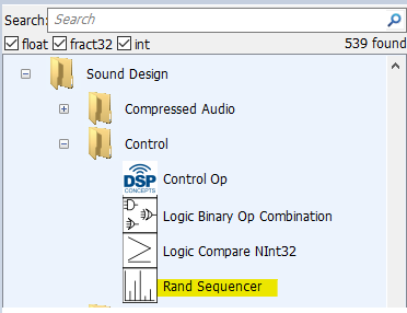

The Rand Sequencer Module
The Rand Sequencer module can be found in the Sound Design/Control folder or by using the search window in the module browser. It is called “Rand Sequencer”.
Figure 1. Location in Module Browser

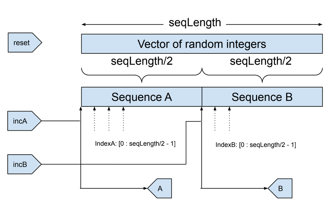

How it works
Upon reset, a vector of random integers is generated and divided into two halves. Individual increment inputs step through each half independently and the selected values are output on pins A and B.
Figure 3. Block diagram
The random vector is regenerated when:
  • Layout starts running with reset pin high
  • Reset pin goes high
  • IndexA or IndexB is incremented from (seqLength/2 - 1)
The vector contains seqLength random integers between the value of 0 and (seqLength - 1).
Note: Depending on the CPU, there may be duplicate values in the vector.
Internal variables IndexA and IndexB are incremented by the incA and incB inputs, respectively. The individual indices are used to read the entry from the corresponding sequence and present it at the corresponding output. When either index is incremented from (seqLength/2 - 1), IndexA and IndexB are both reset to 0 and the random vector is regenerated.

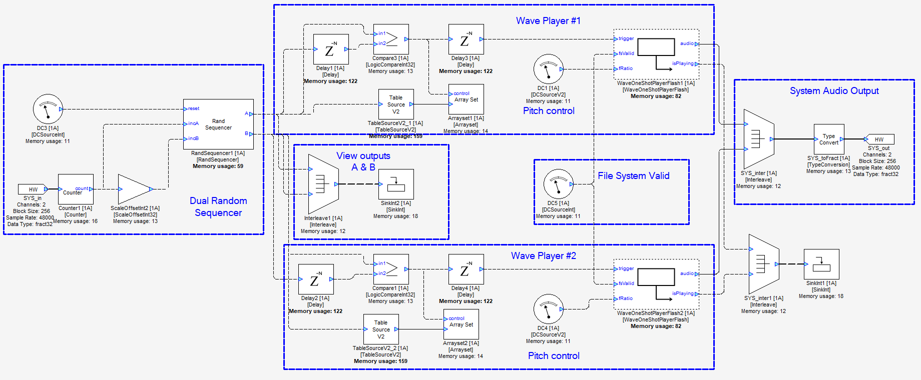

Overall Design
The sample layout includes two One Shot Wave Players, trigger generation logic, and the Rand Sequencer. The included set of wave files are the words “one”, “two”, “three” and so on, so what you will hear from the left and right channels corresponds to the values of outputs A and B respectively.
Figure 4. Sample layout

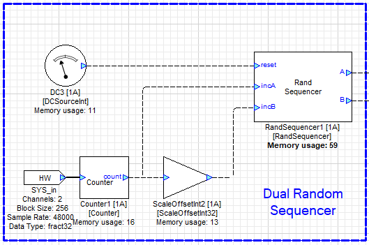

Dual Random Sequencer
Figure 5. Dual Random Sequencer and Clock
Attaching the DC3 module to the Rand Sequencer’s reset pin automatically resets the module, generating a new random output vector, when the layout starts running. Set DC3’s value to 1.
Figure 6. DC3 Properties
Module Counter1 delivers a constant rate square wave signal to incA. The period should be chosen to be longer than the longest WAV file that you intend to play.
Figure 7. Counter1 properties
ScaleOffset2 inverts the signal so that incA and incB are being clocked on alternate edges of the square wave.
Figure 8. ScaleOffsetInt2 Properties

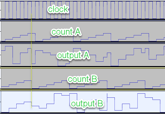

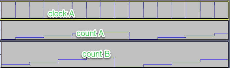

Count A and count B in the graph below are the internal counter state of the Rand Sequencer, not its outputs. Since incB is high at initialization time, count B immediately increments to 1.
Figure 9. Clock and internal counters
This graph lines up the random outputs against the clock and internal counter states. Note several things:
  • When the layout starts, the output state for both outputs A and B cannot be determined. Because it’s a random number generator, the output pattern can’t be predicted either. This document shows one possible example.
  • Count B starts at one.
  • If either counter increments from (seqLength/2), the entire random sequence resets and both outputs (can) change. Count B is ahead of count A in this design and so resets the sequence.
  • Output A (can) reset halfway through its normal cycle, driven by count B’s overflow.
  • The reason for including “(can)” in the sentences above is that it is possible that the next random sequence may have the same value in the initial positions as was there immediately prior to the reset.
Figure 10. Clock, internal counters, and random outputs

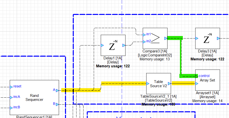

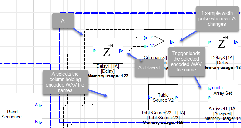

Trigger Generator
Figure 11. Trigger Generator
The Rand Sequencer’s output A is routed to a 1-sample delay. Output A and the delayed output are then compared. This results in a 1-sample wide pulse every time A changes.
Because these are control signals (indicated by the dotted lines connecting modules), they are set to a block size of 1. Turn on Wire Info and Accumulated Delay under the “View” menu to see the details.
Figure 12. Generating a trigger when the output changes
This will create a trigger pulse that is 1 block in length (due to the Block Size being 1 sample and the delay setting also equal to one sample). The Block Time is set by the input pin, which is 256 samples (Block Size) / 48000 (Sample Rate) = 5.333 milliseconds. This corresponds to a Block Frequency of 187.5 Hz.

Wave File Selector
Figure 15. Setting the WAV file name
The 1-sample width pulse coming out of the comparator loads the selected encoded WAV file name from the TableSourceV2 into WavePlayerOneshotFlash1’s fileName variable.
Figure 16. Arrayset1 Properties

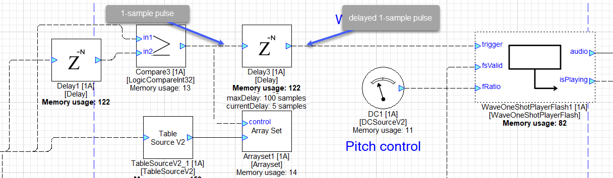

Delayed Trigger to Wave Player
When the fileName of the WaveOneShotPlayerFlash1 module is updated by the ArraySet1 module, a delay is required before you can reliably trigger the new WAV file. The amount of delay depends on:
  • Platform – CPU speed, memory access specs
  • System load – multithreaded design defers lower priority tasks such as file loading
  • WAV file – longer files take longer to load
Figure 17. Delaying the trigger
This delay was set to 5 samples on a test Windows machine using the short WAV files provided in the sample. When the delay was set to 1 sample, playback fails intermittently. The delay time will need to be adjusted on your target system.

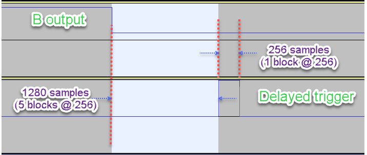

The waveforms below show the RandSequencer’s B output changing, followed by the delayed trigger pulse to the WavePlayerOneShotFlash.
Figure 18. Timing Diagram

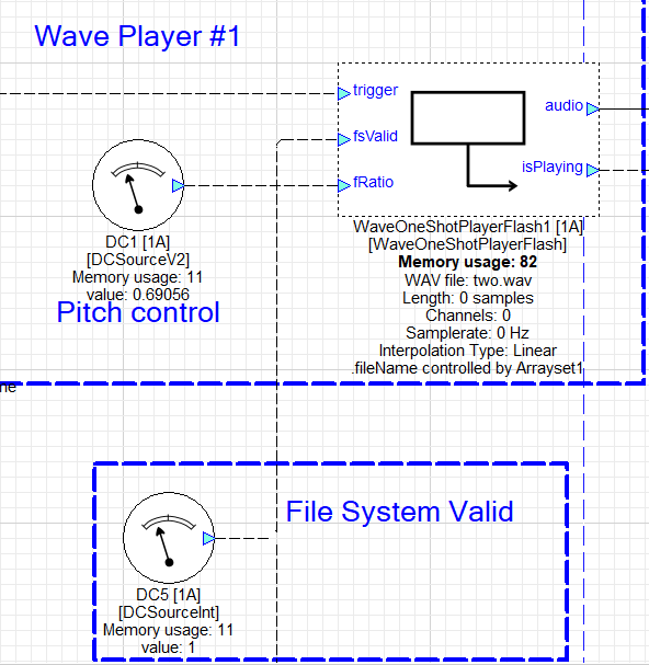

The WavePlayerOneShotFlash module
Figure 19. WavePlayerOneShotFlash module
Pin Description
trigger Starts playback of the selected WAV file.
fsValid Indicates the file system is valid. May be delayed on some embedded platforms, in which case it is the host’s responsibility to manage this signal.
fRatio Playback pitch ratio
audio Audio output
isPlaying Optional pin to indicate that playback is in progress.

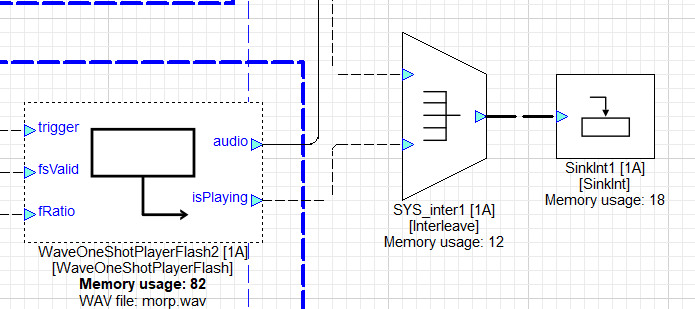

The reference layout includes an optional Sink Display so that you can visualize the state of the flags while listening to the running layout. In a real embedded system, these signals could be monitored by the host for more intelligent trigger management.
Figure 20. isPlaying signal

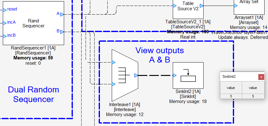

View outputs A & B
Another optional Sink Display is added so that you can watch the Rand Sequencer's A and B outputs while listening to the audio output.
Figure 21. View Outputs A & B
