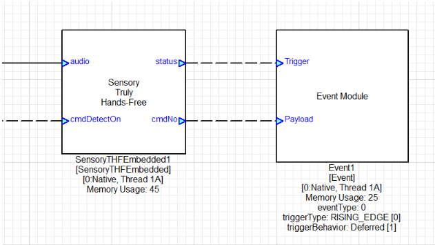

An example showing how to use the Event module to signal trigger word detection is shown below. The Event module has a Trigger pin and a Payload pin. The Payload pin can hold up to 64 samples of data.
Event Module Used With Trigger Word Figure 1. Event module used inconjunction with a trigger word module.
