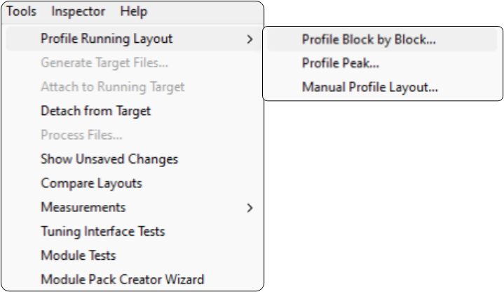

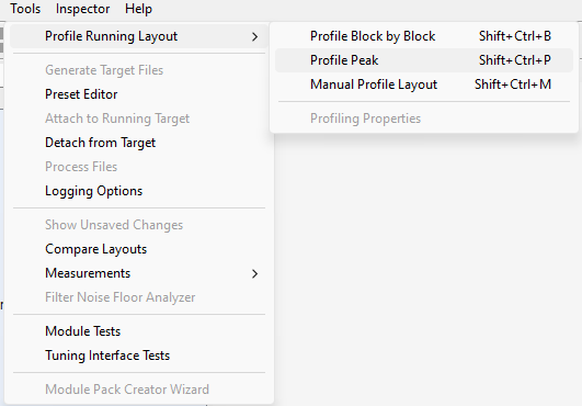

To profile a running .awd in real time, navigate to the ‘Tools > Profiling Running Layout’ menu in the Audio Weaver Designer toolbar while in Tuning Mode:
Profile Block by Block Selection
There are two options for profiling a running .awd layout in real time:
  1. Profile Block by Block
  2. Profile Peak

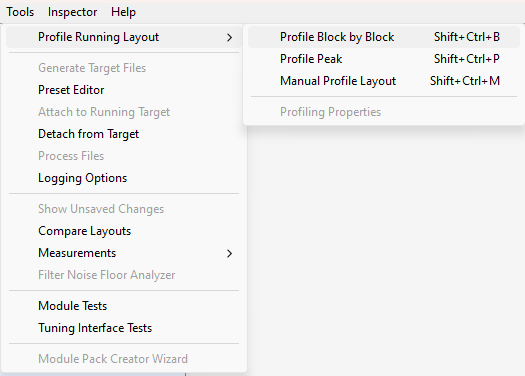

Selecting ‘Profile Block by Block’ will automatically run profiling on the entire running .awd layout at the time of selection, while ‘Profile Peak’ is manually started once the desired ‘Sampling Period’ and ‘Test Length” fields are set:

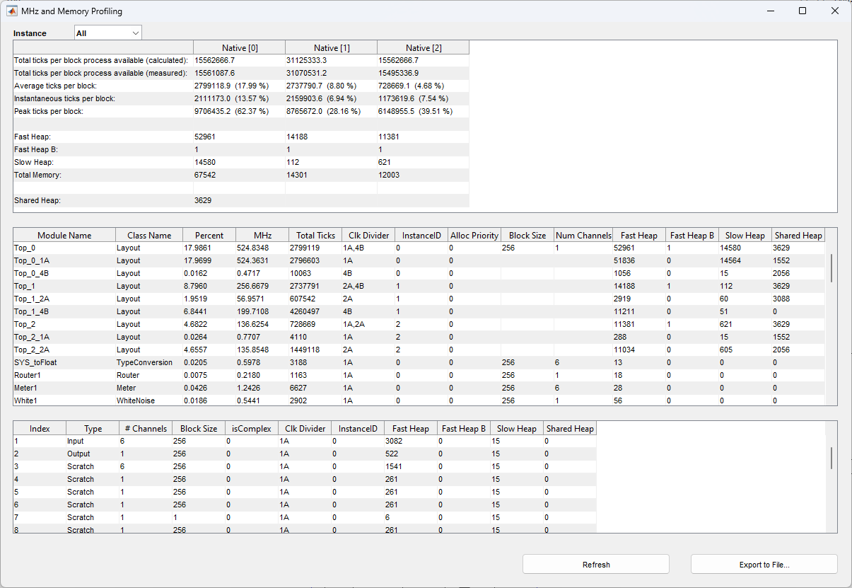

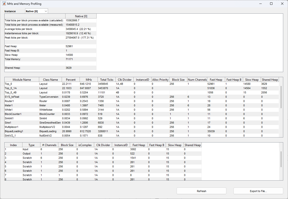

When selecting the ‘Profile Block by Block’ real time profiling option, Audio Weaver will run complete MHz and Memory profiling on the entire audio system signal flow (.awd) and display the profiling information in a pop-up window. The ‘Tick’ mentioned here is the time measured in terms of CPU clock cycles. It can be measured as Tick = (1/CPU Clock Frequency). MHz is the Million Instructions Per Second (MIPS) of the system.
Profile Block by Block Menu
In the upper right-hand corner of the profiling window provides the following information:
  • Total ticks per block process available (calculated and measured)
  • Average ticks per block
  • Instantaneous ticks per block
  • Peak ticks per block
  • Total memory usage of the system
  • Shared heap memory for multi-instance architectures
Profile Block by Block Terminology
The top table of the profiling results contains information about the target and overall profiling data for each instance included in the layout. The following table describes each field in the top section:
Field Definition Unit
Total ticks per block process available Measurement from the end of the CPU first interrupt, to the end of the next CPU interrupt (i.e., how many clock cycles have elapsed on the processor). This is a rough indication of how many clock cycles are available for processing. (You will not be able to utilize 100% of cycles because the audio interrupt handle requires some processing.) This is an especially important number to check when you are bringing up new hardware. The value shown here should be close to: (Processor Speed) x (Block Size of Processing) / (Sample Rate) If this doesn’t match, then there could be a mismatch in your processor speed, the audio sample rate, or the underlying “fundamental block size” of your implementation. Lastly, there are two separate line items for ‘Total ticks per block process available’: Calculated: Manually calculated based on the processor clock speed and the block size and sample rate of the layout; Measured: Processor clock ticks measured between blocks, based on the calling rate of the audio pump. Both of these units should nearly match, however be aware that if there are CPU overflows (>100% processing load), the ‘Measured’ metric will be doubled. In this scenario, since the audio pump is not completed during the current block of processing, the measured metric would include the next block as well. CPU clock cycles
Average ticks per block used Average of CPU clock cycles per block of audio data (10x) CPU clock cycles
Instantaneous ticks per block used CPU clock cycles required to process the last block of audio. This is the instantaneous measurement without smoothing. This number will change every time you profile. CPU clock cycles
Peak ticks per block used Peak instantaneous CPU clock cycles consumed when processing a block of audio data. This is a “sticky measurement” and shows the peak value since system startup. If you reprofile, then it will reset this value. CPU clock cycles
Fast Heap Memory usage from the memory allocated in the Fast Heap Words
Fast Heap B Memory usage from the memory allocated in the Fast Heap B Words
Slow Heap Memory usage from the memory allocated in the Slow Heap Words
Total Memory Fast Heap + Fast Heap B + Slow Heap Words
Shared Heap Memory usage from the allocated Shared Heap (Multi-Instance targets only) Words
Heaps: At initialization time, memory to be used by the AWE Core instance for signal processing is allocated. The AWE Core refers to this memory as the heap. By default, AWE Core supports four heaps for which the BSP is responsible for allocating storage. Most commonly, heaps are allocated statically as large arrays and are always measured in terms of 32-bit words. The heaps are:
  • FASTA: Typically the most efficiently accessed memory on the target
  • FASTB: A secondary bank of fast storage. Useful for memory that can be concurrently accessed with FASTA heaps
  • SLOW: Least efficiently accessed memory on the target. Often external memory.
  • SHARED: Storage shared by and accessible to multiple Audio Weaver instances, (Multi-Instance only)
To calculate Memory in MB: ((Total Heap Memory) * 4)/1000000

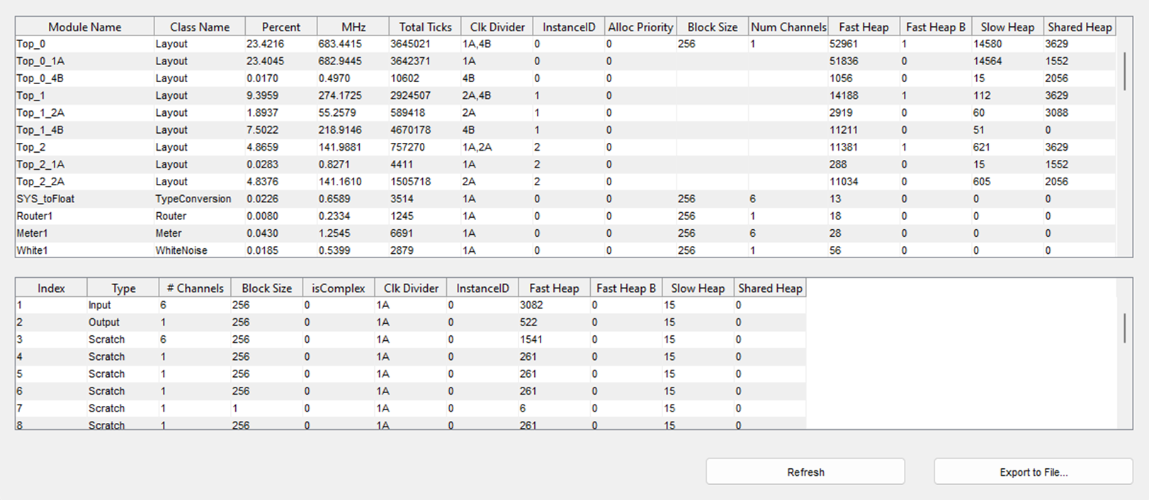

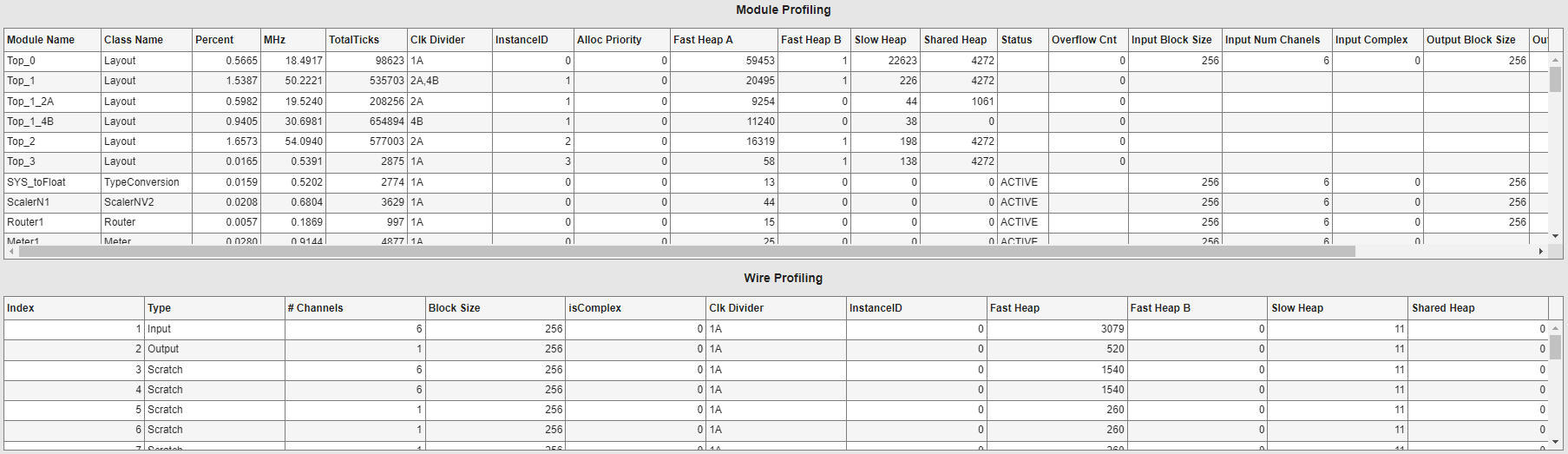

The rest of the profiling window provides profiling information for each individual module and wire (audio buffer) in the running .awd layout:
Profile Block by Block Individual Module & Wire Profiling (All Audio Weaver Instances)
Field Description
Module Name Name of the specific module in this layout.
Class Name Class to which the module belongs.
Percent Percent of the CPU load taken by this module or subsystem.
MHz Percent times the Total ticks per block process available.
Total Ticks Number of clock ticks which were measured for this module.
Clk Divider Clock dividers assigned in this module or subsystem.
InstanceID Assigned Instance ID
Alloc Priority Assigned allocation priority
Fast Heap A Allocation to Fast Heap A
Fast Heap B Allocation to Fast Heap B
Slow Heap Allocation to Slow Heap
Shared Heap Allocation to Shared Heap
Status Current status of the module (Active, Bypassed, etc.)
Overflow Cnt Number of overflow events (applies to Layout classes only)
Input Block Size Module’s input block size (empty for Source modules)
Input Num Channels Number of channels on module’s input pin
Input Complex 0 for real module input, 1 for complex input
Output Block Size Module’s output block size (empty for Sink modules)
Output Num Channels Number of channels on module’s output pin
Output Complex 0 for real module output, 1 for complex output
The ‘Top_0’ Module Name line item contains profiling information for the entire .awd layout’s processing. In a multi-instance architecture, aggregate profiling information for each discrete Audio Weaver instance is labeled as ‘Top_’. If the .awd utilizes multiple audio processing threads, aggregate profiling information for each discrete thread is labeled as ‘Top__’:

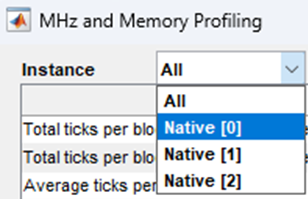

In a multi-instance architecture, the default profiling menu displays information for all of the Audio Weaver instances used in the layout:
Block by Block Processing: All AWE Instances
To display profiling information for only one specific Audio Weaver instance, you can do so by selecting the desired Audio Weaver instance from the Instance drop down menu in the upper left-hand corner:
Block by Block Profiling: AWE Instance Selection

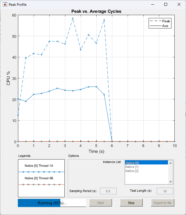

Peak Profiling

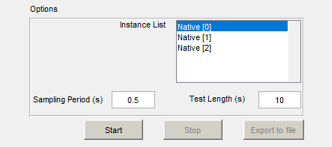

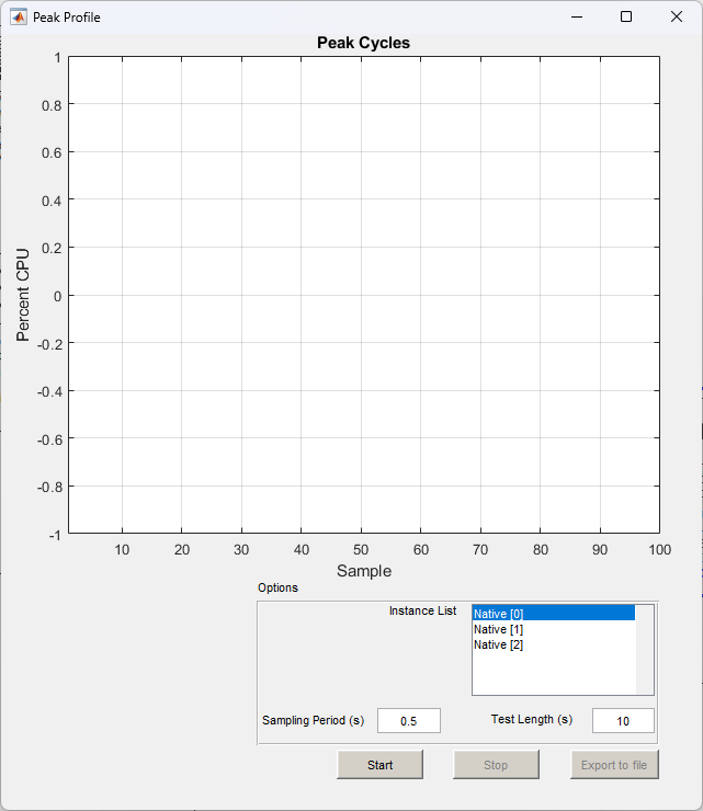

When selecting the Profile Peak real time profiling option, the Peak Profile Window will pop up:
Profile Peak Selection
Profile Peak Menu

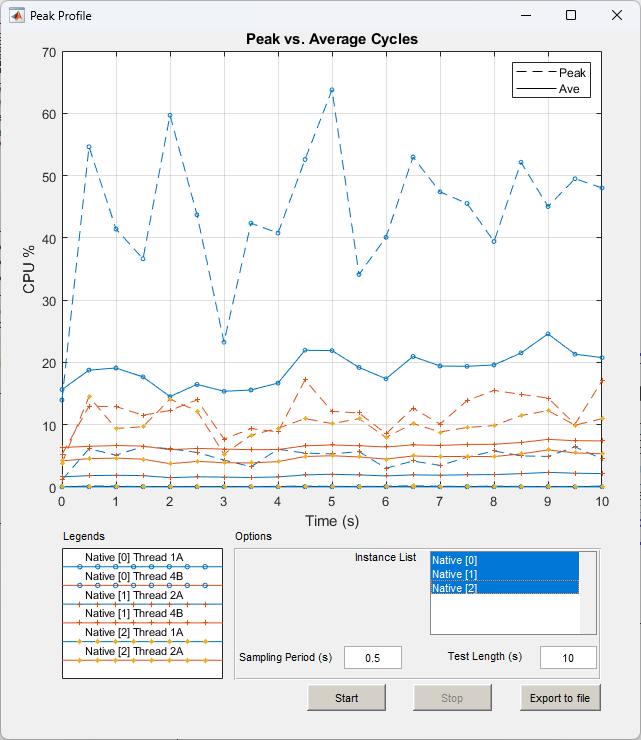

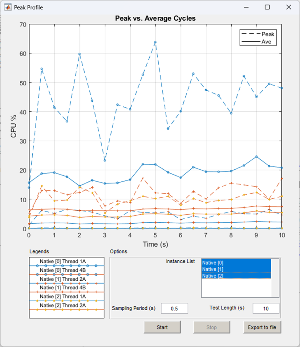

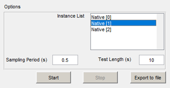

As discussed above, the ‘Sampling Period’ and ‘Test Length’ fields must be entered in order to run the peak profiling. The time unit for both fields are seconds, and the default values are 0.5s sampling period and 10s test length. When ready to start the peak profiling, simply click the ‘Start’ button.
The Peak Profile window will update in real time as the profiling is executed. You can click the Stop button at any time during the profiling, otherwise the peak profiling will complete at the end of the specified length of test:
Peak Profiling in Progress
The ‘Peak vs Average Cycles’ graph at the top of the Peak Profiling pop-up window displays peak and average CPU usage percentages of the processor Audio Weaver is running on. If the running .awd has a multi-instance architecture or contains multi-threading, multiple profiling measurements for each Audio Weaver instance and thread will also display. The x-axis is time in seconds and the y-axis is CPU percentage:
Peak Profiling
The bottom portion of the Peak Profiling pop-up window displays a Legend for the Peak vs Average Cycles line graph and an Instance List to select which Audio Weaver instance profiling measurements to display:
Peak Profiling Legend and Instance List

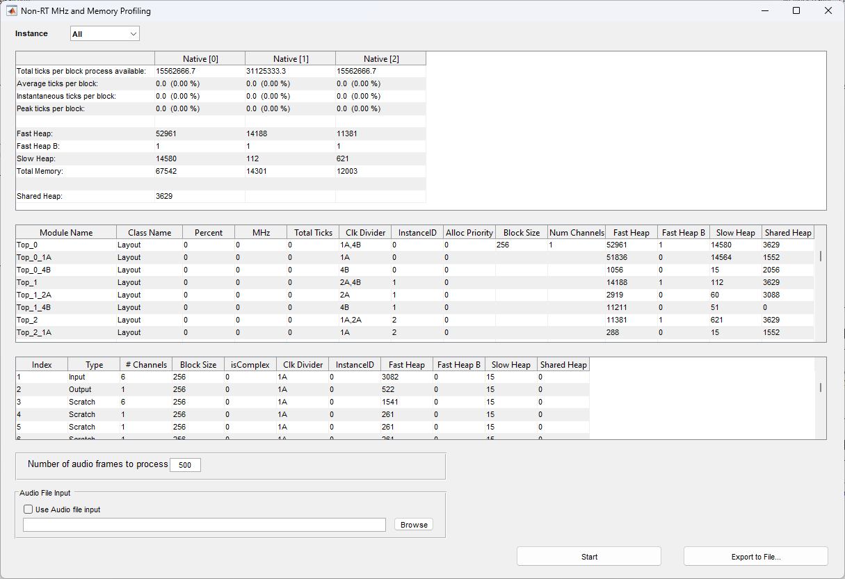

Manual Profiling
Manual Profiling

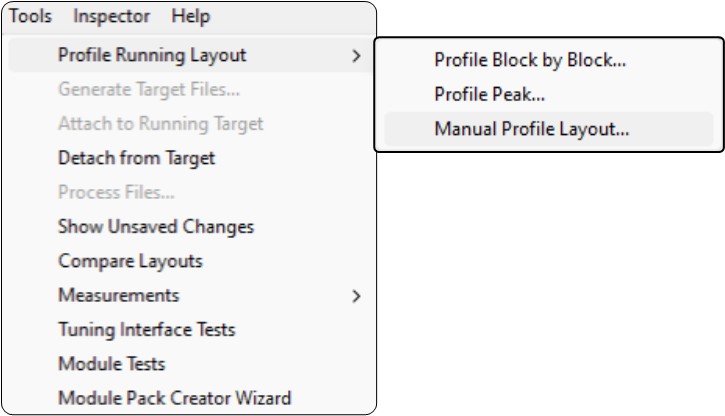

As mentioned earlier in this application note, Audio Weaver also features Manual Profiling, which collects the same exact profiling information as the real-time block by block profiling but in a different manner. Rather than profiling the runtime input audio stream, during manual profiling, real-time processing is halted on the target and all layouts present in the AWD/AWJ signal flow are processed one at a time through tuning commands (pump_layout), for the user specified amount of audio frames. The yielded profiling results may be preferred in some cases, as this decouples discrete layout processing (and thus layout thread priority) from real-time audio device interrupts. This allows for accurate profiling even in cases when the target is not configured for real-time audio, or if a layout is unable to finish executing in the allotted clock cycles (calculated total ticks per block process available).

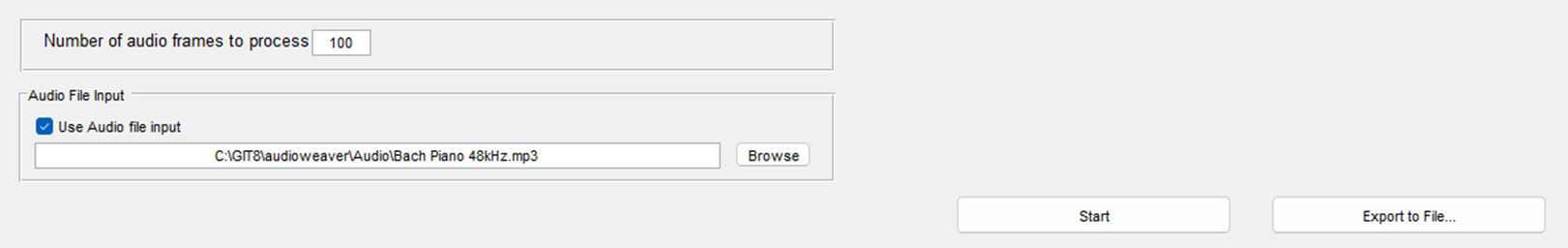

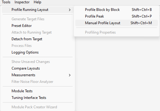

To run Manual Profile on a layout, navigate to ‘Tools > Profile Running Layout > Manual Profile Layout’ in the Audio Weaver Designer toolbar while in Tuning Mode:
Manual Profile Layout Selection
At the bottom of the Non-RT MHz and Memory Profiling pop-up window, set the Num. Pump Cycles (blocks) to process and, optionally, an audio file to be used as input audio data if running on the Native target. Num. Pump Cycles can generally be a small number like 50 and still result in stable data.
If no audio file is used as input audio data, the Manual Profiler will use audio data from the specified source selected in the Layout Properties.

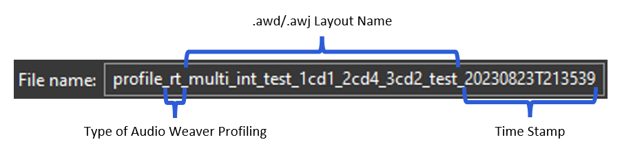

The default profiling .csv file name follows this naming convention:
Default CSV File Name

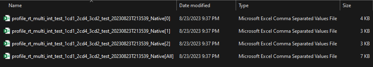

For multi-instance architectures, every Audio Weaver profiling utility enables users to export either profiling data for all instances or individual profiling data for a selected Audio Weaver instance:
Block by Block and Manual Profiling – Instance Export Option
Peak Profiling – Instance Export Options
For block by block and manual profiling of multi-instance architectures, if profiling data for all instances are selected for export, Audio Weaver will generate one aggregate profiling CSV file and individual CSV files for each Audio Weaver instance in the system:
CSV Export for All Audio Weaver Instances

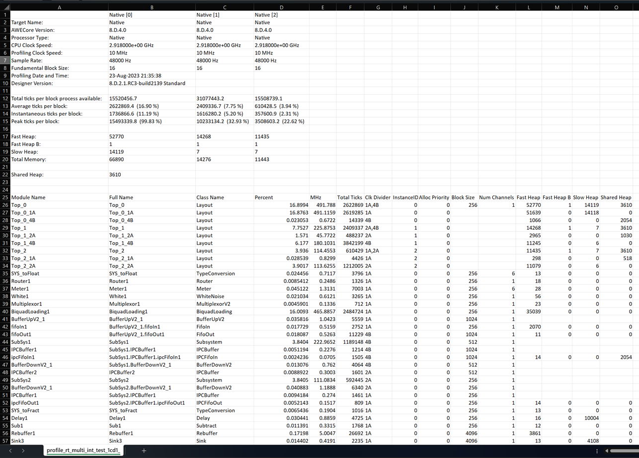

Once exported and saved, users can open the .csv file in Microsoft Excel or equivalent.
The exported block by block and manual profiling .csv files are structured identically to their pop-up windows in Audio Weaver:
Block by Block and Manual Profiling - Exported CSV

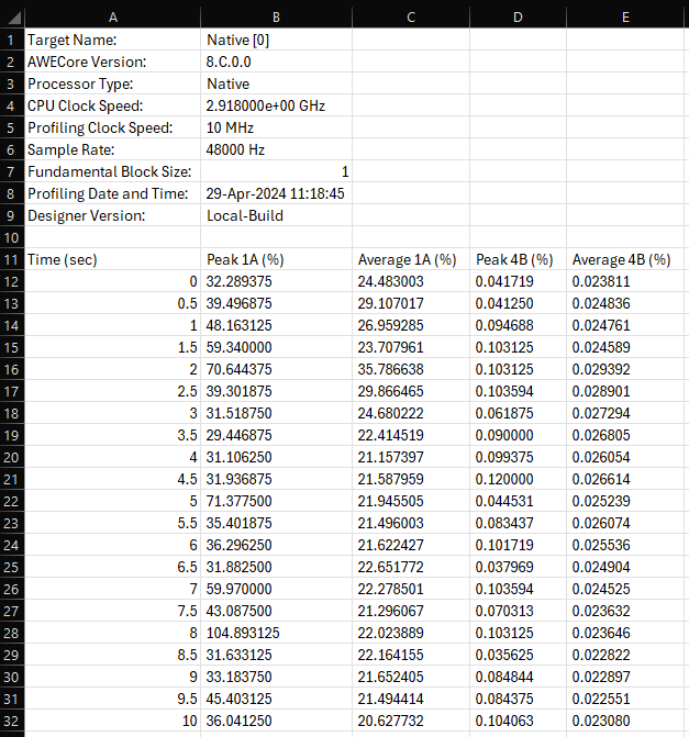

The Profile Peak .csv file is structured as followed, where the Peak and Average Cycle CPU% profile values are indexed by the specified time period in seconds:
Profile Peak Exported CSV

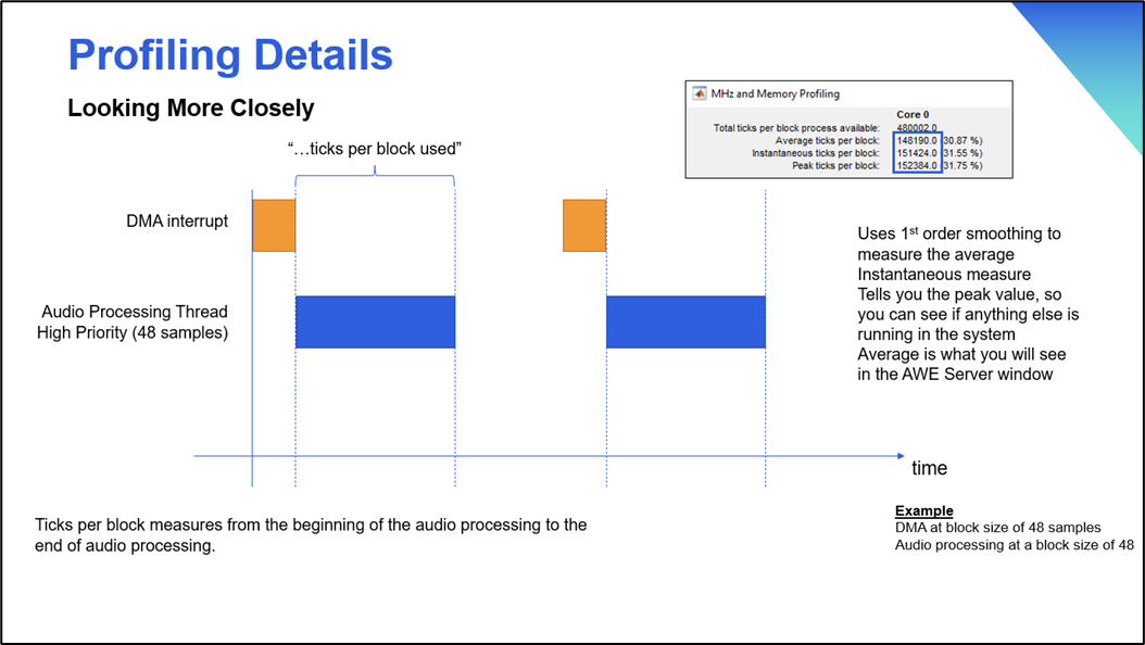

Profiling Diagrams
Below are some diagrams that further illustrate the real time profiling function in Audio Weaver.
Profiling Details: Single Threaded Profiling
Profiling Details: Total ticks Per Block Process Available
Profiling Details: Ticker Per Block

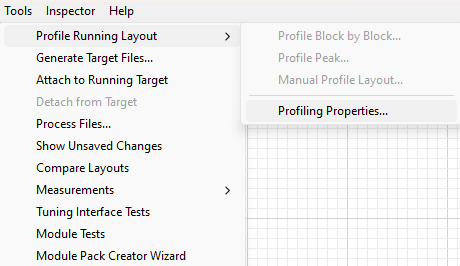

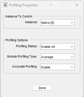

Profiling Properties
The Profiling Properties menu is available during design time from the Tools → Profiling Running Layout → Profiling Properties menu.
Profiling Properties Menu
This menu lets the user control the profiling options being used on the target system. The profiling options can be applied to each instance on the target independently using the Instance To Control dropdown. The options shown when the menu launches are queried from the currently attached target, so they represent the current state of the target's profiling. The target can control these options using the AWE Core APIs awe_setProfilingStatus and awe_setProfilingOptions.
The details of each controllable profiling option are discussed below.
Profiling Status
The profiling status dropdown has 4 options for enabling and disabling certain profiling modes.
The two modes that can be controlled are module and layout . Module profiling enables the collection of profiling information on the target for each module in the layout. Layout profiling controls the collection of profiling information for the layouts running on the target. These profiling results are what is shown in the profiling tools discussed in the previous sections; disabling either of these profiling modes will impact what the profiling tools can show. The 4 options are:
  1. Disable All: disables both layout and module profiling. No information will be available in the profiling tools in Designer. The profiling overhead on that target will be minimized, but can not be measured.
  2. Enable All: enables both layout and module profiling. The Designer profiling tools will have complete data, but the overhead on the target could be significant. This is the default value for unmodified systems.
  3. Enable Module Only: enables module level profiling and disables layout profiling. The Peak Profiling tool will not be able to return useful values when using this option. Module level profiling provides the most detailed information, but is the most computationally expensive part of profiling. This setting is not commonly used, since disabling only layout profiling sacrifices the highest level profiling information and does not reduce CPU load significantly.
  4. Enable Layout Only: enables layout level profiling and disables module profiling. The Block-By-Block and Manual Profiling tools will not be able to show detailed module profiling when this option is selected. This setting can be useful to determine the overall CPU load of the layout without the computational load of module profiling. Comparing the overall layout load of this setting to Enable All will show the overall computational cost of collecting module level profiling information. On some systems this is a trivial cost, but on other systems it can be significant. Using this option can provide more processing margin for the layout at the expense of profiling observability.

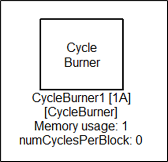

CycleBurner Module
The CycleBurner intentionally consumes a user-specified number of clock cycles (cycles are at the rate of the target’s Profile clock rate displayed in AWE_Server). You can increase the number of clock cycles used by CycleBurner by adjusting the ‘numCyclesPerBlock’ slider of CycleBurner’s inspector. Using this technique we can increase the number of cycles until we start to hear distortion in the program material that is being processed by the signal flow.
CycleBurner Module
Since the CycleBurner relies on a specified number of cycles to elapse to finish processing, systems with multiple threads running can cause inconsistent CPU loading when using this module. For example, if the thread running the CycleBurner, set to consume 10,000 cycles, is preempted by another thread for 6,000 cycles, the CycleBurner itself will only process for 4,000 cycles. The FIR and Biquad Loading modules described below can provide more predictable CPU loading in multi-threaded systems.

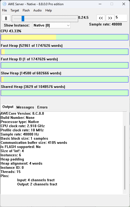

Audio Weaver Server Profiling
While an .awd is running in Audio Weaver, the Audio Weaver Server provides real time CPU and Memory profiling of the entire layout:
Server Profiling on Multi-CPU Targets
AWE Core may be running in multiple threads on several CPUs in some instances. The application is not aware of which CPU the thread is running on by default. This means that without some extra work, the default display of CPU % cannot be trusted for multi CPU targets as the assumption will be that all threads run on a single CPU.
If CPU affinities are enabled on the target, server will display text percentages for each CPU that a layout is running on. The CPU percentage indicator bar will show the load for the CPU which has the highest load. Any CPUs without an associated layout will not be shown.
Setting and getting CPU affinities is done through the AWE Core functions awe_fwSetLayoutCoreAffinity and awe_fwGetLayoutCoreAffinity. These functions are described in the AWE Core API documentation. Customers utilizing AWE Core OS have this feature built in as described here.
