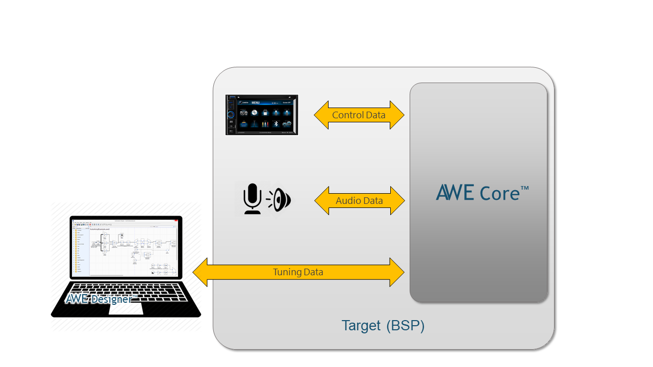

Data Interfaces
AWECore exchanges three types of data; Audio, Tuning, and Control.
Audio data Audio data is processed by the AWE Core OS signal processing engine.
Tuning data dynamically configures or polls the signal-processing, including the topology of the modules and the tuning parameters for each, such as filter coefficients or channel gain. This data is in the form of commands, typically issued by Audio Weaver Designer™ (or 3rd party tools / scripts).
Control data consists of parameters exchanged between firmware components and the Audio Weaver signal processing logic. This data can be used to, for example, light an LED if the audio level passes a certain threshold.

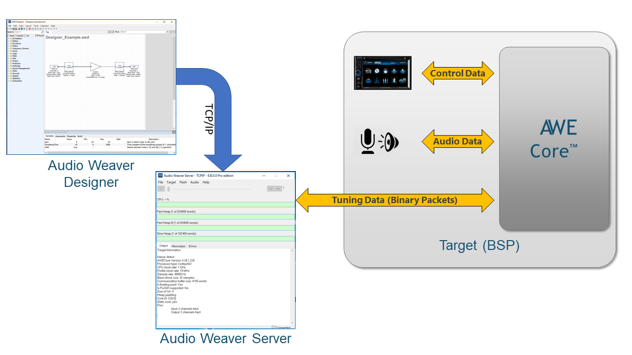

Design-Time Operation
When using AWE Designer to create and tune a signal processing layout, tuning commands (and the resulting replies) are exchanged between the PC and the AWE Core OS running on the target hardware. The full path that these tuning commands travel is shown below.
Communication between Designer and Server uses plain text commands. AWE Server then converts each text command into a binary packet and sends it to the target platform over the specified tuning transport (e.g. Ethernet, USB, RS232, etc.). Scripts containing the text commands are called Audio Weaver Scripts (AWS). Scripts containing the binary commands are called Audio Weaver Binary (AWB) scripts.
For a more detailed description of our Tuning Protocol and the AWB command structure, please see the Tuning Protocol document here. Also review the built-in TCP/IP based tuning interface here: aweOS_tuningSocketOpen
Note that this command protocol is strictly initiated by the host (typically AWE Server). The host issues a command and will not issue another command until the original command is complete or times out. The firmware can never issue a command. It can only respond with a single reply to the current command.

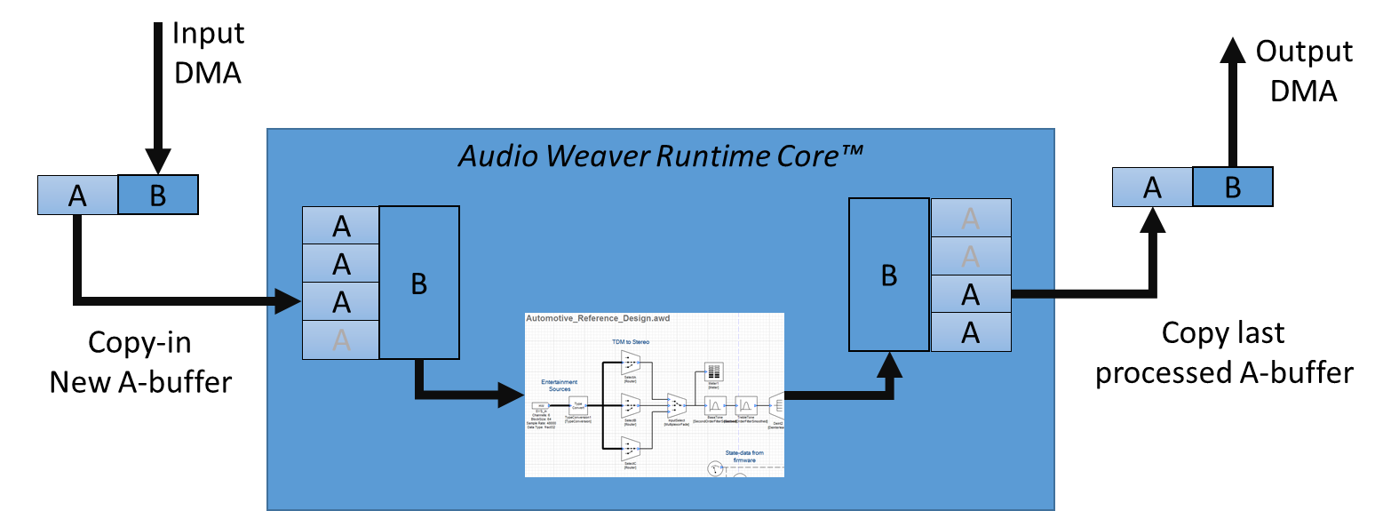

Audio-Processing Model
Block Processing
As audio samples are received by calls to aweOS_audioImportSamples, they are buffered into blocks. These blocks of audio samples are then copied into the AWE Core OS system where they are processed.
A fundamental concept for AWE Core OS is that the layout signal processing block size can differ from the fundamental block size. For example, the audio device may be configured for a block size of 32 samples, while a signal processing layout may use a block size of 64, 96, 256, etc. The only limitation is that the layout block size must be an integer multiple of the DMA block size. This decoupling allows the DSP engineer to easily make tradeoffs between MIPs, memory, and latency without having to modify or rebuild the application code. As shown in Figure 13, the AWE Core OS system has internal buffering to automatically handle this decoupling. In the example in Figure 3, the signal processing layout operates on blocks 4x the fundamental block-size.
The following steps illustrate the audio processing.
- When an audio frame is received it is copied from the receive buffers to the input buffers of the AWE Core layout.
- Likewise, since input and output are synchronous, newly processed audio is copied from the AWE Core layout output buffers to the hardware output buffers.
- When the number of audio frames accumulated matches the number of audio frames needed by the layout, the layout is processed.
