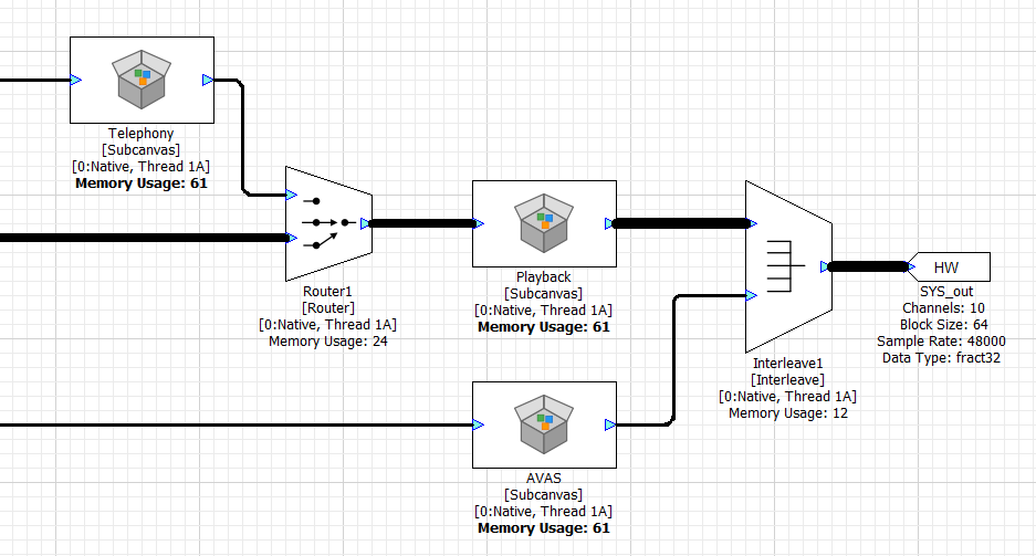

An example PSF containing 3 Subcanvases is shown below:

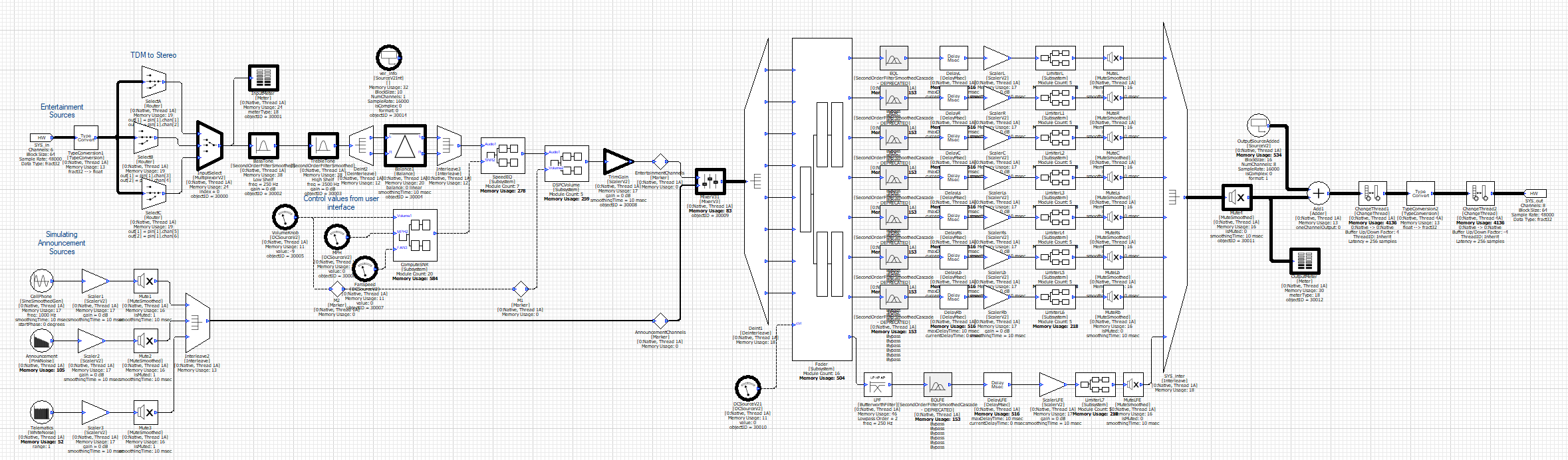

Inside each Subcanvas is an entire AWD. For example, the Playback Subcanvas could contain:
AutoAmp_Example.awd

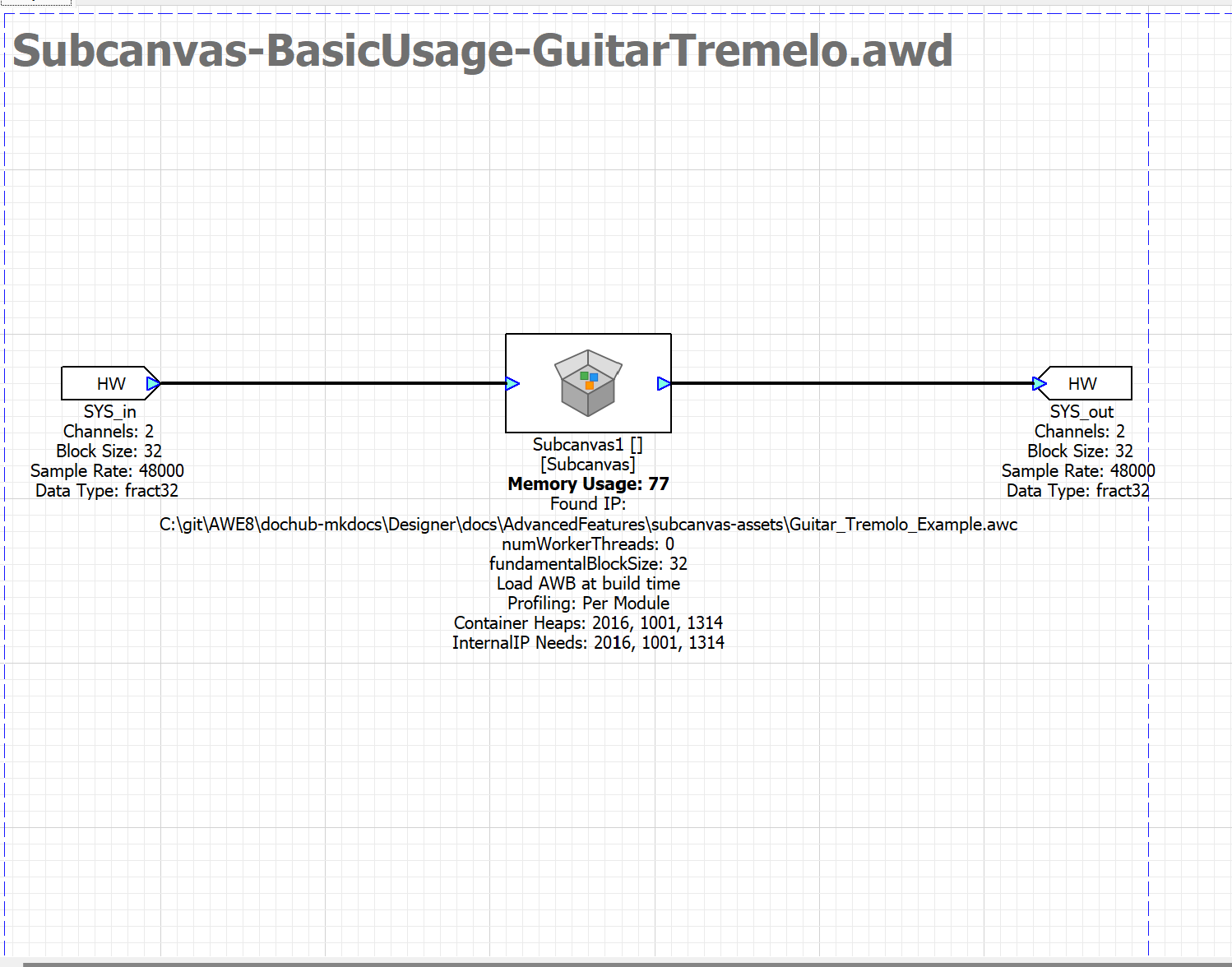

  2. Use the Subcanvas within a Parent Signal Flow
    1. Open another layout in Designer, this will be the PSF.
    2. Drag out a Subcanvas module and wire it in to the PSF. Note: subcanvas IO only supports fract32
    3. In the Subcanvas module's awc file argument, select the Guitar_Tremelo_Example.awc file that you generated in step 1.

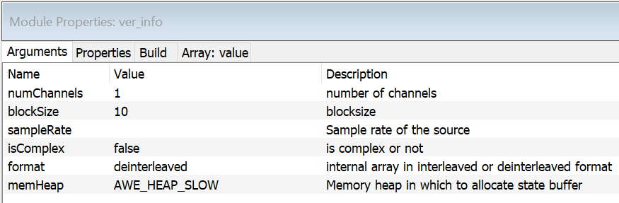

If you want to include version information in the Subcanvas AWB, add a SourceV2Int module configured for 1 channel and a block size of 10 samples. Place the module at the top level of the layout, name it “ver_info”, and assign an objectID. Any objectID is OK.
When generating a Subcanvas AWC file, the values entered in the Version Info field are populated into the first eight entries of the ver_info module. The final two entries contain the build date and build time.
Including a ver_info module allows you to validate the version of the AWB that is actually running inside the Subcanvas module. If no ver_info module is included, the version information reported by the Subcanvas module is taken from the AWC file. While this often corresponds to the currently loaded AWB, it is not guaranteed.
A common use case for a Subcanvas is to create it with an Empty layout and have the target system load the required AWB at runtime. In this scenario, the system may destroy and replace the AWB multiple times. As long as the loaded AWB fits within the Subcanvas module’s allocated heaps and I/O dimensions, it will run correctly.
When using this approach, including a ver_info module during AWC generation is the only reliable way to determine the version of the AWB currently loaded inside the Subcanvas.

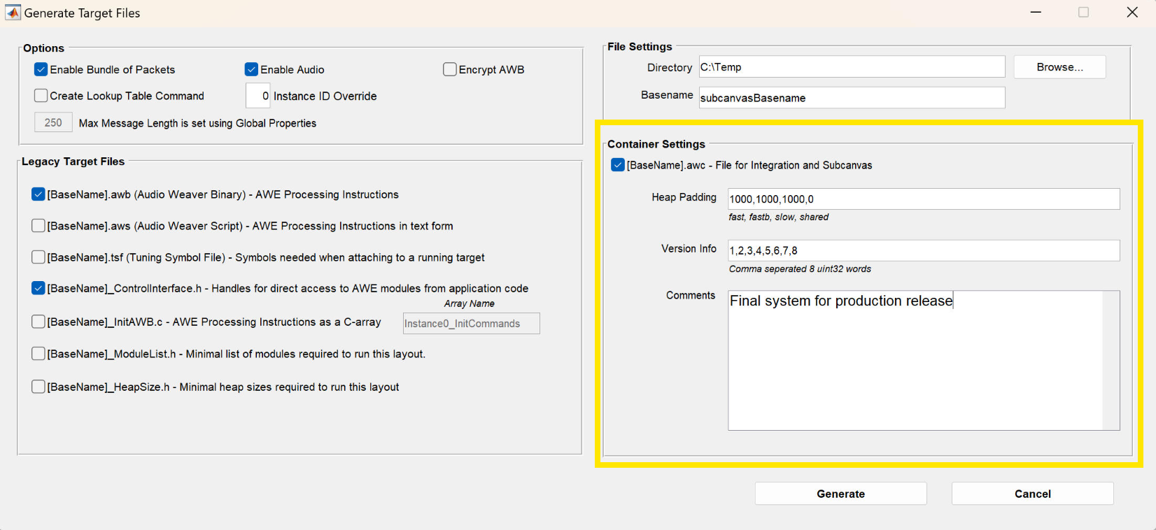

Generating Subcanvas Files
From the Tools menu, select “Generate Target Files…”. This opens up the following dialog window. The highlighted section contains configuration settings for the AWC file.
Fill in the following information:
• Heap Padding – Allows you to create heap sizes beyond what is needed for your IP. You may have to specify padding because Audio Weaver memory allocation varies slightly between Native module and the target you are deploying the IP on. In the edit box, enter a comma separated list of 4 integers: “1000,1000,1000,0”. There are 4 values and they correspond to the Fast A, Fast B, Slow, and Shared heaps. The shared heap is unused for Subcanvases so it should be left as 0 in this case.
• Version – 8 x int32 values which can be used to mark the version information of the AWC. If there is a ver_info module in the layout, this module will be populated with these 8 version values, as well as the build date and time. See the Versioning section above. These version values must be manually updated - they do not update automatically when generating the AWC file.
• Comments – Free text which is incorporated into the generated AWC file.
Other settings in this dialog window:
• Enable Bundle of Packets – Setting this to 1 causes the generated AWB in the AWC to use message bundles to speed up loading of the design. We recommend setting this to 1. See the Bundle Packets page for further details.
• Enable Audio – Enables audio after the Subcanvas is loaded. If not set, no signal will actually pass through the canvas. This is almost always checked.
• Encrypt AWB – Checkbox which indicates if the AWB in the AWC should be encrypted or not. Set this to 1 if you want to protect your IP.
• Create Lookup Table Command – This adds a command instructing the AWECore library to use a lookup table to speed up finding modules based on their objectID. Enabling uses slightly more memory but can speed up loading significantly. We recommend that you always set this to 1.
• Directory – directory in which to place the generated files
• Basename – specifies the base name of the files to generate
