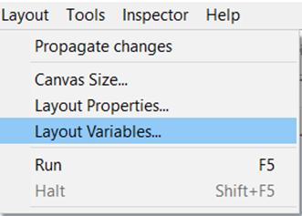

To open the Layout Variables dialog, select ‘Layout->Layout Variables’ from the Designer menu.
This will open the following dialog.

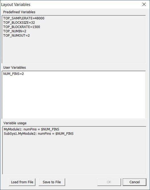

There are three sections: predefined variables, user variables, and variable usage.
Predefined Variables
The predefined variables section automatically defines symbols derived from the layout’s HW input pin. If the HW input attributes are changed, these symbol values will also change to match. The TOP convention is used in these variables to indicate that they represent the top level input and output pin values.
  • TOP_SAMPLERATE — the sample rate of the HW input pin
  • TOP_BLOCKSIZE — block size in samples of the HW input pin
  • TOP_BLOCKRATE — HW input sample rate divided by the HW input block size
  • TOP_NUMIN — HW input pin number of channels
  • TOP_NUMOUT — HW output pin number of channels
User Variables
The user variables section is where arbitrary symbols can be defined by the user. Symbols must be entered as = , one per line. Symbol names must begin with a letter. Symbol characters must be upper or lower case letters, digits, or underscore characters. No other characters or special symbols are allowed. If other text or spaces are entered they will be stripped out when the dialog is closed. For example, a user might define a symbol like “SIGNAL_NOISE_RATIO_THRESH”, and then use it in any module argument field in the layout anywhere that SNR is evaluated.
Variable Usage
The variable usage section shows which module arguments are implementing a given symbol. If a symbol is deleted from the user variables section, the user may refer to the variable usage section to find which modules relied on that symbol. The user can then manually delete/replace the symbol for each of the afflicted module arguments.

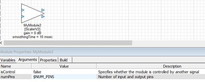

To use a layout variable precede the symbol with a ‘$’.
The $NUM_PINS symbol has been defined with a value of 2 in the user variables dialog.

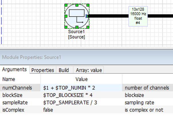

Simple arithmetic can also be used with the layout variables to define module arguments. For example, this Source module uses the predefined layout variables to specify its wire information arguments:
Note
As seen in the numChannels argument above, any expression must begin with a ‘$’, even if the first component is not a variable.
