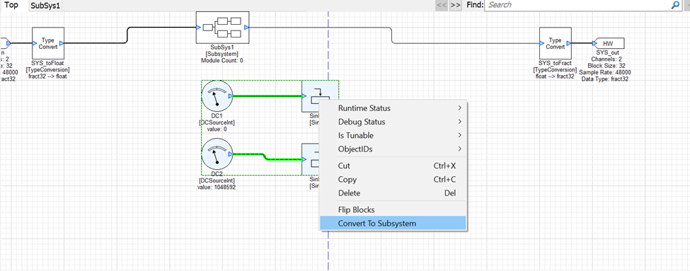

Right click on canvas
Right-click on Subsystem
Convert To Subsystem
If you are working on a layout which is starting to get crowded, you can create a subsystem from an existing group of modules. To do this, select a module or set of modules, right click, then select the Convert To Subsystem option. This replaces the selected modules with a new subsystem that contains the selected modules.

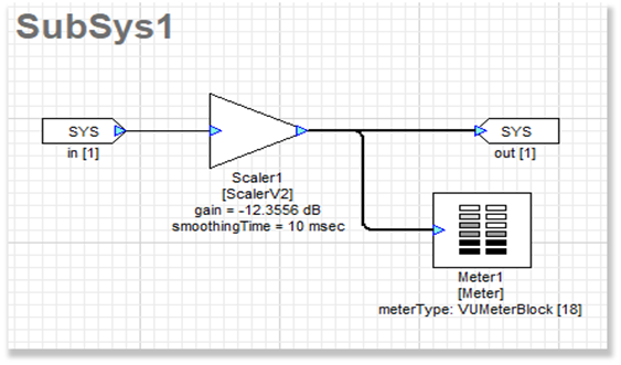

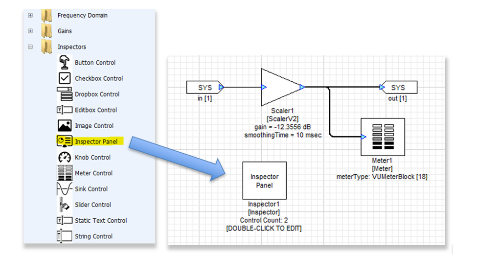

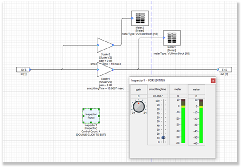

In this example, a subsystem has been created with a ScalerV2 module and a Meter module. The desire is to have a knob to control gain, and a meter to show the output level.
The scaler module and meter module are necessary to attach to the knob control and meter control. First, select “Inspector Panel” from the module palette under the “Inspectors” heading.

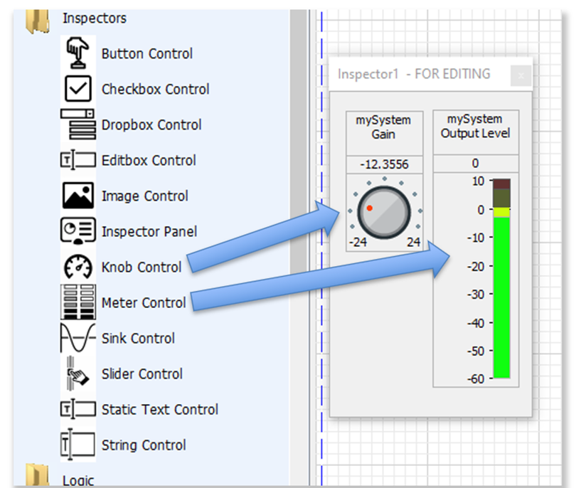

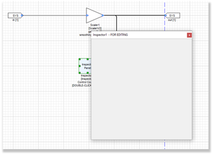

Drag the Inspector Panel onto the canvas. Double click the Inspector Panel to edit, a blank Inspector Panel will open in Edit Mode as in the following figure. Edit Mode can be used to add, delete, move or change properties of inspector controls.
Drag a knob and meter inspector control from the palette:
If the editable user mode dialog is not large enough to accommodate the default size of the control, it cannot be placed – increase the size of the Inspector Panel, then retry placement.

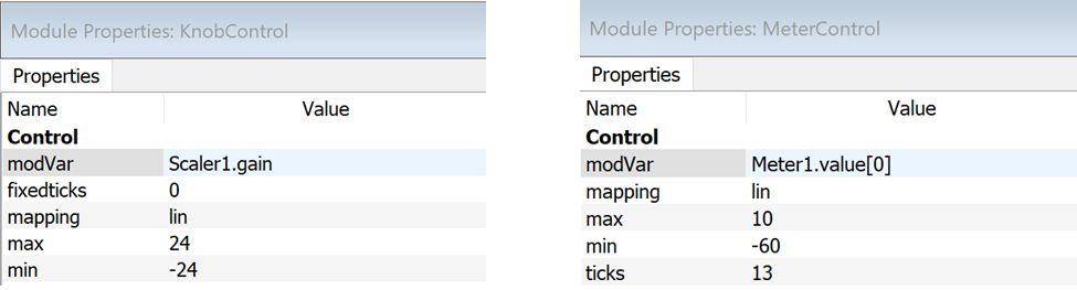

Before testing the dialog, one must attach the control to a module variable. Right click on the meter and knob controls in the Inspector Panel and click View Properties in the pop-up menu. Enter Scaler1.gain in the modVar field, and Meter1.value[0] in the modVar field of the meter. If the names of the modules were changed after placement, enter those names instead of Scaler1 and Meter1:

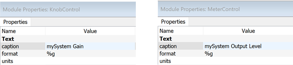

Use the caption property to change the displayed name of each control:
For more information on each inspector control and their available properties, see the descriptions in the Property panel, or right click either in the module browser or in the Inspector panel and click Help.

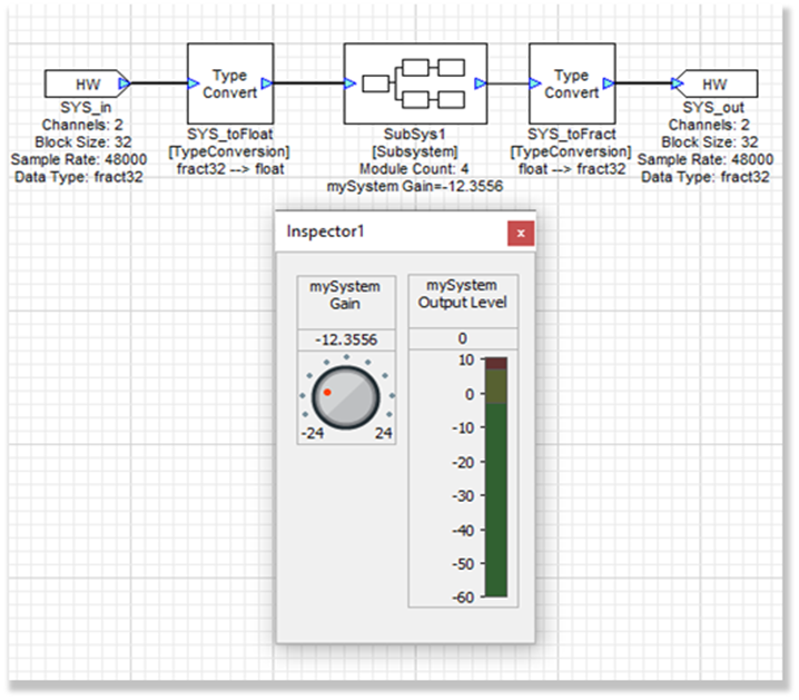

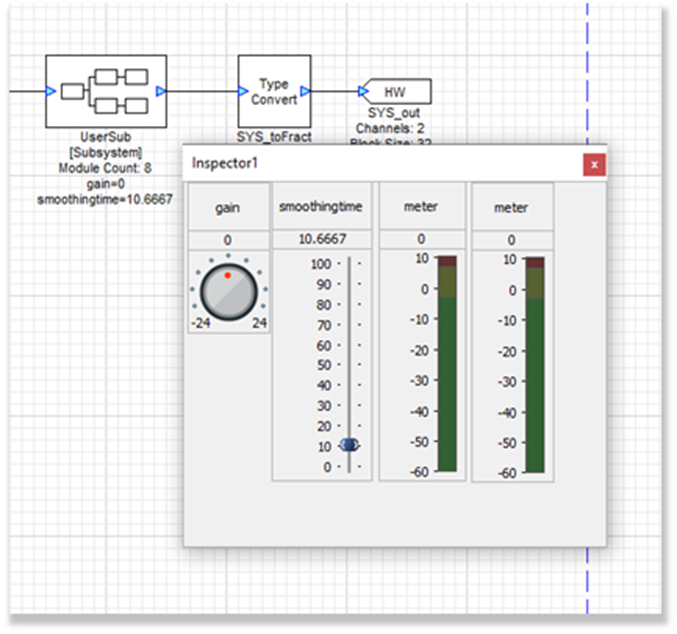

Next, ascend the hierarchy to the top level, where double clicking the subsystem will now show the inspector dialog in Control Mode. Control Mode can be used during design time or run time to change the values of the module variables linked to each inspector control. For example, the knob control will change the subsystem’s gain module variable. The subsystem module block will show updates of the values as in the next figure:

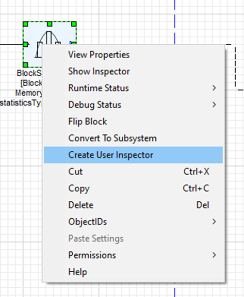

As a starting point, a user can right-click a module and select “Create User Inspector” to create a new Inspector Panel with the controls for this module.

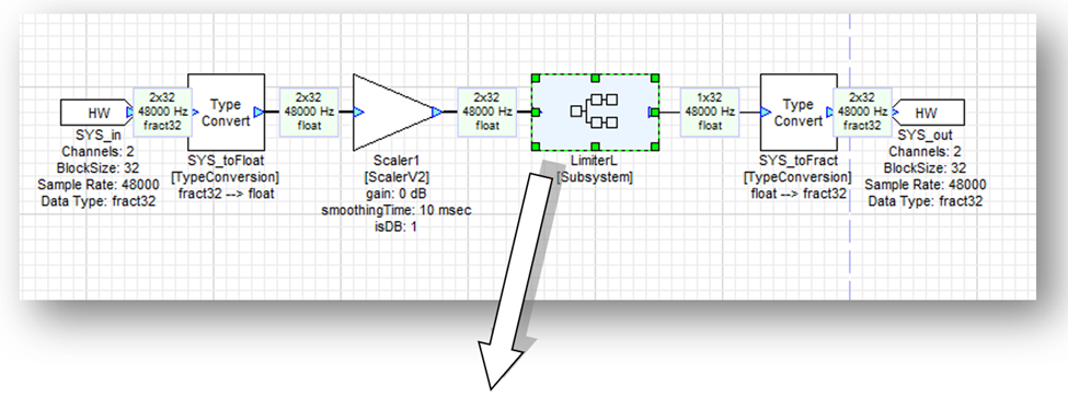

There are two ways to convert this subsystem module into a Reusable Subsystem. From the top level layout:
  • Click and drag the entire subsystem module from the canvas and to the Module Palette, either on an existing module directory or in the empty space, or
  • Right-click the subsystem module and select the “Create Reusable Subsystem” option.

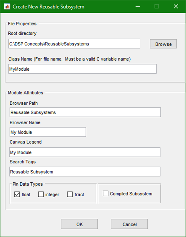

  • A new dialog window appears, titled “Create New Reusable Subsystem”, with the following entry fields (see figure below). Complete and edit these fields accordingly for this Reusable Subsystem:
    • Root Directory - root folder for the Reusable Subsystem’s generated folders/files (see Generated Folders/Files)
    • Class Name - Unique file name for the generated output files.
    • Browser Path - Category in which module will appear under in the module palette
      • If the subsystem was dragged onto an existing module directory in the Module Palette, this will be automatically populated with that existing directory name. Otherwise, this will be automatically populated with the new directory name “Reusable Subsystems”.
    • Browser Name - The name of the module that will appear in the module browser
    • C anvas Legend - The text which will appear in the reusable subsystem block when on the Canvas.
    • Search Tags - Search terms to locate this module in the Module Browser
    • Pin Data Types - Valid data types for module input pins (can select multiple types)
    • Compiled Subsystem – If checked, creates a Compiled Reusable Subsystem
Dialog box for Creating a New Reusable Subsystem
  1. Once the fields are set, click OK, and the Reusable Subsystem will be created.

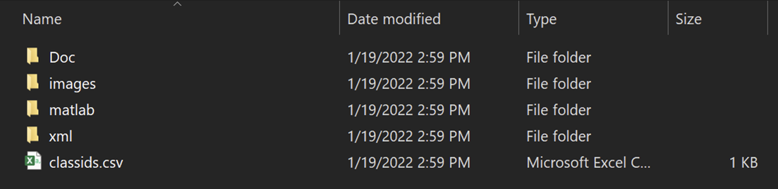

When a user clicks OK and creates a new Reusable Subsystem, Designer generates the necessary output files and folders, and adds them to the appropriate MATLAB paths. The location of this generated output depends on the Root Directory that was entered at creation time. This folder structure should not be modified by the user to ensure the Reusable Subsystem’s compatibility with Designer. See below for information about the generated output.
  • Doc
    • This folder is where HTML help documentation is located, which is an auto-generated template file that the user should update as described below:
      • Headings, formatting, names of Inspector Controls and pins will be pre-populated, but it will be up to the user to fill in other information. The template will be populated with keywords that can be replaced with the user’s desired text. These will be:

  • images
    • The default bitmap image (Default.bmp) will be used as the default Module Palette icon for all Reusable Subsystem modules. You can change this icon by either editing Default.bmp image, or by creating a new icon and updating the XML file:
      • Create a new .bmp image file for the Reusable Subsystem. Place this file in this images/ directory.

      • MATLAB
        • The .json file represents the reusable subsystem in a text file format, used for construction
        • (Compiled Reusable Subsystems only) The .awb file contains the compiled reusable subsystem in an encrypted binary format
        • (Compiled Reusable Subsystems only) The .meta file contains definitions of any controlled module variables (eg. custom ObjectIDs, User Inspector Controls) within the subsystem
  • xml
    • The xml layout of the module used by Designer GUI. This is auto-generated and should not be modified , except when adding user-contributed images for the Reusable Subsystem.
    • Any manual edits to the XML files will not be preserved when making updates and overwriting a Reusable Subsystem (see Modifying a Reusable Subsystem and Overwriting).
