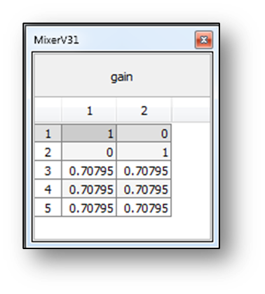

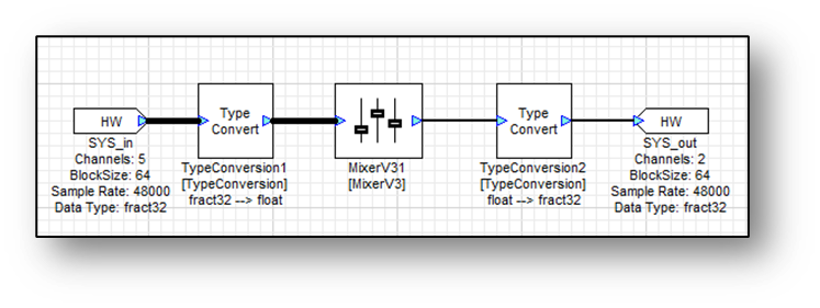

A Mixer is an M x N array of gains that transform M input channels into N output channels. This is useful for combining signals together, and consolidating many gain values into a single module. Our Mixer module is smoothed, and optimized based on the amount of non-zero coefficients specified by the user. It supports input pin controls or single pin, multi-channel controls. A mixer is good for handling many channels at once, so it excels in the algorithm for downmixing from surround sound 5.1 to stereo. This means transforming 5 input channels to 2 output channels:
The Mixer module holds a matrix representing the downmix equations, which are shown in its inspector (in linear units):
Lt = L + -3dBC + -3dB(-Ls -Rs)
Rt = R + -3dBC + -3dB(Ls + Rs)

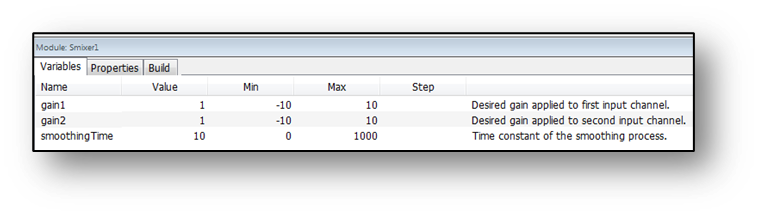

SMixer2x1
This mixer takes in two pins of arbitrary channel count and outputs the sum of the two with a scale factor specified in the module’s variables.
