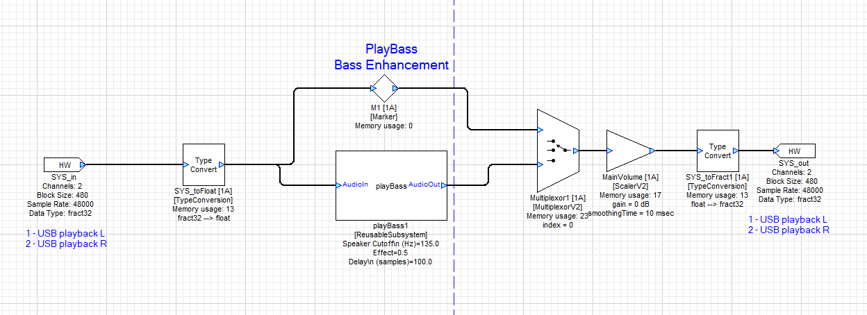

Figure 1 shows an example layout demonstrating the PlayBass Reusable Subsystem. This example layout is designed to run in Native Mode with a file input; audio signals must be assigned to appropriate channels for running the layout on a target device. A module for gain control (the MainVolume ScalerV2 module in this example) should be located after the PlayBass Reusable Subsystem for volume adjustment.
Figure 1: Example layout demonstrating the PlayBass Reusable Subsystem with a stereo input

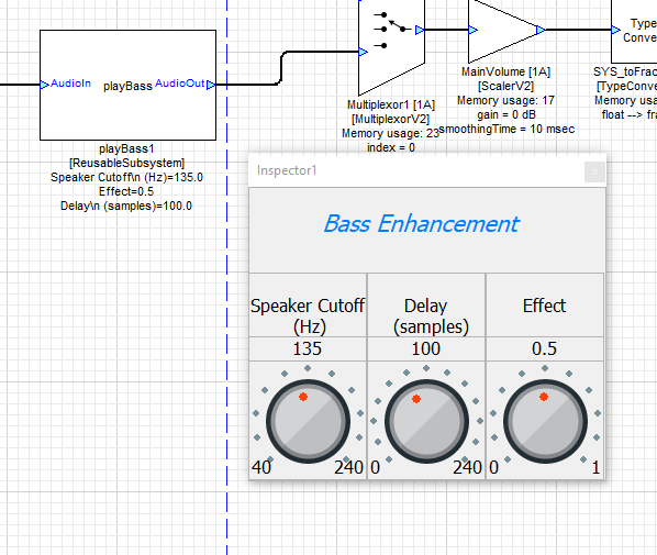

The PlayBass Reusable Subsystem includes an inspector which allows users to tune the speaker cutoff frequency, the delay, and the strength of pseudo-low-frequency content. Figure 3 shows the inspector panel of the PlayBass Reusable Subsystem.
Figure 2: PlayBass Reusable Subsystem inspector window
Speaker Cutoff
The Speaker Cutoff frequency depends on the low-frequency performance of the speaker. PlayBass generates the pseudo-low-frequency content below the speaker cut-off frequency. Smaller drivers need a higher cut-off frequency. Table 1 is a guideline of the typical speaker cutoff frequency for various driver sizes. DSP Concepts suggest starting the tuning with those frequencies.

Delay
The Delay is a time lag applied before the pseudo-low-frequency content is added. The Delay range is between 0 and 200 milliseconds. DSP Concepts recommends using 100 milliseconds as a default. A longer delay may generate more bass enhancement effect, but it may also cause sonic artifacts.
Effect
The Effect knob allows users to control the amount of pseudo-low-frequency content. The range is between 0 and 1. 1 is the strongest effect, and 0 is no effect. DSP Concepts recommends using 0.5 as a default. A stronger setting such as 1.0 may cause clipping distortion.
