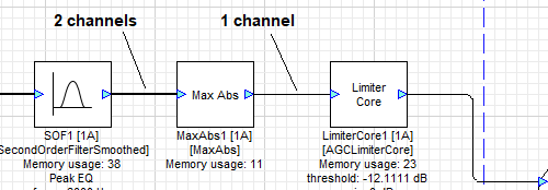

Audio wires carry audio signals that you will listen to. Audio wires are represented in the layout by a solid line. The wider the line, the more channels are being carried on that wire.
Figure 1. Number of channels sets the wire width

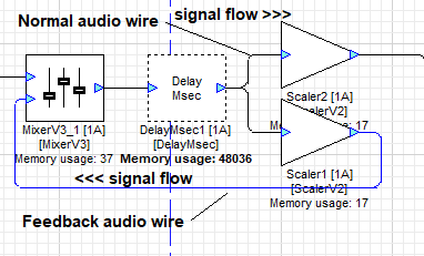

Feedback
Feedback wires are a special case of audio wires, where the destination of the signal is closer to the input pin than the source of the signal. These are displayed in a blue color as shown below.
Figure 2. Feedback paths require special handling
Feedback wires will be discussed in detail in the section Feedback.

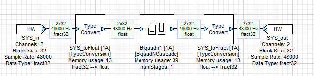

The number of channels and block size of a wire is called its size. Show wire properties using the View→Wire Info menu item. When enabled, you will see the details of each wire displayed as shown below. The sample rate and data type are also shown.
Figure 4. View->Wire Info

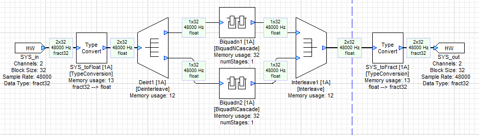

Most modules can operate on an arbitrary number of channels and block size. When a chain of modules is connected using a multi-channel wire, the processed result is the same as if you had deinterleaved the data to individual channels and sent each one through a single-channel chain of modules.
Figure 5. Multichannel modules
is functionally equivalent to
Figure 6. Single channel module equivalent
However, since wire connections also consume memory, the first layout which uses fewer modules (and therefore connections) uses less memory.

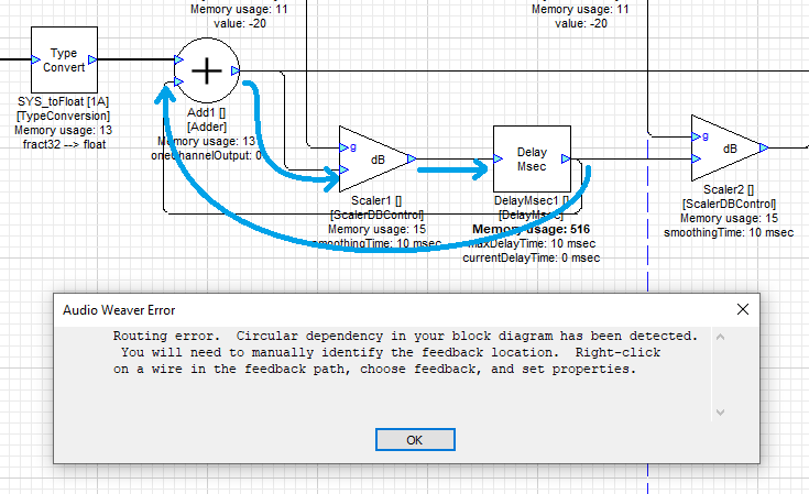

When you create a signal path where the source of the signal is “downstream” of the signal’s destination, this is known as a feedback loop. An example is given below.
Figure 14. Circular path routing error
Note that a wire going from right to left in the layout does not always cause a feedback loop. Only if a signal’s path as traced through any given set of modules can come back to the source of that signal is a feedback loop created.
If you attempt to run this layout, an Audio Weaver error dialog will be shown. You’ll have to figure out where the loop is and then set the wire properties to make it a Feedback wire.

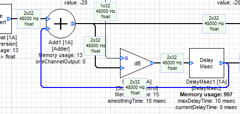

To mark a wire as Feedback, do the following:
  1. Highlight the wire with the mouse (right-click)
  2. Choose “Make Wire Feedback” from the popup menu. The wire turns blue.
Figure 15. Updating the Feedback wire's properties
  • Now you will have to set the wire properties, which will otherwise be inherited from the input pin. At the minimum, you will typically need to set:
    • numChannels
    • dataType
Make sure that these values match the properties of the source block’s output pin. Turn on Wire Info view if needed (View->Wire Info).

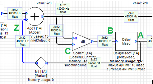

If you have Markers in the feedback path, you only need to mark the last segment as “Feedback”. Wire “Z” below is correctly assigned as “Feedback”.
Figure 16. Feedback path identified

Debugging failures
Check the layout by clicking on “Propagate Changes” or “Build and Run”. If there is an error, you will hear a system sound and the associated wires will be shown with “?” in the Wire Info. In the example below, the error is that the adder is expecting two channels on all inputs, but we set the blue feedback wire’s numChannel property to 1. Notice that the errors start just downstream of the wire that is causing the problem.
Figure 17. Wire properties unknown
Changing the blue feedback wire’s numChannels property to 2 removes the error after you click on “Propagate Changes” or “Build and Run” again.
Figure 18. Wire properties updated

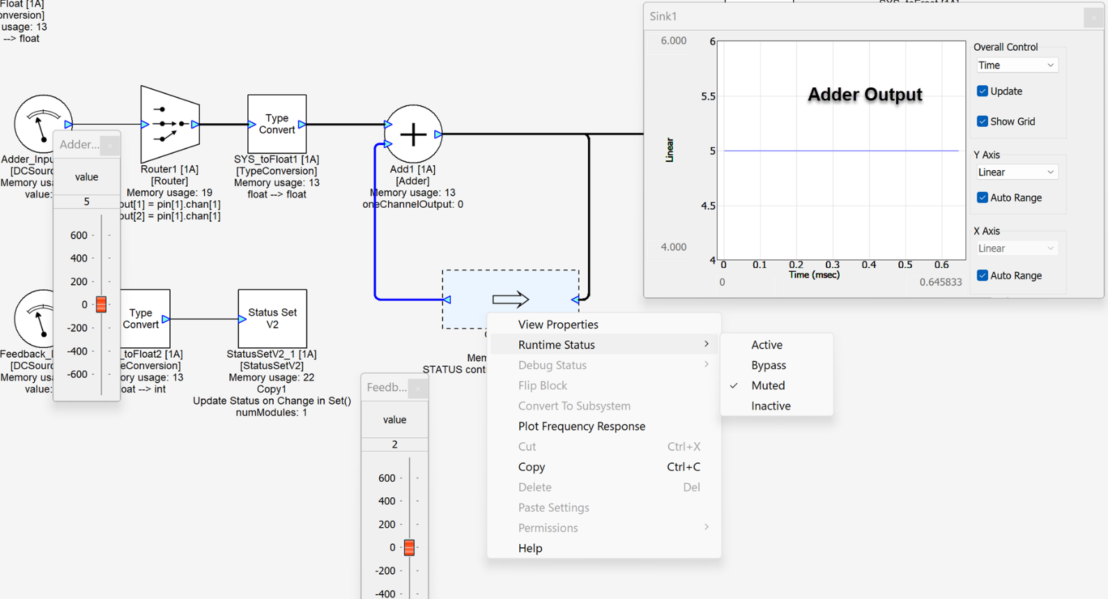

Interactions with Module Status
The feedback wire along with the Copier module can be used to control the status of the feedback loop. In the example shown below; the output of the adder is fed back into the second input of the adder via a feedback loop. To control the status of the feedback loop we have added a Copier module before the feedback wire. The status of the feedback wire is being controlled byStatus Set Module which in turn gets the input from Feedback_DC.
Figure 19. Controlling feedback wire status
In this example by changing the Feedback_DC value to 3 then the Copier module becomes inactive effectively stopping the feedback loop and stopping the output of the adder. Whereas when the Feedback_DC value is 2 the Copier module becomes mute and starts pumping zeros instead into the feedback loop. The output of the Adder is the value of Adder_Input1 in this case.
Figure 20. Controlling feedback wire status
