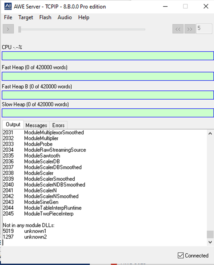

List Modules
You can see the full list of available modules on your target by using the “List Modules” feature in AWE Server. Connect to the target of choice and then select Target->List Modules. Each recognized module class name will be shown along with the unique Class ID number of that module. If any modules returned by the target are not recognized by AWE Server, then they will show up as unknown module classes.
If a module is not recognized by AWE Server, then it means that there is no corresponding DLL library that defines the module in the < Designer Install Dir>/Bin/win32-vc142-rel folder, and the module will not be usable in Designer.
