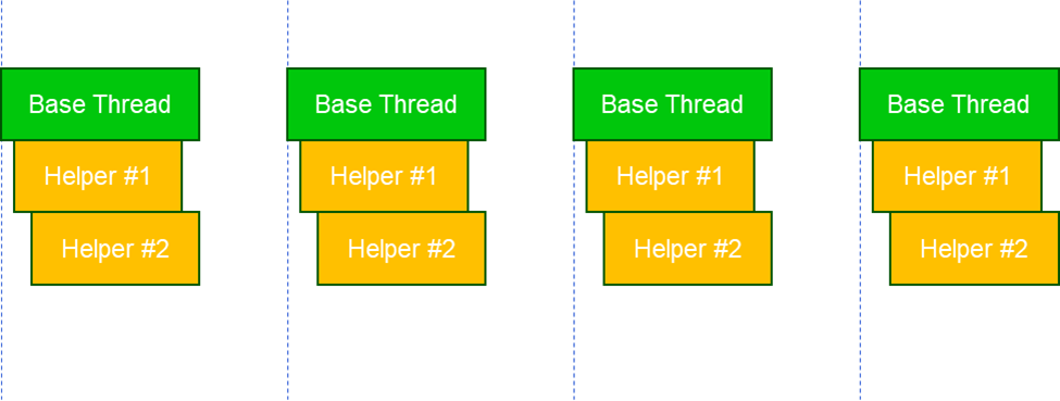

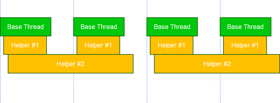

Problem Statement
Consider a custom module which operates at a fixed block size of 5 msecs. In the diagram below, the processing in green is part of the custom module and captured by the Audio Weaver profiling functions. Suppose that the module leverages 2 additional internal system threads, shown in orange. The module runs all 3 threads in parallel and blocks Base Thread until all Helper threads have completed.
Audio Weaver will only capture the computation in the Base Thread while the computation used by the Helper Threads will be lost. Since Base Thread is blocking on the Helper threads, the CPU load of Base Thread shown in profiling results will end up being max(BaseThreadCycles, Helper1Cycles, Helper2Cycles). This makes it impossible to determine what the actual CPU load of any of the individual threads is, so profiling information can’t be used to help balance the processing load between the 3 threads.
In the example above, all 3 threads operate within the context of a 5 msec block. Consider the more sophisticated system shown below. The main thread operates at 5 msec, Helper #1 operates at 5 msec and Helper #2 operates at 10 msec (the custom module would be responsible for all synchronization and buffering between the threads). The ProfileThread module must be able to capture useful profiling for both of these use cases.
The following section describes an extension which allows custom modules to report the additional processing used by hidden internal threads to the overall Audio Weaver framework. This is important for the targets like Hexagon DSP since it has multiple hardware threads which increase the computational throughput of the device.

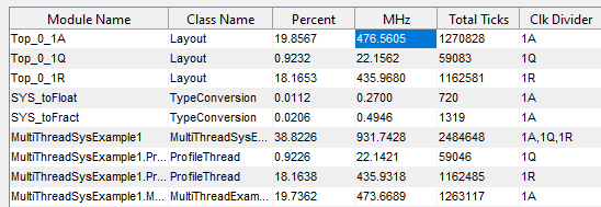

Profiling Results
When profiling layouts that have ProfileThread modules included, the profiling results will include a row for each unique layout associated with the ProfileThread modules, as well as a row for the module itself. For example, below is an example subsystem module MultiThreadSysExample that includes 2 ProfileThread modules (1Q and 1R) running in system threads.
The Clk Divider column shows results for a Layout and ProfileThread Class for each of the 1Q and 1R clock dividers.
