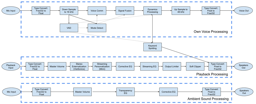

Audio in the design can be broken into three distinct, but related paths. One is the path of audio from the microphones to the connected device called the own voice processing path. The second is the path of audio from the device to the transducers in the earbuds called the playback processing path. The third is the path from the microphones to the transducers in the earbuds called the ambient sound processing path. The following diagram outlines the three paths.
The processing that composes these paths is described later in this guide.

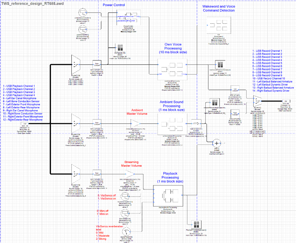

TWS Reference Design High-Level Processing Diagram

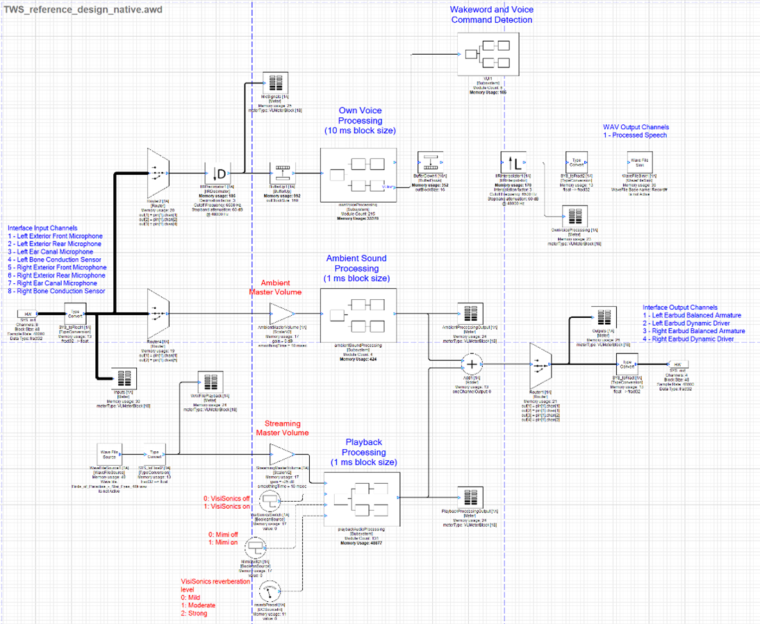

Native Design
Native Mode TWS Reference Design
Setup
The native design assumes that you have followed the setup instructions in the RAPID TWS Kit Setup and User Guide. Please review that document before proceeding.

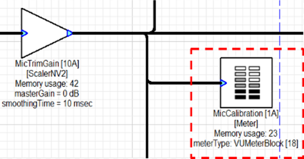

Calibration
Because the interface does not apply fixed gain to the signals from the earbuds, you must calibrate the gains applied to the microphones for proper functioning of the design. Levels should be set using the VU meter following the mic trim gain in the record path.
VU Meter
Exterior/Ear Canal Microphones
- Play 1 kHz tone at 70 dBa at 1 foot from the transducer.
- Adjust microphone gains via the ‘MicTrimGain’ ScalerNV2 module until they show –40 dBFS on the meter in Audio Weaver.
Bone Conduction Sensor
- Wearing the earbuds, make an “E” sound at 70 dBc at 18 inches.

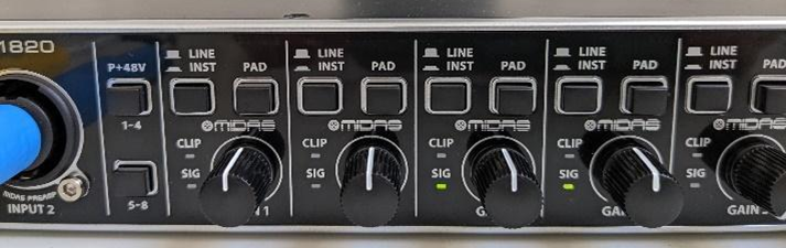

Microphone input
Microphone input analog gain knob shall be set to 12 o’clock direction.
UMC1820 Microphone Gain Levels

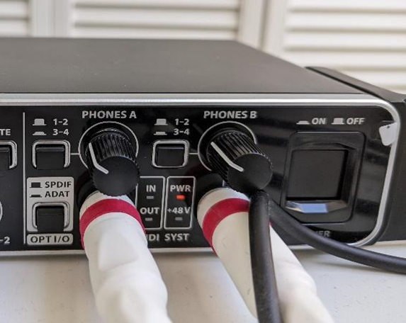

Speaker Output
Speaker output analog gain knob shall be set to 10 o’clock direction.
UMC1820 Playback Gain Levels

Audio Routing
In the native design, the input and output pins of the system are used for sending and receiving audio from the earbuds. The following tables display the configuration of signals assumed by the design. For setup instructions, refer to DSP Concepts RAPID TWS Kit Setup and User Guide.
Input
Table: Native Mode TWS Reference Design Input Channels
| Pin | Signal |
| IN 1 | Left Exterior Microphone #1 |
| IN 2 | Left Exterior Microphone #2 |
| IN 3 | Left Ear Canal Microphone |
| IN 4 | Left Bone Conduction Sensor |
| IN 5 | Right Exterior Microphone #1 |
| IN 6 | Right Exterior Microphone #2 |
| IN 7 | Right Ear Canal Microphone |
| IN 8 | Right Bone Conduction Sensor |
Output
Table: Native Mode TWS Reference Design Output Channels
| Pin | Signal |
| OUT 1 | Left Earbud Balanced Armature |
| OUT 2 | Left Earbud Dynamic Driver |
| OUT 3 | Right Earbud Balanced Armature |
| OUT 4 | Right Earbud Dynamic Driver |

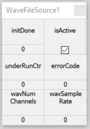

Playback of audio from a WAV file on disk is controlled by the Wave File Source module. Double left-click the module to bring up an Inspector for the module. Playback can be stopped and started by clicking the isActive check box.
WaveFileSource Module Inspector

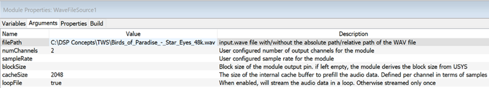

Control of the playback file path, number of channels, sample rate, block size, cache size, and looping can be accessed by completing the following steps:
- Right-click the WaveFileSource module.
- Select View Properties.
- Select the Arguments tab in the Property Sheet at the bottom of the Designer window.
WaveFileSource Module Arguments Tab

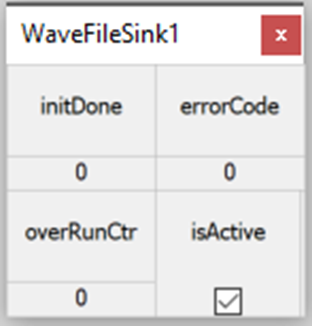

Recording of audio to a WAV file is controlled by the WaveFileSink module. Double left-click the module to bring up a small Inspector control panel for the module. Recording can be stopped and started by toggling the isActive check box.
WaveFileSink Module Inspector

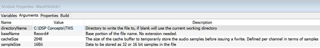

Control of the record file path, file base name, cache size, and bit depth can be accessed by completing the following steps:
- Right-click the WaveFileSink module.

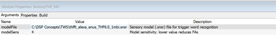

Keyword Detection Model
You can access control of the trigger word recognition model file by completing the following steps:
- Right-click the SensoryTHF_V6 module in the VUI subsystem.
- Specify the file path of the desired Sensory model.
SensoryTHF_V6 Module Arguments Tab

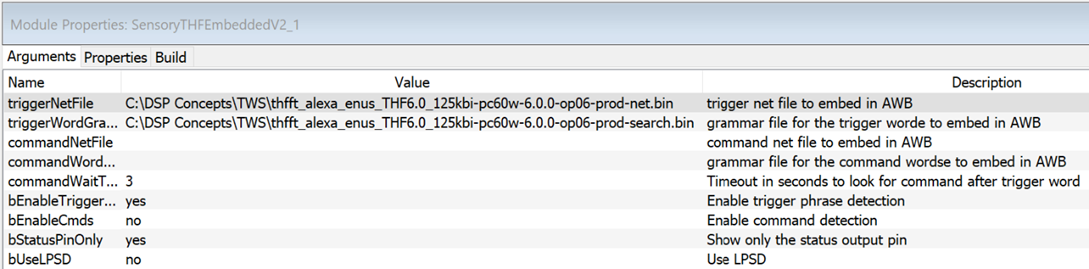

- Right-click the SensoryTHFEmbeddedV2 module in the VUI subsystem.
