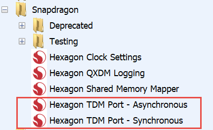

There will be two different Audio Weaver modules for interfacing to the TDM ports, The SnapdragonSyncTDMPort will handle all of the synchronous use cases and will support input and output ports. The SnapdragonAsyncTDMPort will handle the asynchronous use cases. [Note that the SnapdragonAsyncTDMPort will not be available until a later release. It is not in the Audio Weaver R4.3 release.]
The Sync TDM ports begin running at system startup and continue to run until the system enters Low Power or Deep Sleep mode. The Async TDM modules can be stopped / started at run-time and the application code can reconfigure them while stopped.
The serial ports on the Snapdragon record a 64-bit time stamp upon buffer completion (the ping/pong switch). This time stamp has a resolution of 19.2 MHz and is written by the hardware peripherals. It is very accurate and does not rely on a software interrupt which may have jitter. This time stamp information will be used to align unaligned transfers and for the ASRC control loop needed for AS ports.
There are separate synchronous and asynchronous port interface modules as shown below. Each module can be used for input or output.

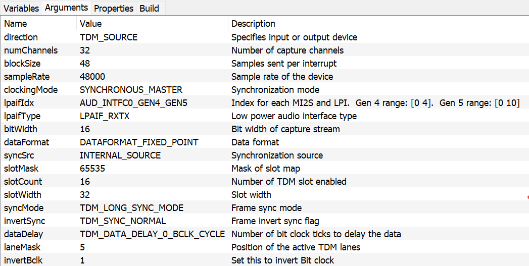

Module Arguments
The module has a large number of arguments.

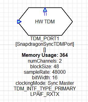

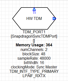

direction - specifies whether this is a sink device (=0) or a source device (=1):
When configured as a TDM_SOURCE, the module has an audio output port (on the right), and a Timing Information port (TI) located on the top:
When configured as a TDM_SINK, the module has an input port on the left side and a Timing Information port (TI) located on the top:
numChannels, blockSize, and sampleRate - specify the properties of the TDM port. If this is an input module, then these values will also specify the properties of the output wire. If this is an output port, then the wire properties at the input must match these values. The sampleRate value is taken from a droplist:
clockingMode - specifies the clocking properties that was described above:
All other properties are taken directly from the AudioLite APIs and are used when opening the port. Here is a short explanation of the settings, more information can be found in Qualcomm documentation.
{lpaifIdx, lpaifType} - this pair of settings uniquely the port on the Snapdragon SOC. The lpaifType is only used in Gen 4 silicon and identifies different hardware subsystems on the SOC. For Gen 5 silicon, all TDM ports are included in the same hardware subsystem and this setting is ignored. lpaifIdx is the “port index” and specifies the port within a specific subsystem.
dataFormat - taken from AudioLite. You should only use “DATAFORMAT_FIXED_POINT”.
syncSrc - Specifies the source of the frame sync signal. Options include INTERNAL_SOURCE (generated by SoC as the clock master) or EXTERNAL_SOURCE (from an external clock input into the SoC).
slotMask - Bitmask specifying which active TDM slots to use. Each bit represents a time slot in the TDM frame. For example, 0x03 enables slots 0 and 1 (bits 0 and 1 set). This is an unsigned 32-bit value since a TDM port can have up to 32 slots.
slotCount - Total number of TDM slots in each frame. For example, set this to 2 for stereo data or 8 for 8 channel data. The number of bits in slotMask equals slotCount.
slotWidth - Width of each individual slot, in bits. Typical values are 8, 16, and 32. This controls slot packing and data padding.
syncMode - Specifies how the type of frame sync signal operates. Options are TDM_SHORT_SYNC_BIT_MODE (1-bit sync pulse) or TDM_LONG_SYNC_MODE (sync active for half of the full frame) or TDM_SHORT_SYNC_SLOT_MODE (sync active for the first slot of the full frame).
invertSync - Boolean setting to invert frame sync signal polarity. Used when the external codec expects opposite sync edge (e.g., active-low instead of active-high).
dataDelay - Number of bit clocks between the frame sync and valid data. Typical values are 0,1, or 2, affecting word alignment.
laneMask - Bitmask specifying which physical data lanes are active. E.g., 0x1 for lane 0 only, or 0x3 for lanes 0 and 1. Used in multichannel/multilane modes.
bitWidth - Total valid bit width per sample on the wire. Must be equal to or less than slotWidth.
invertBclk - Boolean setting to invert bit clock polarity.
A single TDM port can connect with multiple data lines. Each data line is called a “lane” and a port can have up to 8 individual lanes. The laneMask is a bit field that specifies which lane(s) (or data lines) are used by the port. The number of lanes equals the number of nonzero bits in the laneMask. Using more lanes increases the number of channels in the port.
Each data line / lane on a physical TDM port can be configured to be either an input or an output. In this mode, the input and output will share the same frame sync and bit clock, and the user must assure that the two ports are configured with matching parameters: bitWidth / slotCount / slotWidth / invertSync / dataDelay / syncMode / syncSrc / slotMask / dataFormat.
Each lane of a port has a total of slotCount channels in the TDM frame structure. slotMask is a bit field which specifies which of the slots will be used. The number of active slots equals the number of non-zero bits in the slotMask. For example, you can have slotCount = 32 and be connected to an A2B network. However if slotMask = 0xFF, you are only reading/writing 8 slots of the 32 available.
The total number of channels at the output (or input) of the port equals the numChannels argument. This must match (number of lanes) x (active slot count). This is checked within the Designer code and you will receive an error if this condition is not satisfied.

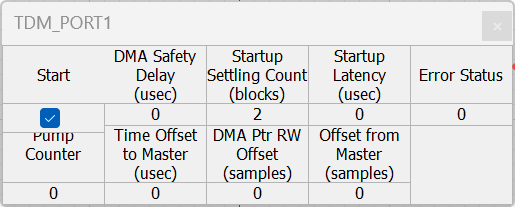

Module Inspector
Start - User Parameter. Allows you to turn the port on or off. This is not available for the SM since this device must always be running.
DMA Safety Delay - User Parameter. Additional use specified time delay that will be used in the offset calculation. This will be used for testing and for situations when we want to give more time for the DMA to complete. The actual math used is:
DMA Offset = floor((TS_SM - TS_SU + dmaSafeDelay) / (Sample Period))
Startup Settling Count - User Parameter. This specifies how many blocks pump cycles the module will do and continue to output zero data. This gives the module time to calculate its read/write offset so that it doesn’t introduce a pop or click when it changes.
Startup Latency - User Parameter. The BSP will wait the specified number of microseconds before enabling the serial port clocks. This value is used for testing and will allow us to play with the alignment between ports. During normal usage, it should be set to 0.
Error Status - Read Back State. Reports errors in startup or operation. 0 indicates no error.
Pump Counter - Read Back State. Increments every time the module’s processing function is called.
Time Offset to Master - Read Back State. This is the computed time skew between this port and the SM This is a floating-point number and represents microseconds.
DMA Ptr RW Offset - Read Back State. This is the computed sample offset when accessing the DMA buffer. This is calculated per block. Instead of accessing the buffer at the expected start of the ping or pong buffer, this offset is added.
Offset to Master - Read Back State. This is the true offset in samples relative to the SM device. It is used to add compensating delay in the system. If a SU device has a latency of +1 samples, then the SM should be delayed by 1 sample.
