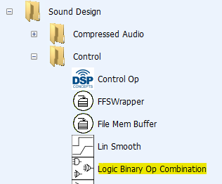

The LogicBinaryOpCombination module can be found in Sound Design/Control folder or by using the search window in the module browser.
Figure 1. Location in Module Browser

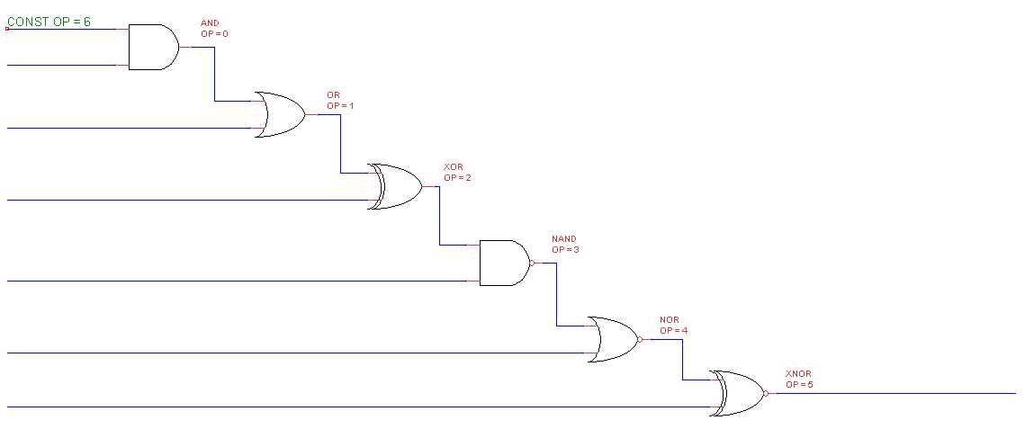

Figure 2. Single chain of cascaded gates
Figure 3. More than one chain, each chain with its own output.

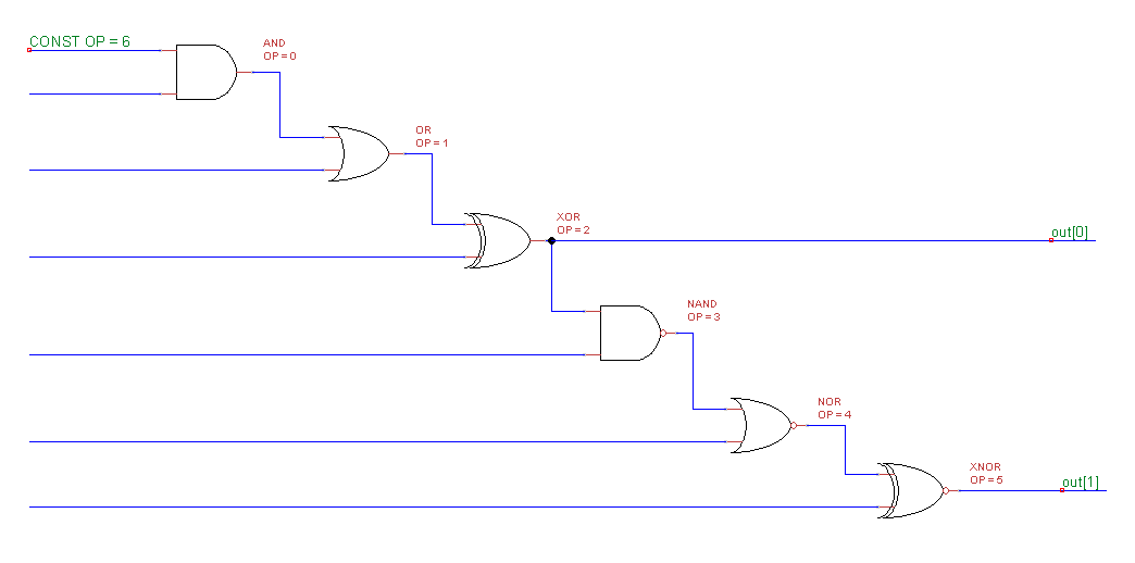

Figure 4. Multiple Outputs from a single chain

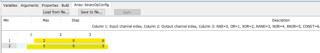

The simplest function, which is a single logic gate, requires two operations. By default, there is only one operation defined, so you must add another one. Let’s configure a NAND gate. This section of the layout has a wire with 7 channels of int data. We want to pick off channels 2 and 5 and NAND them together.

Now click on the Array:binaryOpConfig tab. Set the entries as shown, then click “Apply”.
Figure 9. Edit array to set the desired function.

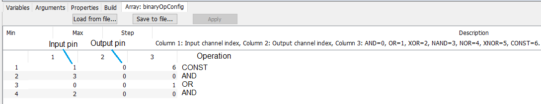

Here’s a module with 4 inputs and 1 output.
Figure 11. numOps setting for multiple inputs
Figure 12. Array settings for multiple inputs
This implements the logic function:
Out[0] = (( In[1] & In[3] ) | In[0] ) & In[2]
Figure 13. (( In[1] & In[3] ) | In[0] ) & In[2]

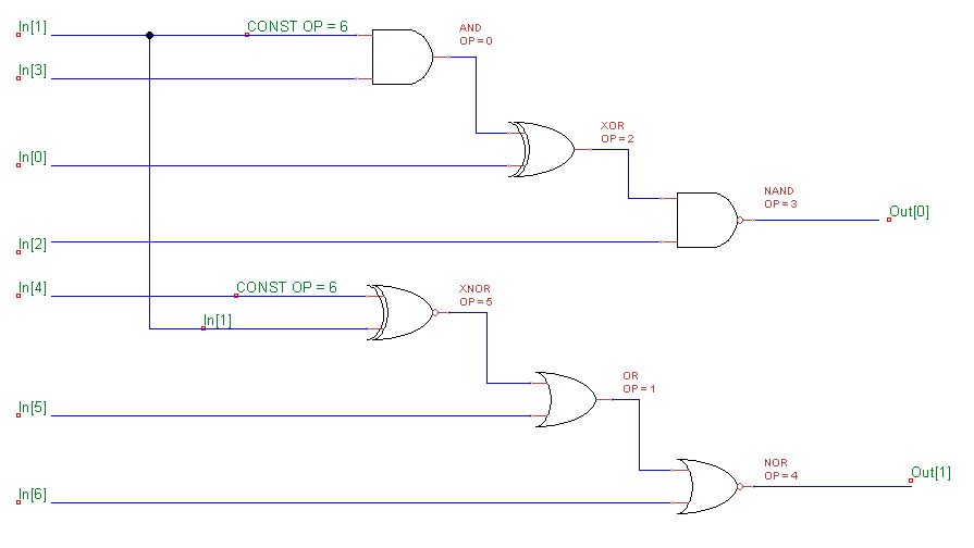

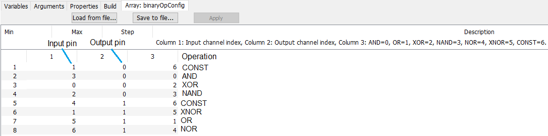

Multiple Expressions
Two expressions of three operations each are implemented below. Note that it is possible to use the same input channel in both expressions. You can add more expressions by increasing numOut. Each expression uses a single output channel.
Figure 14. Arguments settings for multiple outputs
Figure 15. Array settings for multiple inputs
Figure 16. Confirm settings

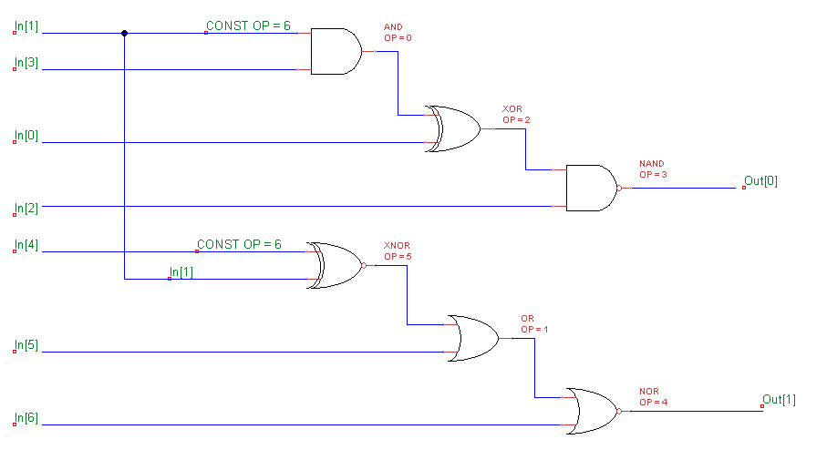

This implements the logic functions:
Out[0] = (( In[1] AND In[3] ) XOR In[0] ) NAND In[2]
Out[1] = (( In[4] XNOR In[1] ) OR In[5] ) NOR In[6]
Figure 17. Equivalent logic diagram

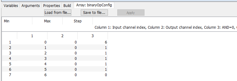

Although this module cannot be used to implement arbitrary combinatorial logic with N inputs and M outputs, it can be leveraged to quickly implement wide AND and OR gates.

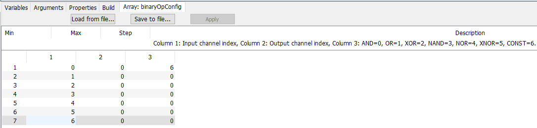

7-input AND gate
Figure 18. Array settings for7-AND
Figure 19. Argument settings for 7-AND
Figure 20. Confirm settings

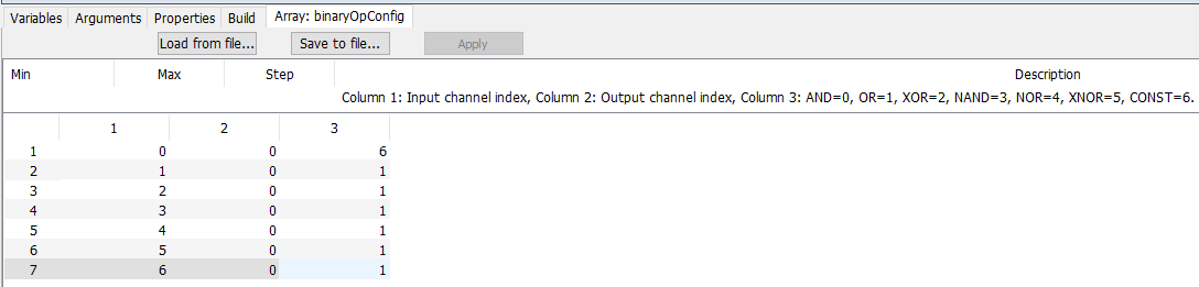

7-input OR gate
Figure 21. Array settings for 7-OR
Figure 22.. Argument settings for 7-OR
Figure 23.Confirm settings

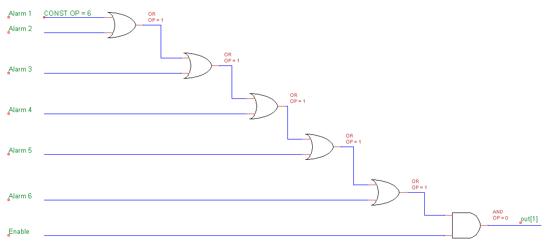

6-input OR gate + AND
You can add an AND term onto the end to act as a global qualifier, such as a master enable for a variety of alarm sources (OR).
Figure 24. Argument settings for 6-OR+AND
Figure 25. Array settings for 6-OR+AND
Figure 26. Confirm settings
Figure 27. Equivalent logic diagram
