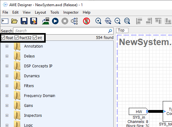

At the top of the module browser, there is a checkbox to filter based on the different module data types. (S ee below.). This will filter out modules for hardware that operates on specific sample data type (fract32 for fixed-point). The integer module libraries are typically used for control operations and work on both fixed-point and floating-point targets. The type convert module allows any data type to transfer into the others. This may be destructive if converting to a type with lower resolution.
Module Browser overview
Audio Weaver modules are organized into separate browser folders based on their function. The folders are arranged in alphabetical order titled with a short description of the contents. A search bar can be found directly above the browser window. To use the search bar, type the name or some common tag for the wanted module and press enter.

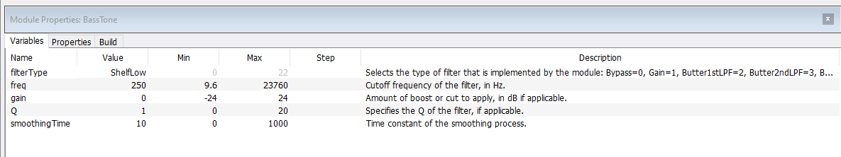

An audio module gets instantiated when dragged to the canvas from the Module Browser, located on the left hand side of the canvas. Module argumentscan only be changed in Design mode and affect memory allocation, pins, and wiring. Module variablesare tunable parameters which can be changed in either mode. Arguments tend to define memory allocation for the module, which can't be changed during runtime. For example, in an FIR filter, the length of the filter (number of taps) is specified as an argument. This length affects memory allocation and as a result setting these arguments is only allowed in Design mode. The FIR coefficients (a variable) can change at any time.
After a module is instantiated, change its arguments and variables by right-clicking and selecting View Properties.

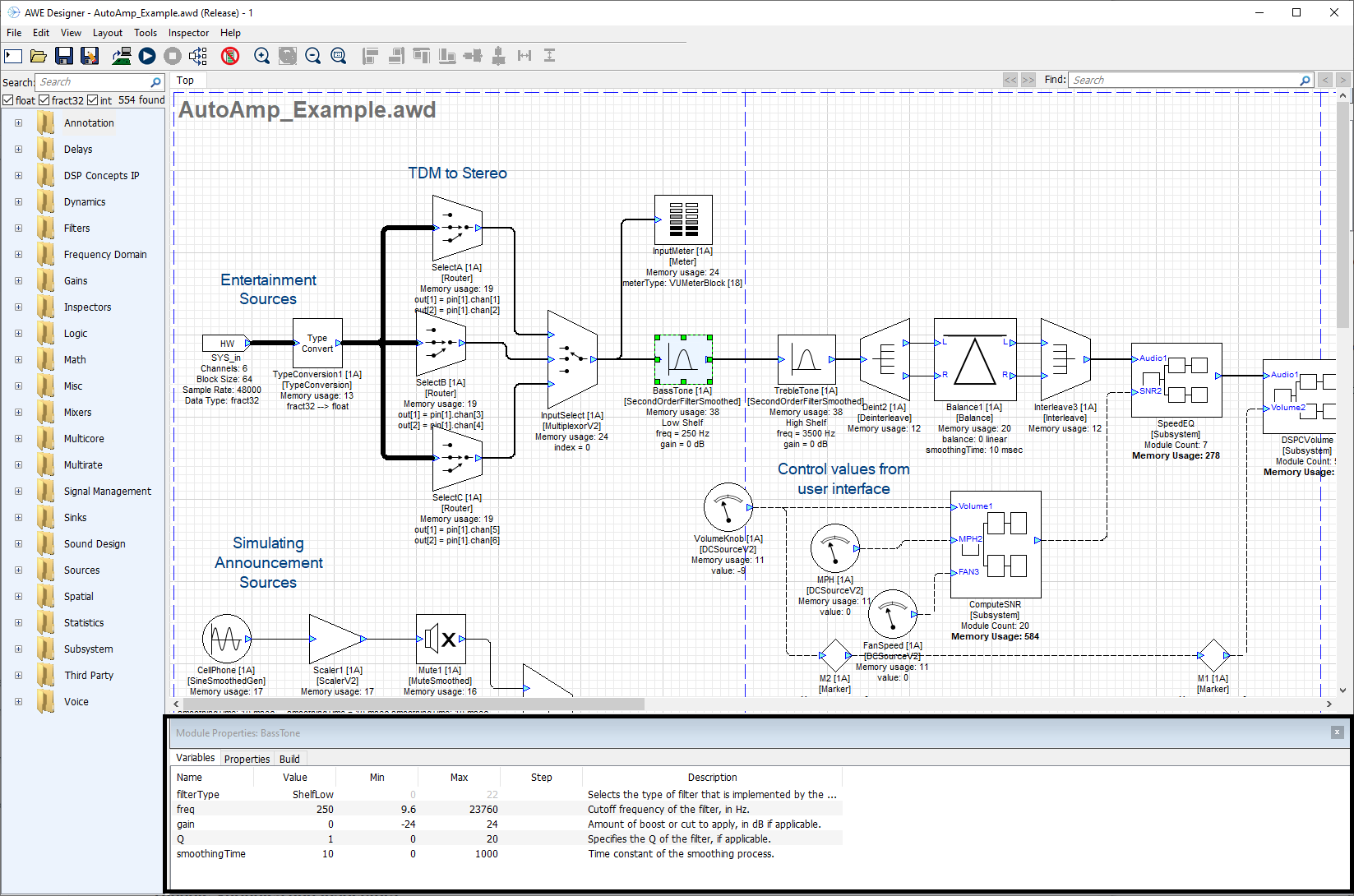

This opens up the Module Properties manager beneath the AWE Designer canvas:
AWE Designer with Module Properties Manager Shown
Module Properties Manager (Detail View)

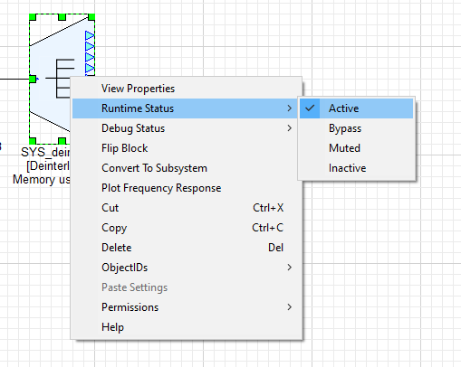

Module Status
Each module has an associated runtime status with 4 possible values:
Active The module's processing function is being called. This is the default behavior when a module is first instantiated.
Muted The module's processing function is not called. Instead, all of the output wires attached to the module are filled with zeros.
Bypassed The module's processing function is not called. Instead, the module's input wires are copied directly to its output wires. Some modules use an intelligent generic algorithm which attempts to match up input and output wires of the same size. Other modules implement custom bypass functions.
Inactive The module's processing function is not called and the output wire is untouched. This mode is used almost exclusively for debugging and the output wire is left in an indeterminate state. Use with caution!
Changing the module status is useful for debugging and making simple changes to the processing at run-time. The module status can be changed in both Design mode and Tuning mode.
The Module Status can be changed by right-clicking on a module and selecting Module Status \to' . To change the module status of a group, select multiple modules(including subsystems) with drag and select or by pressing ctrl , and right-click to change the status of all selected modules.

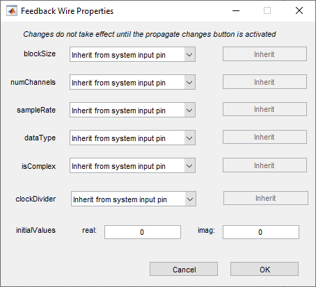

To make a feedback wire, right click a wire and select Feedback. The wire will turn blue to indicate that it is a feedback wire. For each marked feedback wire, Audio Weaver will create a dedicated buffer to store its data. At system startup, data in the wire is initialized to all zeros.
If a feedback wire is left unmarked , the following error will appear after an attempt to build the system:
To solve this, locate the feedback point in the block diagram and then mark the feedback wire.
Wire size information must be set using the Feedback Properties dialog which is reached by right-clicking on the feedback wire. The following dialogue box opens, allowing the ability to set the wire's block size, number of channels, sample rate, data type, and whether or not it is complex. This should match the pins that the wire is connecting.

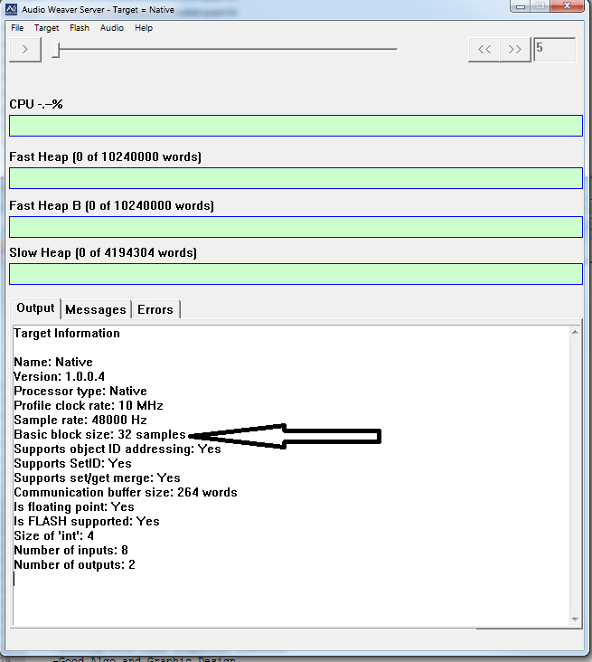

Each hardware target has a fundamental block size to specify how many samples per block are handled by the real-time audio I/O functions. This is shown on the Server window when the Server launches. (See below.)
Layouts can use any multiple of the target's fundamental blockSize. Change blockSize at any time by adjusting the hardware input parameters in SYS_in. BlockSize information is propagated from the input pin, through the modules, to the output pin. The blockSize of the output pin is set by pin propagation.

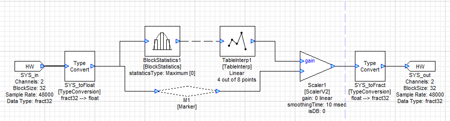

Interpolator and decimator modules increase or decrease the blockSize. Some modules also output a single value control signal (blockSize = 1). For example, the BlockStatistics module can be configured to output the average value of a block of samples. This data will be one value per block. Control signals are drawn with dashed lines instead of solid lines.
In the example below, the BlockStatistics1 module computes the RMS level of the signal and a lookup table (TableInterp1) turns this into a linear gain to be applied by Scaler1. The signals into and out of the lookup table module are control signals.
