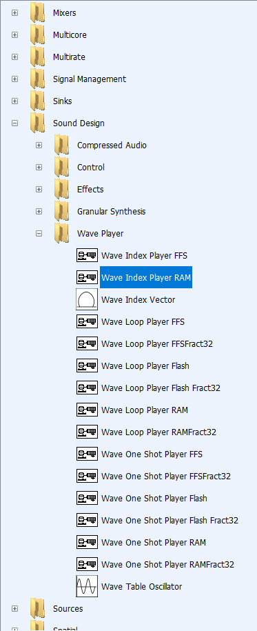

The Wave Index Player module executes the WAV playback using index vector as pitch factor input. The module plays out the .wav file in a loop mode and takes an input stream or vector as sample index input. The module can be found in Sound Design->WavePlayer-> Wave Index Player in the Module Bar on the left-hand side of the AudioWeaver Designer.
Figure 1: Wave Index Player module location

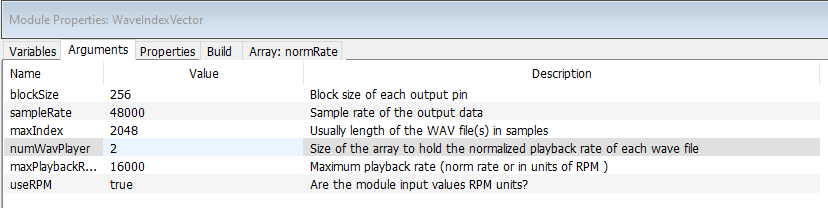

Arguments can be found Rt Click View Properties second tab in the properties as shown. The following table shows the list of arguments in the Wave One Index Player RAM module, explanations along with their respective default values.
Arguments Description Default Value
blockSize Number of samples per output channel. By default, blockSize = Blank
sampleRate Sample rate of the output signal, in Hz. By default, samplerate = Blank.
maxIndex Usually, the length of the wav file/files in samples By default, maxIndex = 2048.
numWavPlayer Size of array to hold the normalized playback rate of each wave file By default, numWavPlayer = 2.
maxPlaybackRate Maximum playback rate By default, maxPlaybackRate =5.
useRPM Are the module input values RPM units By default,useRPM = False

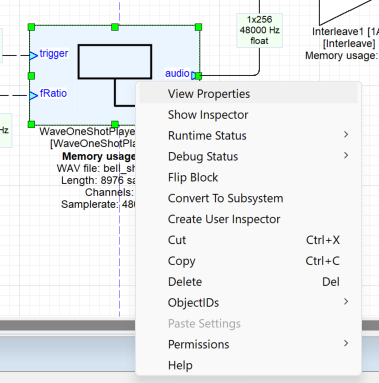

The variables are the first tab in Module properties which is Rt Click on the module View Properties.
Figure 3: View Properties

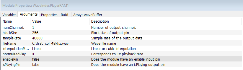

Figure 4: Argument Tab for Wave Index Player RAM
numChannels Number of interleaved channels in the audio output pin. By default, numChannels = 1.
blockSize Number of samples per output channel. By default, blockSize = 256.
sampleRate Sample rate of the output signal, in Hz. By default, SAMPLERATE = 48000.
fileName Name of the wave file to be played. By default, WAVFILE = ''.
InterpolationMode interpolation method.Linear Cubic By default, INTERP = linear. (Only in floating point variant)
normalizedPlaybackRate normalized playback rate. By default, NRATE = 1.
isplayingpin Boolean that provides the current playback state (PLAYING=1, STOPPED=0)
enablePin Does the module have an enable input pin By default, False

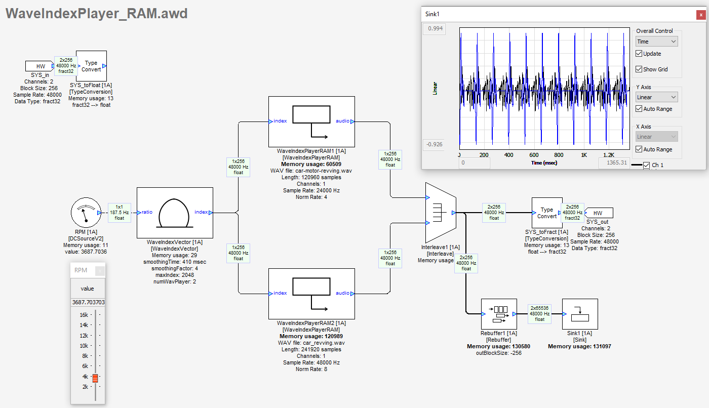

In the example shown below, we are using two Wave Index Players that receive the index of the starting sample from a Wave Index Vector module. The Wave Index Players have an input of two different car revving wav file at 48kHz sample rate. By increasing the RPM value [DC Source module] which is fed as a ratio to the wave vector module, the rate of the wav file is controlled. You can see the output from Sink Display that both the wav files are synchronized with increase and decrease in the input RPM value. To run this example, use WaveIndexPlayer_RAM.awd provided along with car-motor-revving.wav and car_revving.wav as the two input files to the Wave Index Player modules. You can add more Wave Players along with indicating the number at ‘numWavPlayer’ variable in the Wave Index Vector module.
Figure 5: Wave Index Player RAM Example

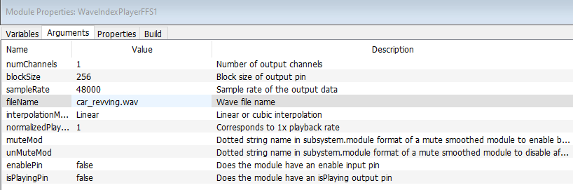

Arguments:
Arguments can be found Rt Click View Properties second tab in the properties.
Figure 7:Arguments of Wave Index Player FFS
normalizedPlaybackRate normalized playback rate. 1 corresponds to 1x playback rate. By default, NRATE = 1.
isplayingpin Boolean that provides the current playback state (PLAYING=1, STOPPED=0) By default: False
muteMod Used to mute output before changing file in run time. By default: Blank
unMuteMod Used to unmute after reconfiguration. By default: Blank
enablePin Does the module have an is enable input pin. By default: False

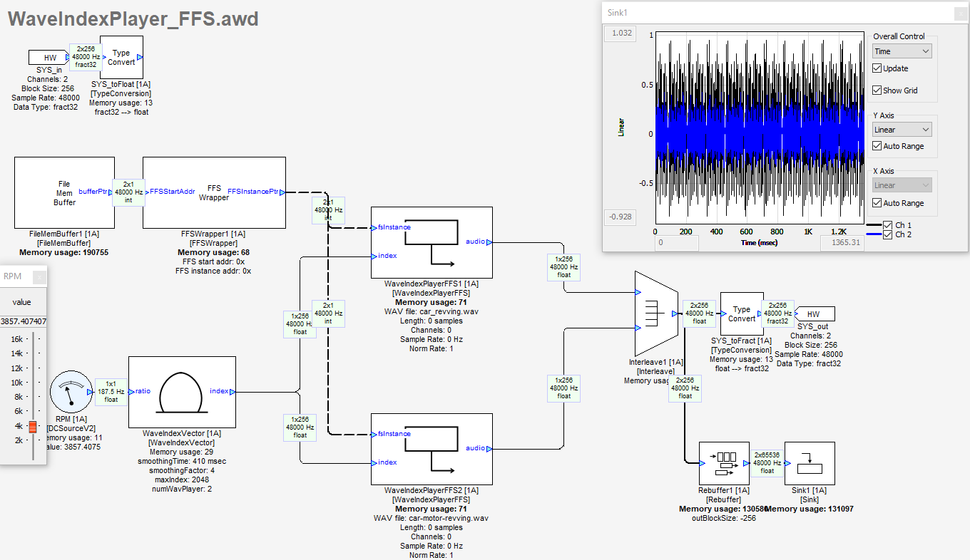

We are using the same example as for the RAM variant for the Wave Index Player FFS. In this case the two-wav file is being fed through the File Buffer Module as a .bin file. For an in depth understanding of making a .bin files please refer to the ‘Wave Library Generator Tool’ application note. The output of the File Memory Buffer is given to an FFS Wrapper for Native Mode. The FFS Wrapper module outputs an instance pointer which is then given to the Wave Index Player FFS. This example can be found in WaveIndexPlayer_FFS.awd.
Figure 8: Wave Index Player FFS Example
