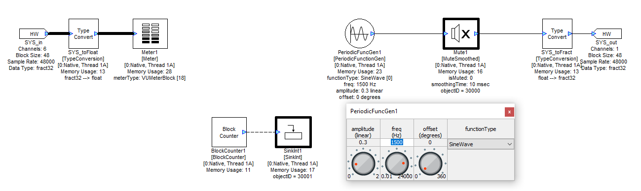

  1. In the design, make changes to the parameters you wish to change. In this example the design “HW_Button_Mute.awd is used from the Control Interface and Debugging app note here: Control Interface Usage and Debugging and the change made was in the PeriodicFuncGen1 module on the “freq” parameter (from 1000 to 1500Hz):

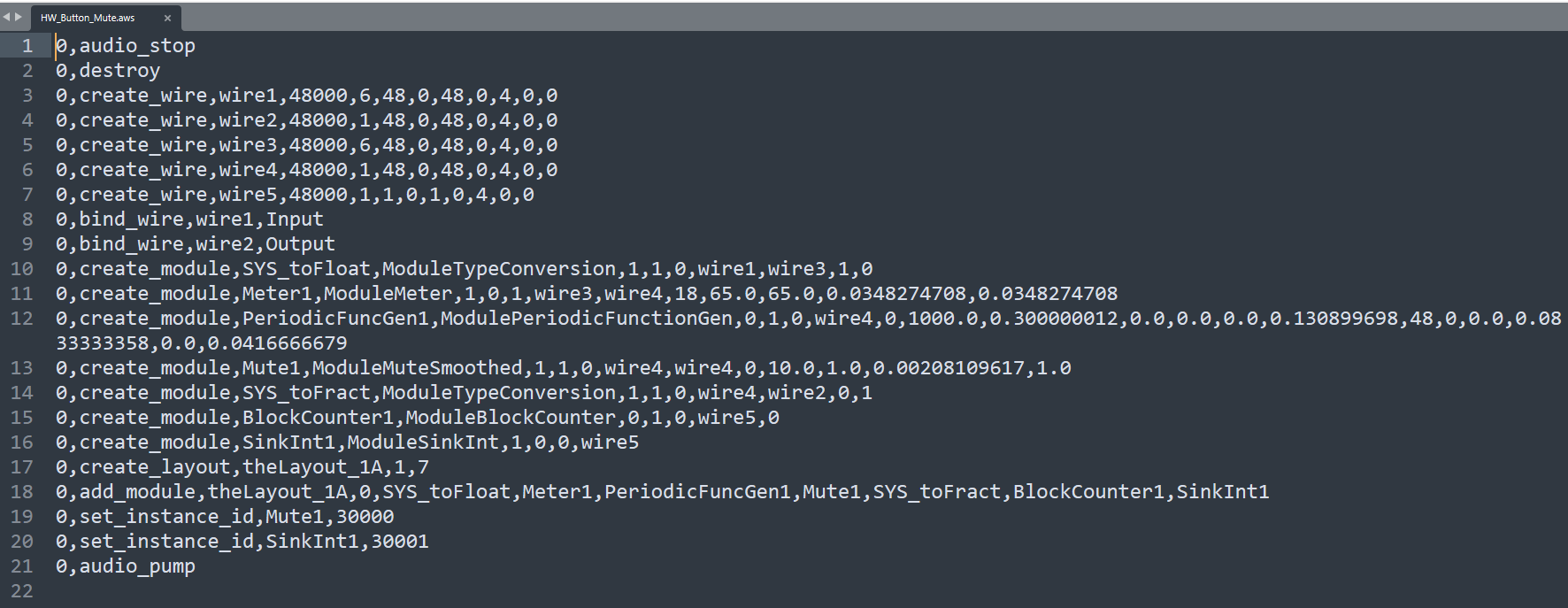

  1. A new preset.aws file will be generated in the current matlab path and shows the following:
This is in contrast to the structure .aws which shows the entire layout as such:

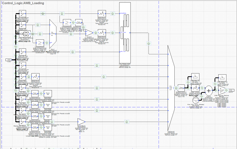

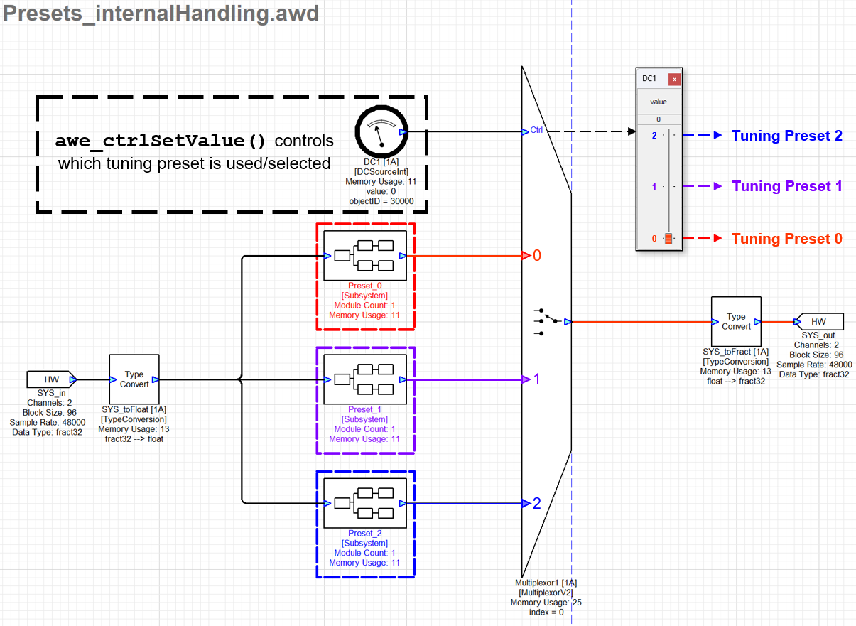

Presets can also be handled internally in the signal flow
•Modules that can be used for this are for example:
NOTE: Functionality in Param Set Table V2 can also be achieved with combining the Array Set and Table Source V2 modules for multi-dim tables or Param Set modules for scalar variables. But Param Set Table V2 adds more convenience, e.g. it supports writing into scalar values (not arrays only), Array Set by itself does not support "OnChangeSet" behavior, hence fewer number of modules in total will be required.
