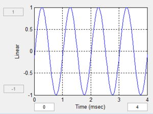

SineGen / SineSmoothedGen ![]() |

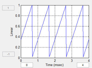

Sawtooth ![]() |

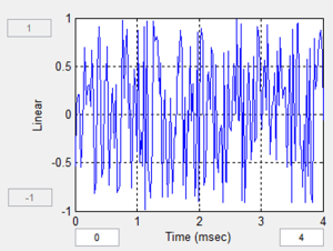

WhiteNoise ![]() |

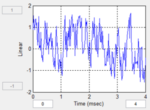

PinkNoise ![]() |

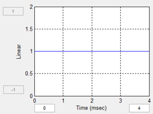

DCSource (outputs one steady value) ![]() |

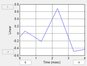

Randi ![]() |
