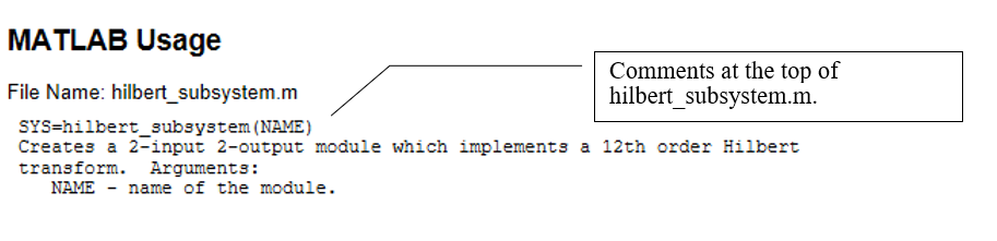

● The help comments at the start of the MATLAB M-file. [manual]

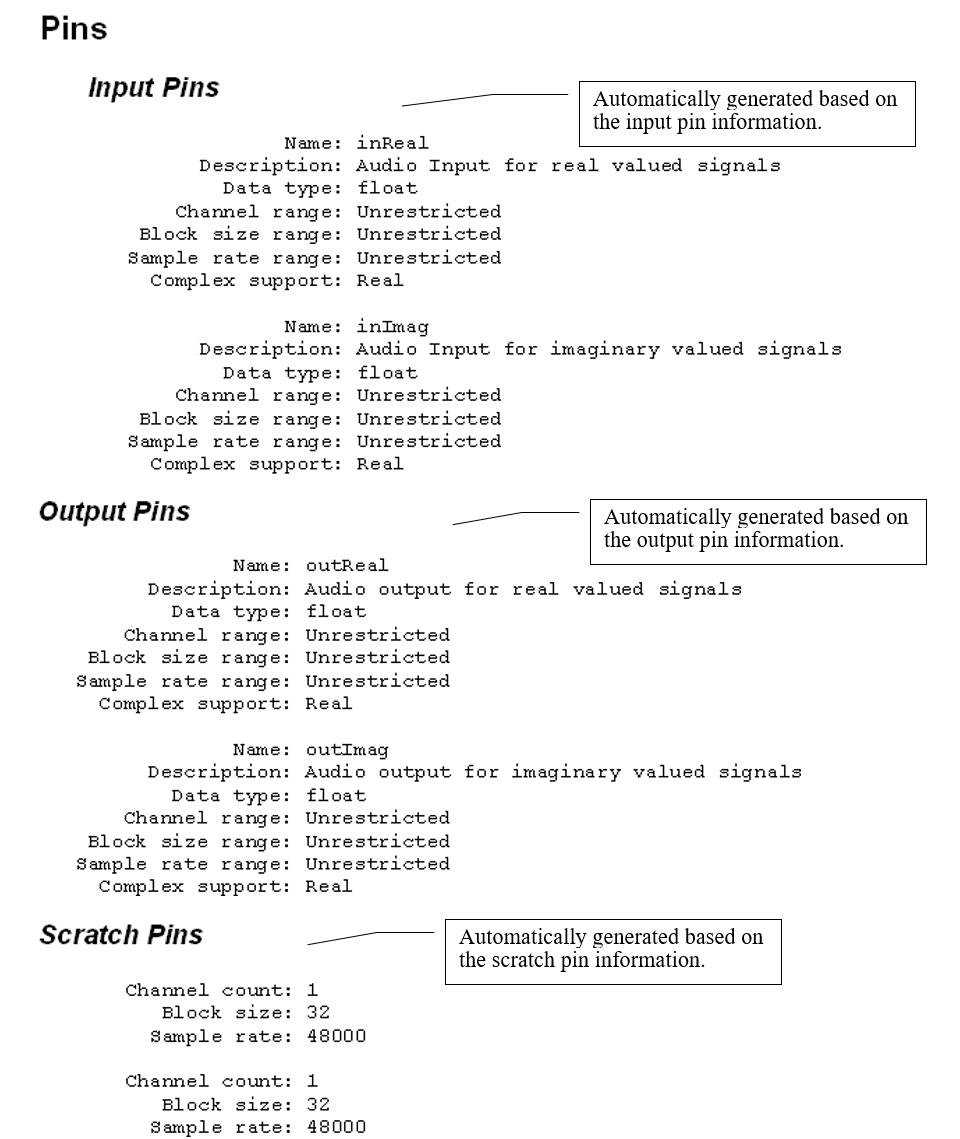

● Input, output, and scratch pins. [automatic]

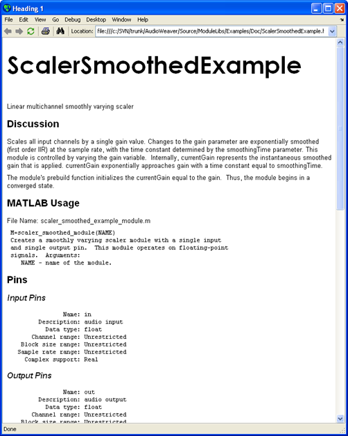

For example, to see the generated help for the scaler smoothed module, type
awe_help scaler_smoothed_example_module
at the MATLAB command line. The documentation appears (shown in the figure below).
Automatically generated documentation for the scaler_smoothed_example_module.m.

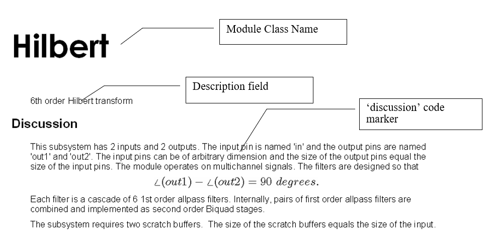

The module field.docInfo.discussion (or a code marker named 'discussion') contains the text which is inserted under the "Discussion" section of the documentation. The discussion should contain:
● A lengthy description of how the module operates.
● Whether the module has a fixed or variable number of pins.
● Scratch pin requirements and how the sizes relate to the sizes of the input and output pins. The automatically generated information lists out the scratch pin sizes, but the values shown are only based on the current module settings. The relationship between the scratch sizes and other pin sizes is not described in the automatically generated text.

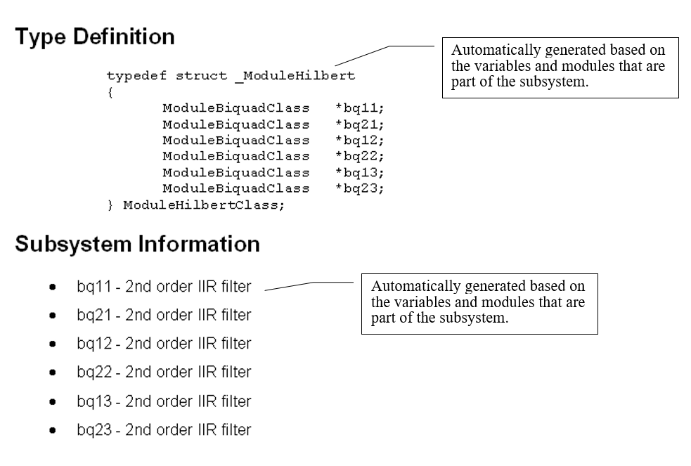

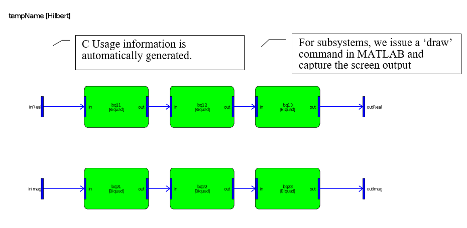

We now walk through the automatically generated help for the hilbert_subsystem.m and describe where each of the items shown is taken from.
Adding Equations to Documentation
Audio Weaver supports adding equations to the discussion section of a module. Equations are entered as text commands within the 'discussion' portion in LaTeX format. Equations must be enclosed between dollar signs. For example, $\angle(out1)-\angle(out2) = 90~degrees.$ is expanded to ∠(out1) - ∠(out2) = 90 degees in the document. If you are new to LaTeX, there are many good references available online.
