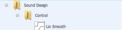

The LinSmooth module can be found in Sound Design/Effects folder or by using the search window in the module browser. It is called “Lin Smooth”.
Figure 1. Location in Module Browser

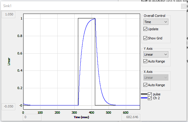

The modules with smoothing built-in use a one-pole IIR filter whose rise-time is defined as the time for the output to go from 0% to about 62% when the input goes from 0% to 100%. The rise and fall times for this type of filter are the same. The shape of the transition is exponential.
In the example below, the smoothing time is set to 20 msec.
  • Black: lnput signal
  • Blue: Smoothed signal
Exponential smoothing

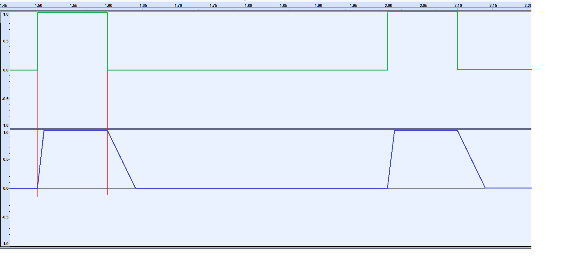

The LinSmooth supports individual slope control for increasing (TimeUp) and decreasing (TimeDown) levels.
  • Green: LinSmooth Input
  • Blue: LinSmooth Output
Settings:

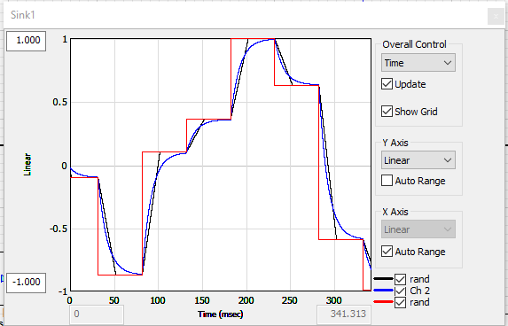

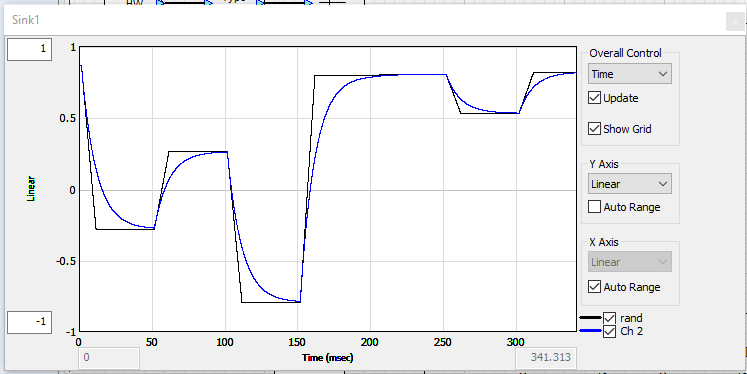

First, let’s set the smoothing times for both modules to 10 msec.
  • Black: LinSmooth output
  • Blue: ScalerV2 output showing exponential smoothing
  • Red: Random input

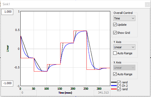

In the example below, the LinSmooth’s up and down smoothing times are set to 20 msec. The Scaler’s smoothing time is set to 10 msec. The two controls track more closely (which may or may not be your goal).
  • Red: Random input

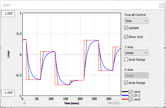

In the example below, the LinSmooth’s up smoothing time is 10 msec and the down smoothing time is 30 msec. The Scaler’s smoothing time is set to 10 msec.
  • Red: Random input

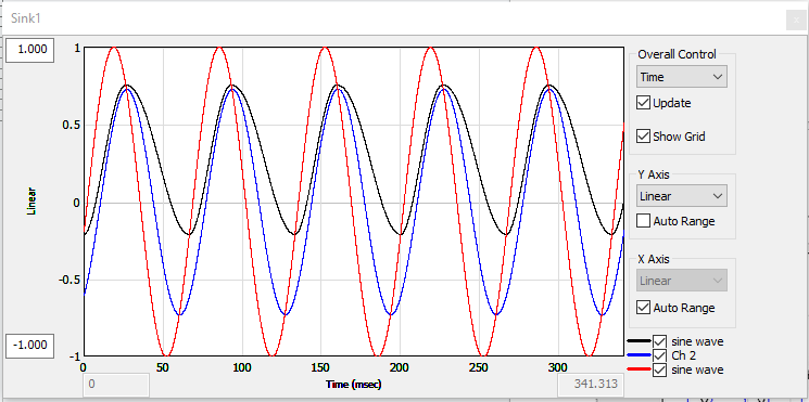

You can also use LinSmooth to change the shape of continuous signals such as sine waves. This example shows a 15 Hz sine wave. Note that the input sine wave (red) goes from -1.0 to 1.0.
  • Blue: through the exponential smoothing of the ScalerV2 (which acts as a low pass filter, attenuating and shifting in phase, but doesn’t change the shape).
  • Black: through a LinSmooth module with Up time = 10 msec and Down time = 30 msec. The signal is attenuated and shifted in phase, but its shape has been changed as well. The change in shape will increase with the sine wave’s frequency. This introduces harmonics into the result and is a form of distortion.
