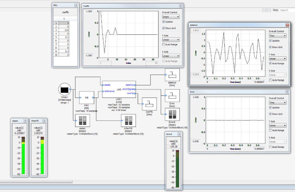

The LMS filter predicts the FIR of a system whose transfer function is not given. It’s input and output adapt or “predict” what the system response is. Filter weights are updated over time based on mu speed, higher numbers being the faster update speed. Higher numtaps give higher chance to converge with the optimum filter weight(meaning less error). The error can be tracked realtime with the errorSignal output. The module comes with an option to output the predicted “coeffs”. The following system shows white noise being ran through a 10 point FIR. The LMS will predict the FIR coefficients, and sinks will display the error and coeff function.
This sink shows the coeff prediction.
The LMS is trying to predict this FIR response.
The Error2 display shows a value of -125 dB, which means that our signal is very accurate. The sink to the right displays this as well.

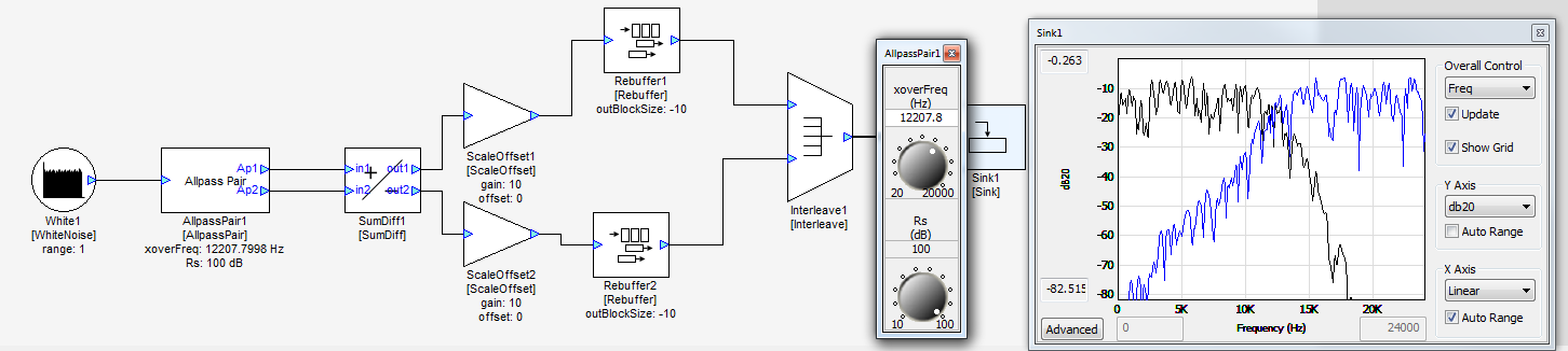

Allpass Pair
The Allpass Pair module creates a pair of allpass filters with the special property that their sum and difference form a doubly complementary highpass-lowpass filter pair. When used in conjunction with the Sum and Difference module (available in the Math folder) this Allpass Pair module can be used to construct more complex structures such as N-way crossovers and filter banks. The following design mixes one channel of white noise into two “bands” of white noise using this technique. The sink is an FFT showing the frequency response of the signal.

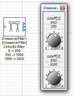

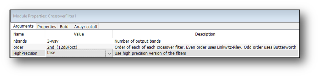

Alternatively, use the crossover module which contains all of the needed filters. The Crossover Filter module allows the user to set the type of filter, number of output bands, and filter order, specified in the module’s properties. Crossovers are used for separating different frequency bands of a signal. The example below demonstrates a crossover module being used to split a signal into a high band above 250 Hz and a low band below 250 Hz. The sum of the levels of the two bands is always 0 dB. As the input frequency changes near 250 Hz, one channel’s level drops and the other smoothly increases to compensate to 0 dB.
This is the same behavior as using two ButterworthFilter filters:
allows the configuration of 2 or more output channels. The module will then be drawn with 3 output pins. The top pin is the low frequency; the center pin is the mid-range, and the bottom pin is the high frequencies. The inspector shows two cutoff frequencies: between the low and mid-range; and between the mid-range and high frequencies. For example, if implementing a 3-way loudspeaker crossover, configure it as:

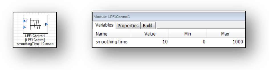

LPF Control
The LPF Control module is a time varying first order low pass with smoothly varying frequency based on the input pin.

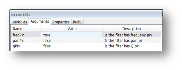

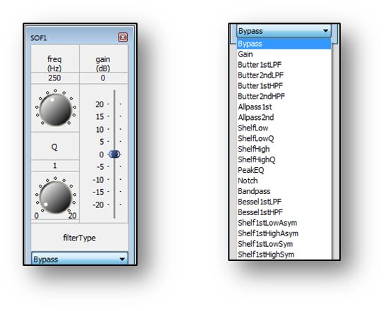

The SOFControl filter is built upon the SecondOrderFilterSmoothed module. It has a fixed filterType which is specified on the inspector. Under module arguments, specify which of the filter design parameters should be obtained via input pins:
Parameters which aren’t specified by input pins are specified via the variables and properties tab. The SOFControl module uses deferred processing to compute the filter coefficients. That is, the design equation is not executed every block. Rather, when the control data on the input pin changes, the module sets a bit in its instance structure which causes the design function to be called from non-real-time code. This reduces the peak CPU load at the expense of having a slower update rate. In typical applications, the module will update every few 10s of milliseconds. If updating needs to happen more quickly, then use the FOFControl module or the ParamSet module coupled with a SecondOrderFilterSmoothed module.

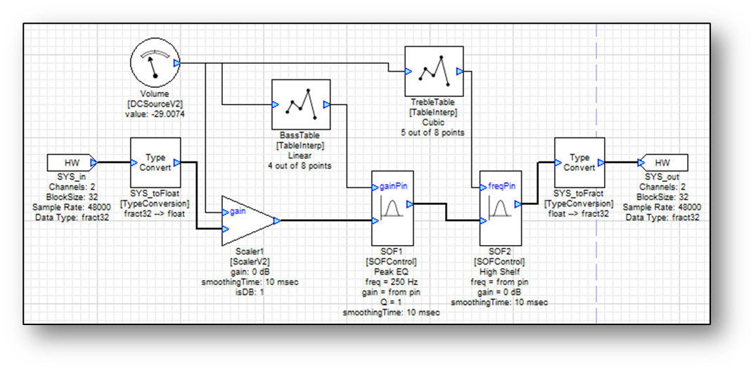

A very common use of the SOFControl module is within a perceptual volume control. As the volume of the system is reduced, overall spectral balance should be maintained. Due to the sensitivity of the human auditory system, low frequencies and high frequencies appear to drop off more quickly than mid frequencies. Thus, to maintain the overall spectral balance, boost low and high frequencies as the volume level decreases. The VolumeControl module accomplishes this with a fixed boost table. For finer control over the boost, use a TableInterp module together with a SOFControl filter as shown below. The control signal “Volume” specifies the listening level and ranges from 0 (loud) to -80 (soft). The lookup tables convert the Volume setting into low frequency and high frequency boosts which are applied using the SOFControl module. The low frequency SOFControl module implements a peaking filter at 40 Hz and the gain is taken from the control pin. The high frequency SOFControl module implements a high shelf in which the gain is taken from the control pin.

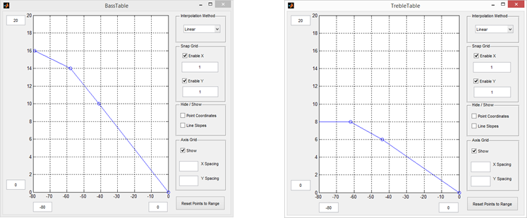

Example showing use of the SOFControl module in a table driven loudness control
Lookup tables used in the table driven loudness control example. The left table converts the volume setting into a bass boost and the right table does the same for the high frequency adjustment.

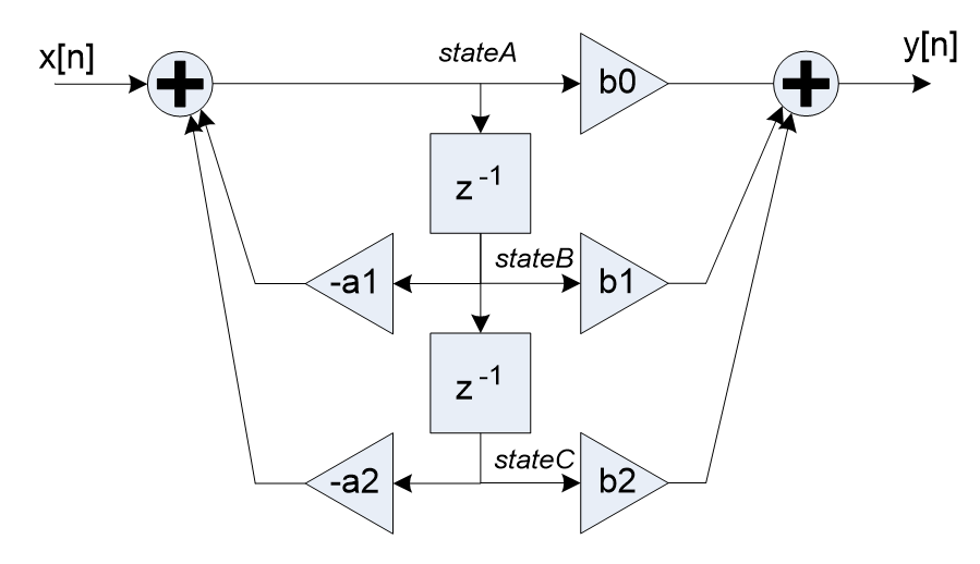

All Biquad filters including the DF2 have 5 coefficients. The advantage of the DF2 structure is that it requires only 2 state variables per filter as compared to 4 state variables for the DF1 structure.

The crossover filter module (XoverNway) is actually a subsystem consisting of multiple individual modules. The module properties give the option to construct the crossover using standard Biquads or high precision Biquads:

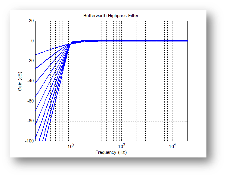

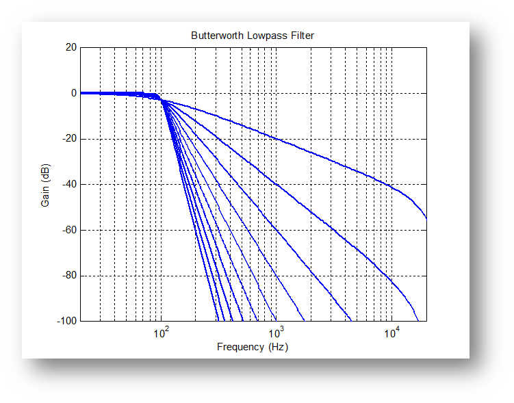

This module implements lowpass, highpass, or allpass filters using a Butterworth design. The filters have a gain of 0 dB in the passband and are then monotonically decreasing in the stopband. The filter order is specified under module properties and ranges from 1st order (\(6\,\text{dB/octave}\)) to 10th order (\(60\,\text{dB/octave}\)). The filter order can only be changed in Design mode. Specify the filter type on the inspector (lowpass, highpass, or allpass) as well as the cutoff frequency, in Hz. Since these parameters are on the inspector, the filter type and cutoff frequency can be changed at run-time. Unfortunately, the ButterworthFilter does not have coefficient smoothing and there may be discontinuities when coefficients are updated.
Butterworth lowpass filter frequency response as a function of filter order. The filter order goes from 1 st order (least steep line) to 10 th order (steepest line). The cutoff frequency is 100 Hz and the sample rate is 48 kHz
Butterworth lowpass filter frequency response as a function of filter order. The filter order goes from 1st order (least steep line) to 10th order (steepest line). The cutoff frequency is 100 Hz and the sample rate is 48 kHz
Butterworth high filter frequency response as a function of filter order. The filter order goes from 1 st order (least steep line) to 10 th order (steepest line). The cutoff frequency is 100 Hz and the sample rate is 48 kHz
Butterworth high filter frequency response as a function of filter order. The filter order goes from 1st order (least steep line) to 10th order (steepest line). The cutoff frequency is 100 Hz and the sample rate is 48 kHz
