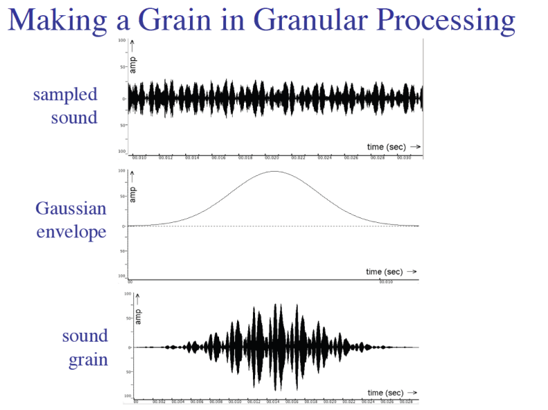

Figure 1. Making a grain
A Granulator generates individual grains by applying an amplitude envelope to a source such as a synthetic or sampled waveform. One criterion that has been used to classify different types of Granular Synthesis is the method used to generate the source for each grain.

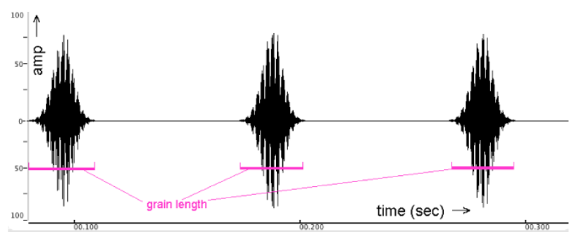

Grain Length
Figure 2. Grain Length
Grains are typically between 10 and 100 msec in length.
In order to be heard as a pitched event, the minimum length is 13 msec for high frequencies and 45 msec for low frequencies.
Lengths greater than 50 msec create the impression of separate sound events.

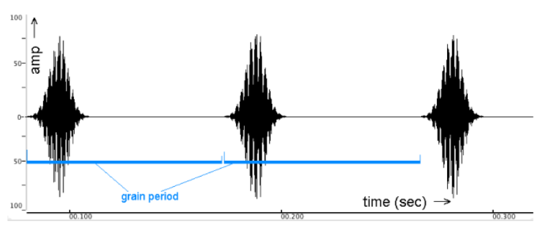

Grain Period or interonset time
Figure 3. Grain Period
Grain period is typically randomized in order to avoiding any periodicity. Because grain duration and grain period are varied independently, the period may occasionally be shorter than the duration causing consecutive grains to overlap and produce a smoother texture.

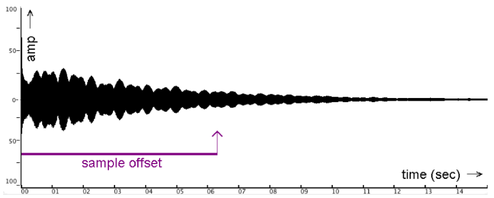

Sample Offset or Play Position
Figure 4. Sample offset
Start point of the grain, located within the sample (aka “Position”)

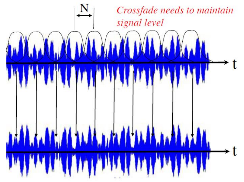

Grains can be extracted from sound file every N samples to reconstruct the original signal (N depends on windowing function).

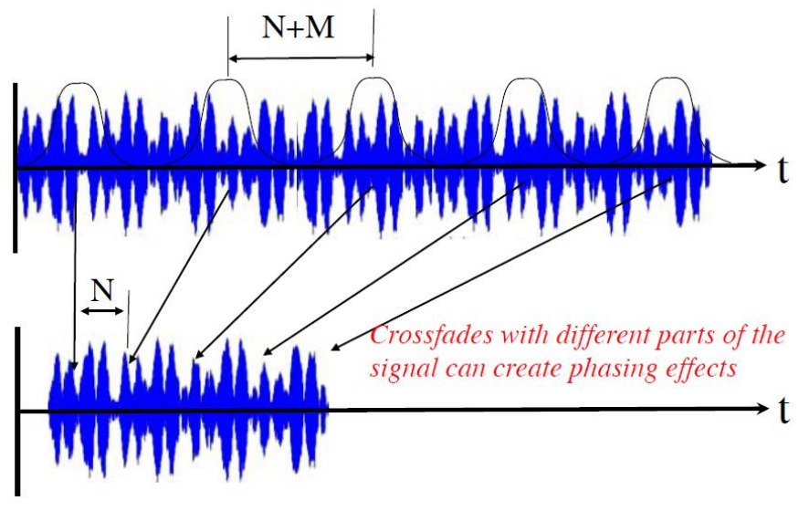

Figure 5. Crossfading

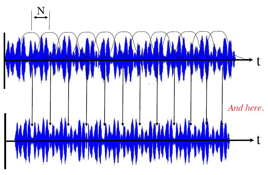

If grains are created every N+M samples and used to reconstruct the original every N samples, then time is compressed by a factor of (N/(N+M)) while retaining the original pitch.
Figure 6. Time compression

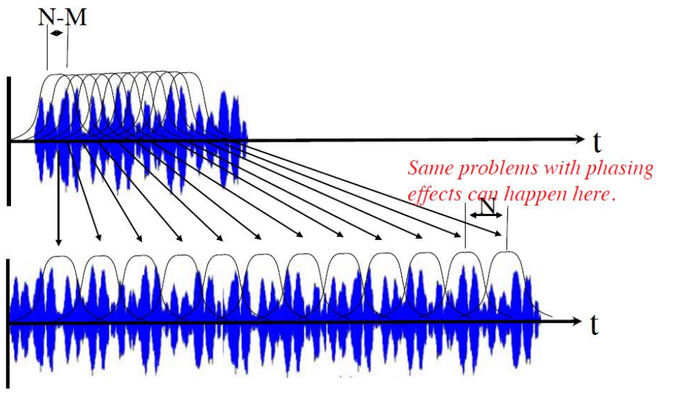

If grains are extracted every N-M samples and used to reconstruct the original every N samples, then time is stretched by a factor of (N/(N-M)) while retaining the original pitch.
Figure 7. Time Stretching

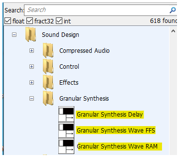

Three different variations can be found in the Sound Design/Granular Synthesis folder of the Module Browser.
Figure 9. Location in Module Browser
GranularSynthesisDelay: Uses a delay line to store samples from a real-time input stream.
Figure 10. GranularSynthesisDelay module
GranularSynthesisWaveRAM: Stored Sample Granular Synthesis, which generates each grain by reading sample values from a wavetable.
Figure 11. GranularSynthesisWaveRAM module
GranularSynthesisWaveFFS: Similar to the GranularSynthesisWaveRAM module except it extracts wave samples from an AWE Flash File System container.

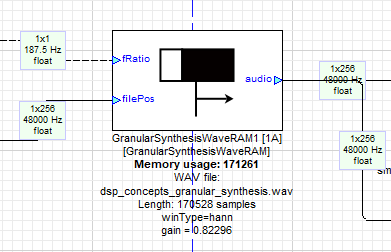

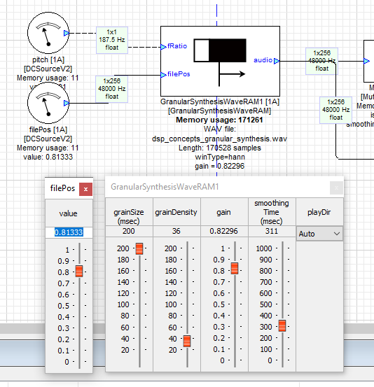

Scanning sections of a voice WAV file
Note: Place the WAV file into your AWE Server’s folder, e.g. C:\DSP Concepts\AWE Designer 8.D.1.2 Pro\Bin\win32-vc142-rel.
Depending on the source material, granular synthesis can impart a “robotic” quality on voices. The “filePos” control is moved while the layout is running in order to scan through the file section by section. Also experiment with the grain size and grain density controls.

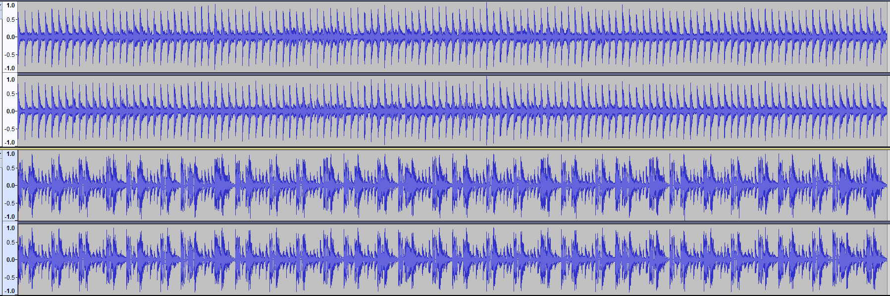

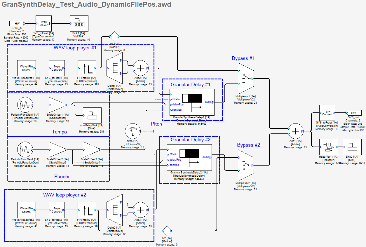

This layout contains two looping WAV files going into separate Granular Delay lines. One of the WAV files is a drum loop while the other one is a synthesizer melody. They are both about 22.5 seconds long at a 24 kHz sampling rate. By default they are synchronized already.
Figure 13. Rhythmic audio source files
The granulation parameters are set to give a continuous sound. By using a triangle wave to change the delay position (delayPos), time compression and expansion without pitch shifting can be accomplished. This results in an apparent increase of the tempo. This can’t be sustained forever though, as you will eventually run out of delay buffer to scan through. So, half of the triangle’s cycle results in a tempo increase, while the other half results in a tempo decrease.
Figure 14. Wave Scanning Example layout

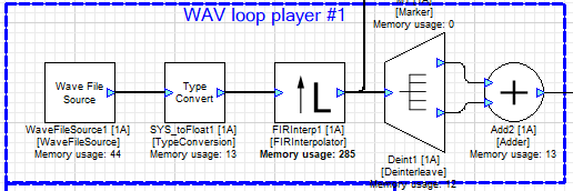

WAV loop player details
Figure 15. Wave Loop Player
The WAV loop player consists of a WAV file source, which outputs a fract32 to a typeConversion to float. The FIRInterp module converts the sample from 24 kHz to 48 kHz sampling rate. The DeInterleave separates the left and right channels which are added together to create a mono signal that goes on to the Granular Delay.

The apparent shift in tempo is created by slowly changing the start point of grain playback using a slow triangle WAV LFO (Low Frequency Oscillator) that goes between 0 and 1, corresponding to the full length of the delay.
Figure 16. Tempo Shifting LFO
When the value of delayPos is increasing, you will hear the tempo decrease because more space is being put between successive grains. When the value of delayPos is decreasing, you will hear the tempo increase.
Figure 17. Part of the triangle LFO cycle

While this layout allows you to change the apparent tempo of a sample without changing its pitch, a separate control for pitch is also available.
Figure 18. Pitch control
Dual Panner
Figure 19. Panner LFO
PeriodFuncGen2 is outputting a triangle wave that nominally goes from –1.0 to 1.0. The first ScaleOffset shifts this to 0.0 to 1.0, while the second ScaleOffset inverts that to 1.0 to 0.0, so that the two granular delay lines pan opposite each other. The rate and width of the panning can be adjusted using PeriodicFuncGen2’s inspector.
Figure 20. Panner LFO controls
Bypass
Each Granular Delay module has a bypass multiplexor so you can compare its output easily to the original WAV file. Unselect the “index” in the Multiplexor’s inspector to enable bypass.
Figure 21. Bypass multiplexor

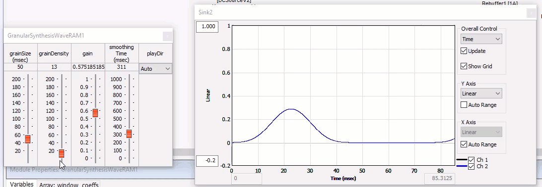

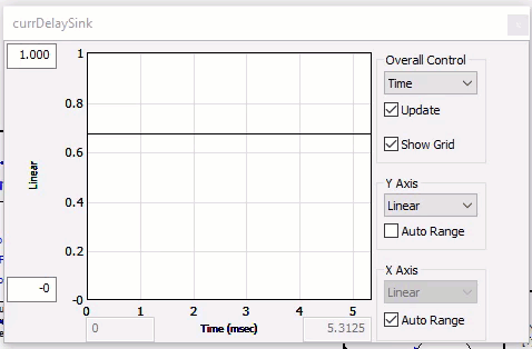

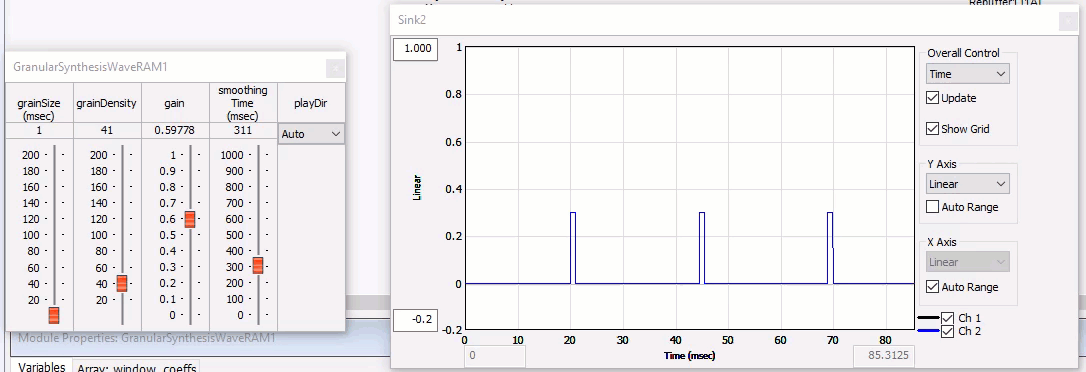

By using a WAV file that just includes a fixed level, you can see the grain envelopes at the module’s output. Open the layout file, then open Sink2 and GranularSynthesisWaveRAM1’s inspector. Change the Grain Size, Grain Density, and gain to observe the grain shape and distribution. The pitch and filePos controls do not have any effect.
Changing grain size
With a small grain size, the grains do not overlap and you see the full window shape. As the grain size increases, so does overlap and the level goes up. Depending on the window type used, other interesting overlap effects can be seen.
Changing grain size using Blackman-Harris window
The Blackman-Harris window fills in and then goes up smoothly.

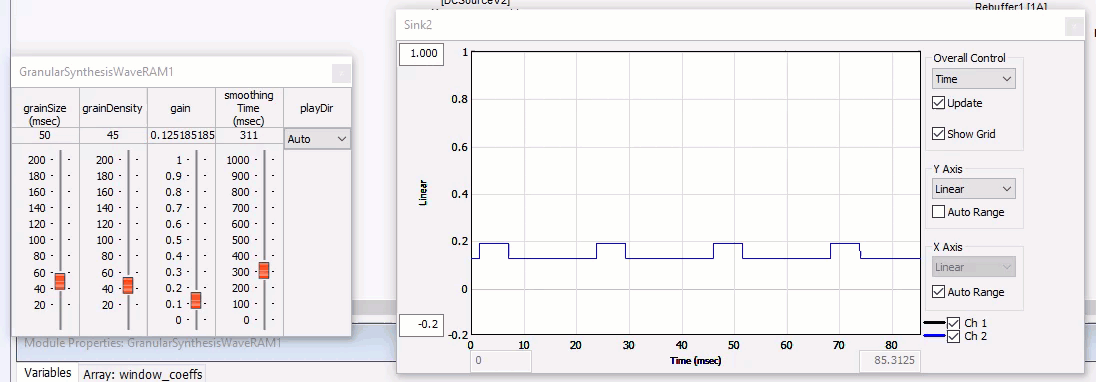

Changing grain size using Rectangular window
The Rect(angular) window, on the other hand, does not overlap smoothly and goes up by a series of jumps. Note the use of the gain control to set the maximum amplitude of a grain envelope including overlap effects.

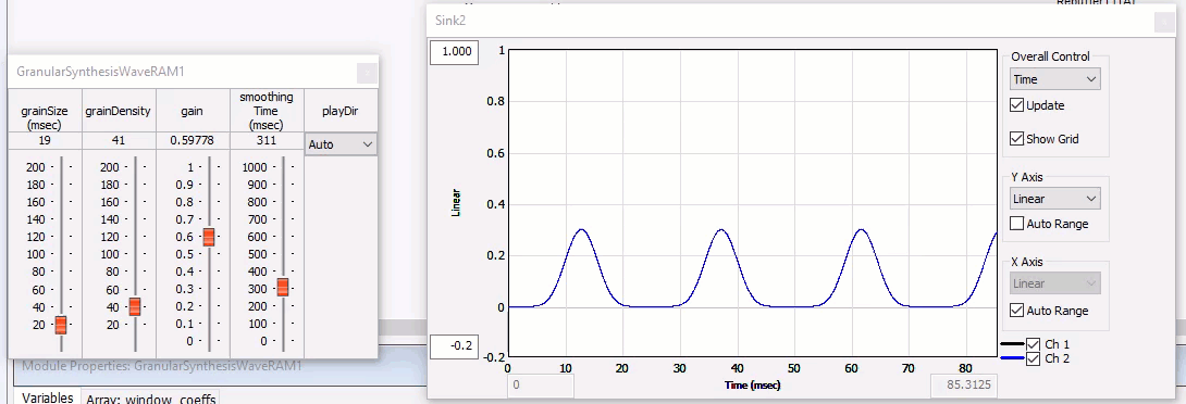

Changing grain density
Changing grain density using Blackman-Harris window
Changing grain density using Rect window

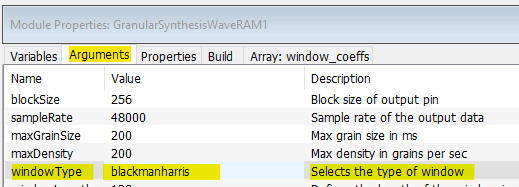

Selecting a different window type
This can only be done in Design mode. Access the windowType on the Arguments tab.
Arguments
Windows Type options
