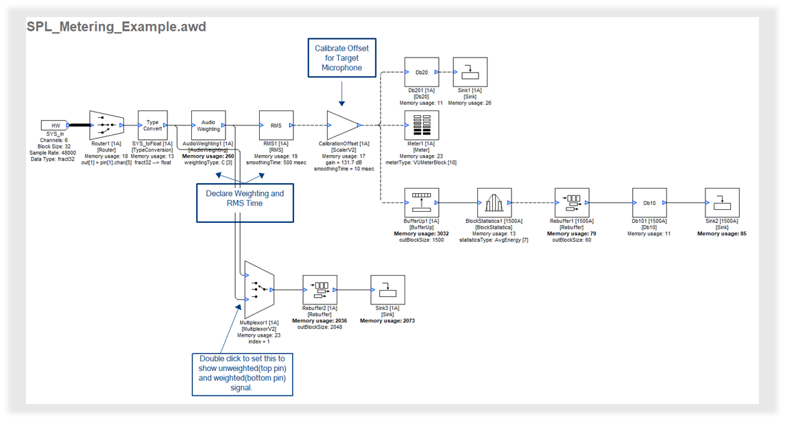

The SPL meter guide includes instructions for using the SPL_Metering_Example.awd which demonstrates concepts of audio weighting, smoothing with RMS, and converting between dBSPL and dBFS including some best practices for viewing signals in real time. It can be found within your Audio Weaver installation, in the “Examples” folder.

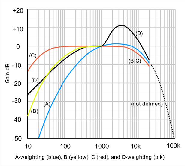

Audio weighting is used to account for the relative loudness perceived by the human ear at different levels.
  • A-weighting emphasizes the speech band and ignores low frequencies
  • C-weighting includes low frequencies
There can be a significant difference between measurements taken with A versus C weighting, especially if the source content contains lots of low frequency content (bass notes, road noise, etc.)
Figure 1 – Audio Weighting
Best Practices
  • Use A-weighting when verifying microphone specifications, as this is the weighting used when manufacturers write the specs.
  • Use C-weighting when doing Voice UI level measurements. C- weighting reflects how hard the algorithm has to work.

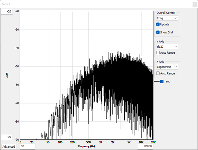

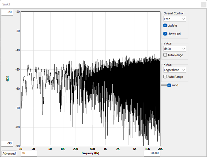

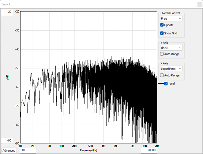

The following figures reflect different representations of white noise when various weighting is applied:
Figure 2 – Flat Weighting
Figure 3 – A Weighting
Figure 4 – C Weighting

Viewing the signal
Once the RMS is calculated, the design uses a dB20 module to convert from linear amplitude units to decibels, allowing us to view the smoothed signal as dbFS.
To graph the input signal over time with a Sink module, a BufferUp module is used to create a larger sample block to then create an average using the BlockStatistics module. BlockStatistics outputs a single sample block size, so that must be converted back to a larger block size in order to draw a graph. The design then converts from energy to decibels using a dB10 module (since we are transforming a quantity that relates to energy, not amplitude) and outputs to a SinkDisplay.
Figure 5 – Viewing the Signal
Figure 5 – Viewing the signal

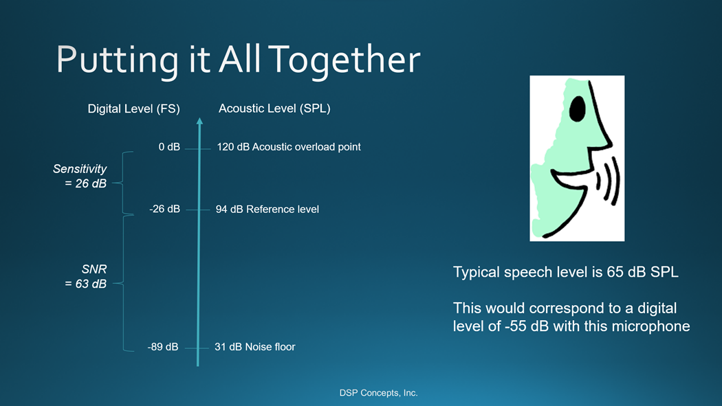

Decibels relative to Full Scale vs. dB SPL
dB relative to Full Scale
When an analog microphone signal is converted to digital, units of decibels are represented as decibels relative to Full Scale, where 0 becomes the maximum output signal before digital clipping occurs, therefore all peak values will be negative numbers. For example, a signal that reaches 50 percent of the maximum level would be represented as -6 dBFS, and so on.
Calibrating for SPL

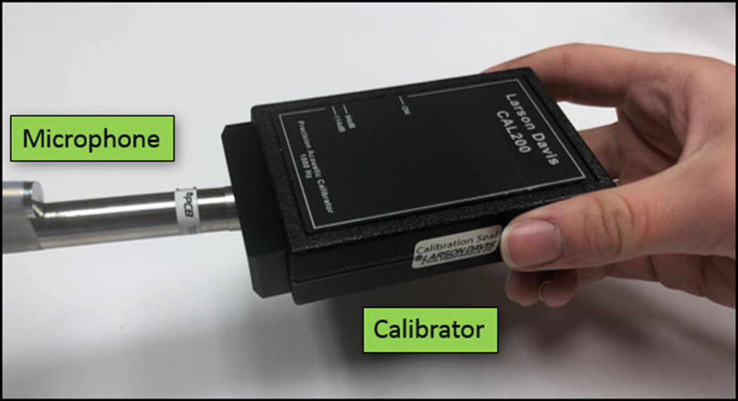

When measuring source content with a microphone, it is necessary to convert from dBFS to dBSPL or vice versa in order to understand what the acoustic Sound Pressure Level would be to human hearing. To make this conversion, we must calibrate the microphone with a known reference level.

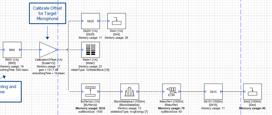

In the SPL_Metering_Example.awd there is a calibration offset scaler which should be adjusted so the dBFS reading on a meter module while the calibrator is connected to the microphone equals the sensitivity of the microphone.
For example, most calibrators will emit a 1000Hz tone at 94 dB SPL, which is the reference level used when a manufacturer calculates a microphone's sensitivity. Therefore if a microphone's sensitivity is listed as -26 dB, that translates to 94 dBSPL. 1000 Hz is used since it is a frequency that is unaffected by different weighting. Once calibrated, we know that if the meter reads -26 dB, it is equal to 94 dBSPL.
