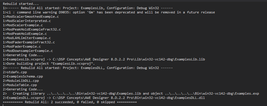

  1. Rebuild the solution to recompile everything. Successful output is shown below.

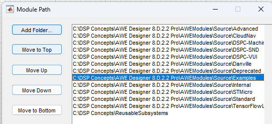

  1. Confirm that the Examples folder is in your module path (File->Set Module Path).

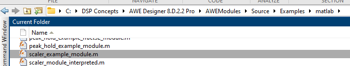

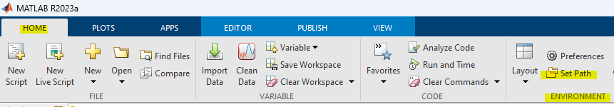

Make sure that the module’s “matlab” folder is either the current folder, or in the MATLAB path.
or
We’ll demonstrate the Scaler Example module.
Open the file “scaler_example_module.m”.

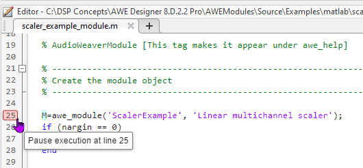

To add a breakpoint to your MATLAB code, click on the line number. Add a breakpoint on the “awe_module” instruction line.

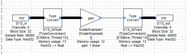

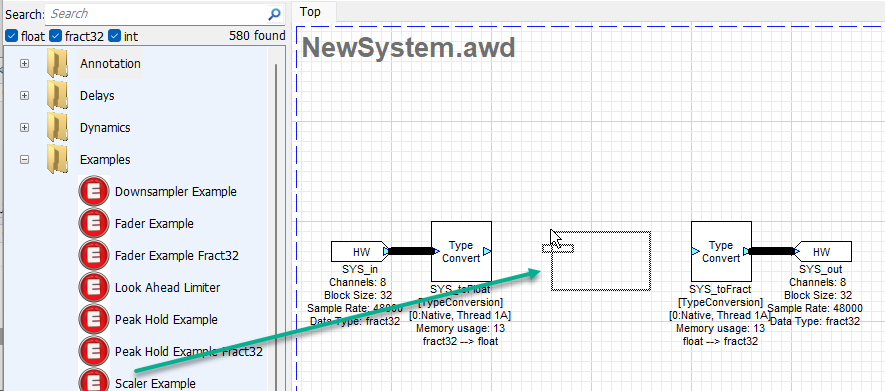

In this example layout, we have started by removing the deinterleave and interleave modules from the default layout. Find the “Examples” folder in the Module Browser and drag a Scaler Example module into your layout.

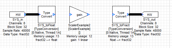

Complete the layout as shown:
Now build and run the layout.

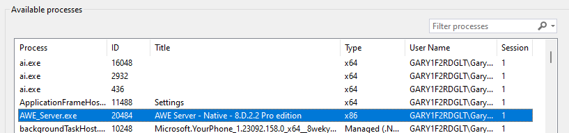

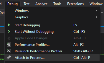

In VS2019, select “Debug->Attach to Process”.
Choose “AWE_Server.exe” from the list, then click on the “Attach” button.

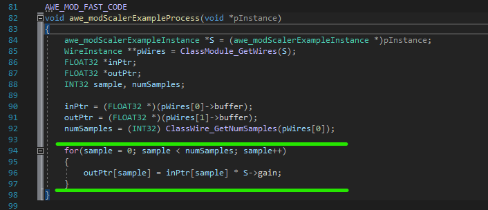

Run your layout. You should hit the breakpoint on the awe_modScalerExampleProcess() function.
The red dot indicates the breakpoint while the yellow arrow shows the next line that will be executed.
Use VS2019’s step/continue controls to trace through the code.
Since we interrupted the Processing() function, AWE Designer (the GUI/client) usually loses communication with AWE Server. You’ll just return to design mode with no error or warning in this case.
However, AWE Server is still running (unless a bug caused it to crash) and you can hit the Process() function again and again. Each pass through the Process() function processes one block’s worth of audio data.
The green lines highlight the inner loop which processes all samples in the block one by one.

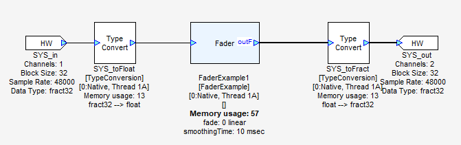

Start a new layout and remove the DeInterleave and Interleave modules.

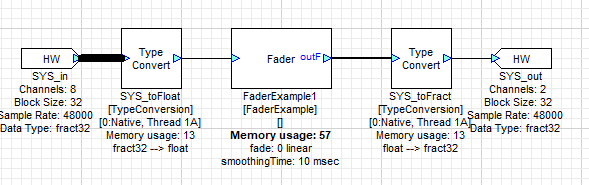

Drag in the Fader Example module and complete the layout as shown.
Set numChannels on the input pin to 1.

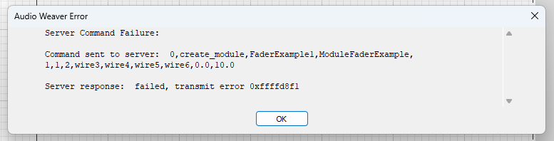

Build and run the layout. This time, we see a more detailed error when we hit the breakpoint.
AWE Server is still “there”, but we have stopped it, so the Designer Application times out. This is all normal.
