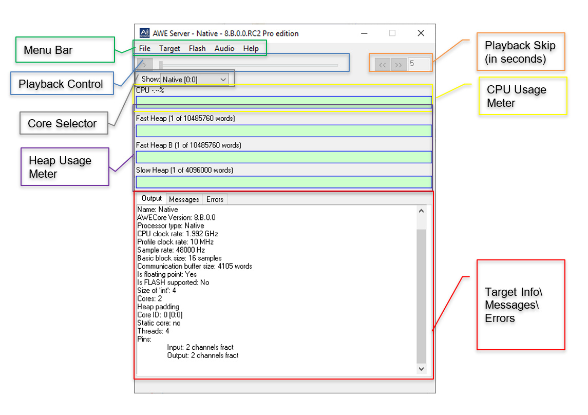

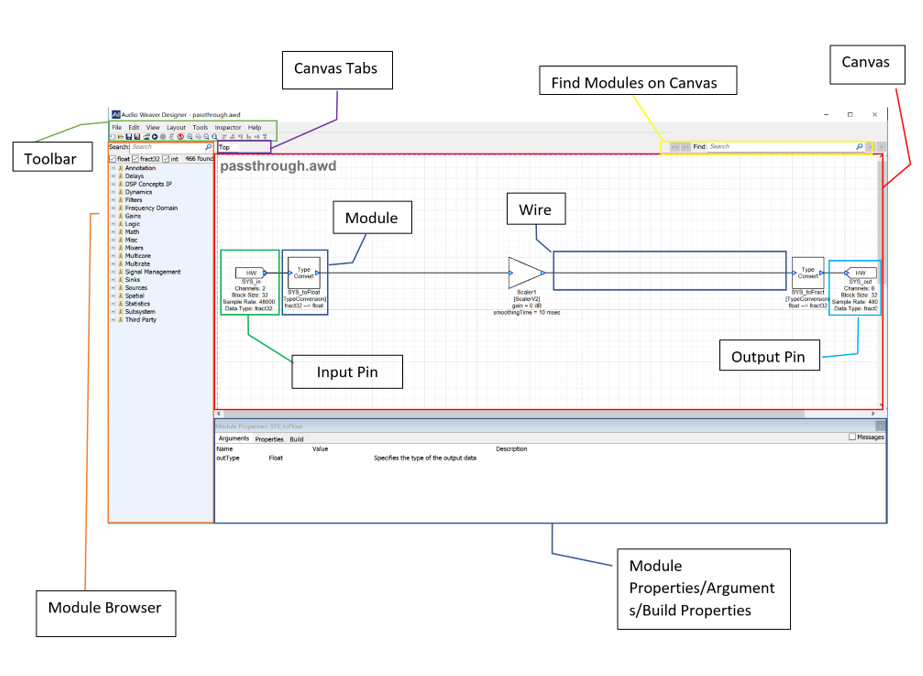

On start-up, AWE Designer launches two primary GUI’s that are used to create and run audio processing systems on hardware. The Audio Weaver GUI contains the canvas and modules needed to create the signal processing layouts, while the AWE Server GUI handles most of the target and audio IO interactions. By default, AWE Server is connected to the Native (PC) target. See the annotated diagrams below for descriptions of the layouts of the two GUI windows.
Audio Weaver Annotated Diagram
Server Annotated Diagram

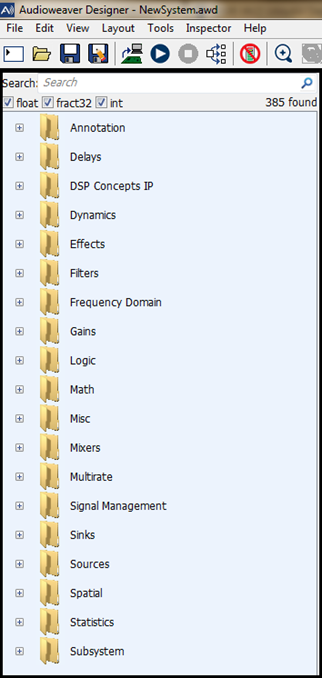

  1. Modules are organized into libraries. Use the checkboxes “float” “fract32” and “int” to filter based on your appropriate processor. If you know the name of a module, use the search feature.
    1. The module browser, seen to the right, is organized based on module functionality. Expand each section to see the individual module options.

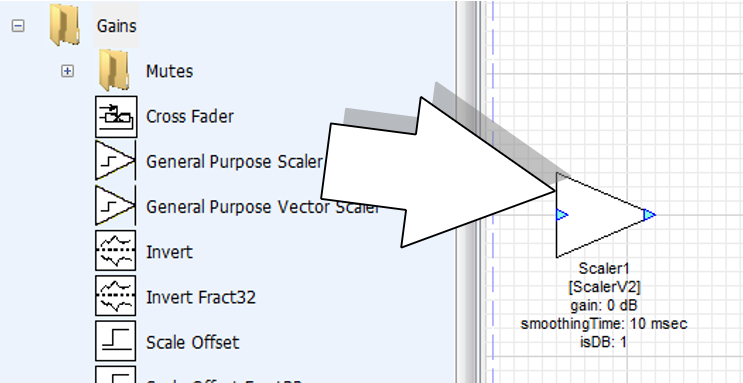

  2. Drag and drop modules into the layout window

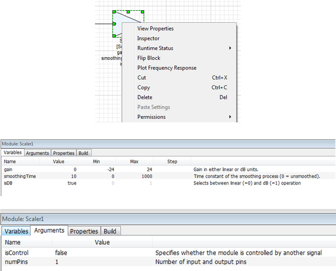

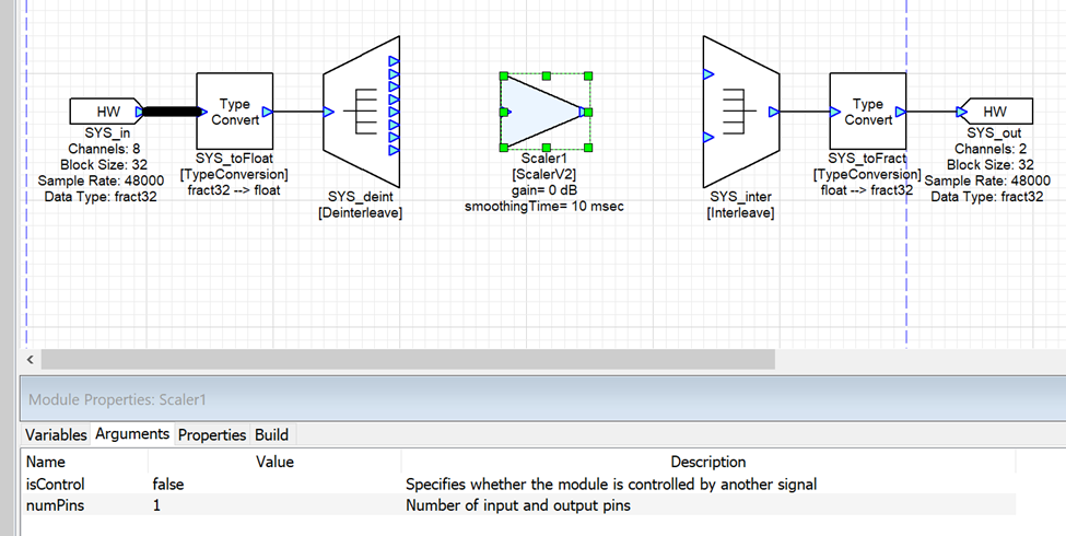

    1. As you add new modules to the layout window, the ‘Arguments’ tab of the module properties will be shown on the bottom of the window. Here you can configure the module’s arguments: the properties that control how the module behaves, but that cannot be changed while the audio path is active.
    1. You can prevent the GUI from automatically showing a new module’s argument tab by unchecking “Show New Module Arguments” under File->Global Preferences.
    2. You can always configure a module’s properties by right-clicking on it.

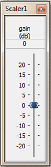

    1. Inspector – Control any tunable parameters. Use at design time or tuning time.
    2. Module Runtime Status – Activate, mute, or bypass a module.
    3. View Properties (Variables) – Change the range of sliders and knobs
    4. View Properties (Arguments) – Change at design time only. Configure items, like filter order, maximum delay time, or number of pins, which affect memory allocation or wiring

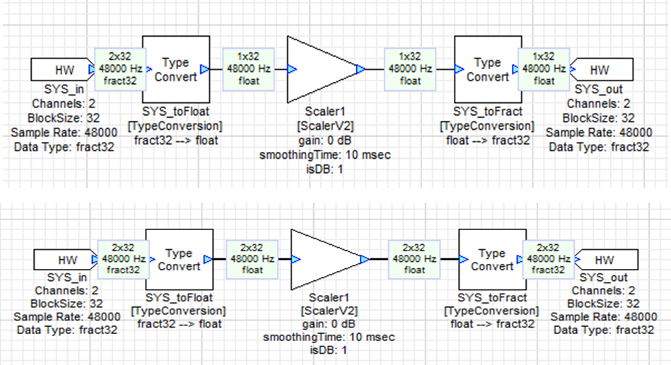

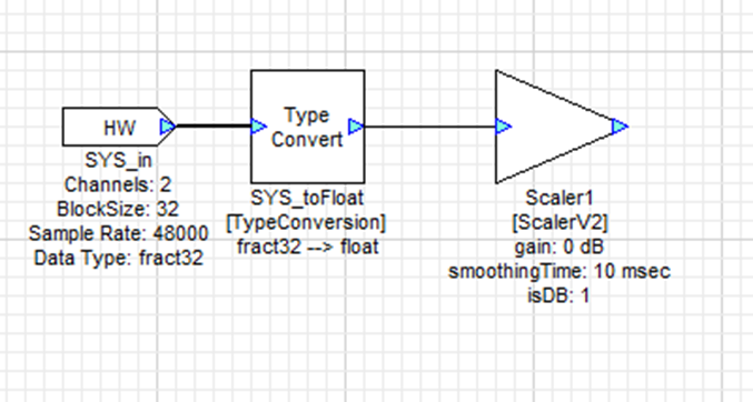

  3. Wire your modules together by clicking your mouse on the output pin of a module and dragging it to the input pin of the next module. Note that a design will not run if any input pins are unconnected, but output pins may be left unconnected.
  1. Redraw (Propagate Changes) to update wiring information

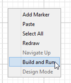

  1. Build and run to start real-time processing
  1. Tune in real-time using inspectors

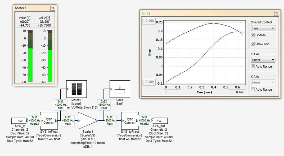

8. Add Sink and Meter modules to view signals. These are found in the Sinks folder.

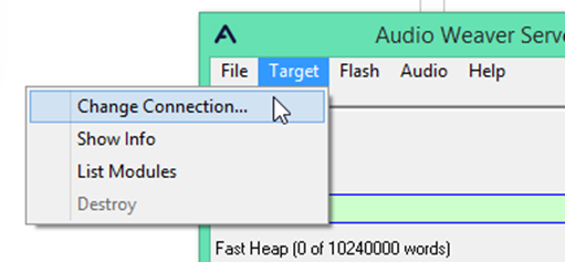

  1. Switch to an embedded target using Server->Change Connection

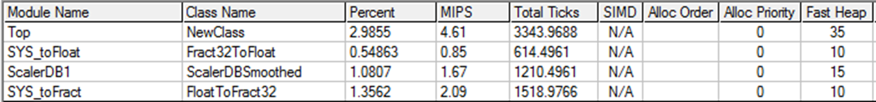

  1. Build and run to start real-time processing. Then profile the CPU load and memory using the ‘Tools>Profile System’ menu item. You can also check your overall CPU load / Heap usage with AWE Server.
