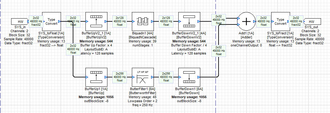

For example, the following layout includes 3 separate block times, 1A, 4A, and 8A. These numbers indicate the block time relative to the input pin at the input of the module in question.

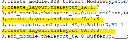

The generated AWS file includes 3 corresponding “create_layout” lines, as shown:

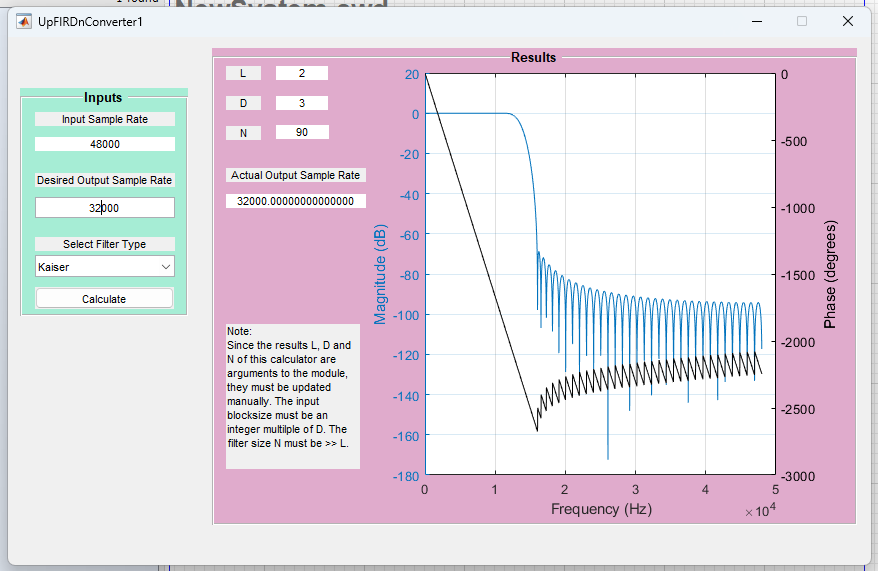

Drop the UpFIRDnConvertor into your design and open the inspector. This shows your input settings and the resulting filter parameters and performance.
Set the input and desired output sampling frequencies, the filter type, then click on calculate.
The filter parameters L, D, and N will be shown.
Choose different filter types to see the effect on the stopband attenuation and filter size.

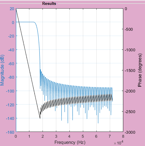

Kaiser filter

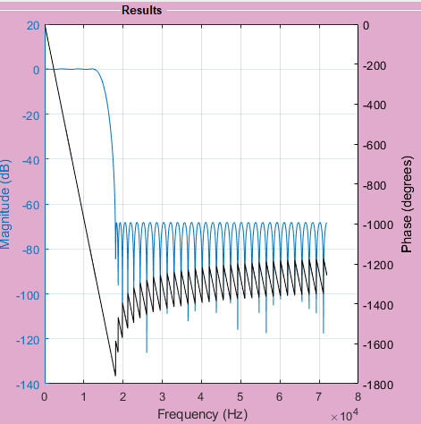

Parks-McClellan filter
In this example, if we had an input block size of 32, we could not implement a target sample rate of 32000 Hz properly as D needs to be a factor of the input block size.
However, with an input block size of 48 bytes, 32000 Hz would be supported as 48 = 16 * 3.
Use the calculated values for L, D, and N to manually set the following Arguments for this Module:
