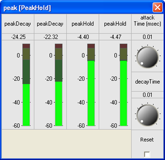

The next portion of the peak_hold_example_module.m file contains the inspector information. We only show the .peakHold variable since the others are similar or have already been discussed. The inspector drawn is:
This example has a stereo input. The first two meters shown are .peakDecay for both channels. The second two meters show .peakHold. The MATLAB code for drawing the .peakDecay meters is:
M.peakDecay.guiInfo.transposeArray=1;
M.peakDecay.guiInfo.range=[-60 10];
M.peakDecay.guiInfo.controlType='meter';
M.peakDecay.guiInfo.attribStr='mapping=db20';
add_control(M, '.peakDecay', 'topRight');

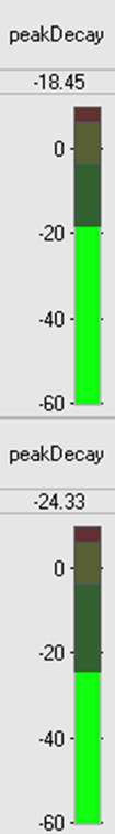

The .peakDecay variable is defined in MATLAB as a column vector. In this case, since there are two input channels, the vector is of dimension 2x1. When the meter control is drawn, the default behavior is to draw it as 2 high and 1 wide (this matches the MATLAB variable size)
This is not what we want — we want the controls to be side by side. To achieve this, the array of values has to be transposed to form a row vector. The statement
achieves this. Next, the range of the control is set, the variable is tied to a meter control, and finally, the control is instructed to convert from linear measurements to dB for display. This completes the MATLAB code for the .peakDecay inspector control. The .peakHold inspector specification is almost identical.

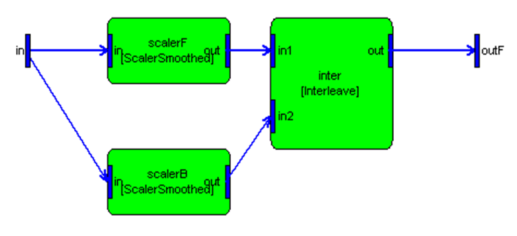

This example teaches how to create a new module class out of a subsystem and shows how to implement a custom bypass function. The fader module has a single mono input pin, a stereo output pin, and 3 internal modules:
The input signal is scaled by scalerFto yield the front channel and by scalerB to yield the back channel. The output pin is stereo with the first channel representing the front and the second channel the back. The scalers are set so that a portion of the input signal is fed to each of the front and back channels. The fader implements constant energy panning using a sine/cosine response.
The fader example is found in fader_example_module.m. As usual, create a subsystem and set its .name based on an argument to the function.
SYS=awe_subsystem('FaderExample', 'Splits a mono input signal into front and back channels with constant energy panning.');
if (nargin == 0)
    return;
SYS.name=NAME;
Add input and output pins. The input pin is a single channel without any restrictions on the blockSizeor sampleRate. The output pin is stereo without any restrictions on the blockSize or sampleRate.
PTIN=new_pin_type(1);
PTOUT=new_pin_type(2);
add_pin(SYS, 'input', 'in', 'audio input', PTIN);
add_pin(SYS, 'output', 'out', 'audio output', PTOUT);
Then add the modules to create the subsystem
add_module(SYS, scaler_smoothed_module('scalerF'));
add_module(SYS, scaler_smoothed_module('scalerB'));
add_module(SYS, interleave_module('inter', 2));
Then connect them together:
connect(SYS, '', 'scalerF');
connect(SYS, 'scalerF', 'inter.in1');
connect(SYS, '', 'scalerB');
connect(SYS, 'scalerB', 'inter.in2');
connect(SYS, 'inter', '');

The key lesson this example is the MATLAB code
SYS.flattenOnBuild=0;
This identifies the subsystem as one that is not flattened when building. That is, the FaderExample module class exists natively on the target. The Server only sends a single command to the target and the entire subsystem will be instantiated. The automatically generated constructor function is found in ModFaderExample.c and shown below. The constructor function allocates the base module and then allocates each of the 3 internal modules. The module is marked as requiring a total of 4 pins: 1 input, 1 output, and 2 scratch. These pins are allocated outside of the function and then passed in. By looking through the code you can see how the wire information is passed to each of the internal modules' constructor function.

Similarly, since this module is created out of a subsystem, there is no need to provide a processing function; it will be automatically generated by Audio Weaver. (Yes, a custom processing function could be supplied, but the generated one works fine.) The automatically generated processing function is shown in ModFaderExample.c. It simply calls the 3 processing functions for the 3 internal modules:
AWE_MOD_FAST_CODE
void awe_modFaderExampleProcess(void *pInstance)
  awe_modFaderExampleInstance *S = (awe_modFaderExampleInstance *) pInstance;
  ClassModule_Execute(S->scalerF);
  ClassModule_Execute(S->scalerB);
  ClassModule_Execute(S->inter);
The set function for the subsystem takes the high-level .smoothingTime variable and passes it down to each of the internal smoothed scaler modules. The function also takes the .fade variable and computes two separate gains using a sin/cos pan.
  awe_modFaderInstance *S;
  float arg;
  S = (awe_modFaderInstance *)pInstance;
  S->scalerF->smoothingTime=S->smoothingTime;
  S->scalerB->smoothingTime=S->smoothingTime;
  // Compute the front and back gains from the .fade setting.
  arg = (float)((1+S->fade)*PIDIV4);
  S->scalerF->gain = sinf(arg);
  S->scalerB->gain = cosf(arg);
  ClassModule_Set(S->scalerF, MASK_ScalerSmoothed_smoothingTime | MASK_ScalerSmoothed_gain);
  ClassModule_Set(S->scalerB, MASK_ScalerSmoothed_smoothingTime | MASK_ScalerSmoothed_gain);
  return(0);
The function sets the high-level variables of the smoothed scaler modules and then calls the set function for the module. The set function takes a pointer to the smoothed scaler module and also a bit mask which identifies the specific variables that were modified. In this case, we are setting the smoothingTime and gain fields of the modules.

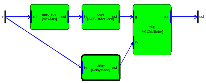

This example demonstrates some advanced code generation techniques. The look ahead limiter is a dynamics processor which applies a time-varying gain to a signal. The module m-file takes two arguments.
SYS=lah_limiter_example_module(NAME, MAXDELAY)
The first is the NAME of the subsystem and the second, MAXDELAY, is the maximum amount of delay, in milliseconds. MAXDELAY is used internally when allocating the delaymsec_module.m:
add_module(SYS, delaymsec_module('delay', MAXDELAY));
SYS.delay.currentDelayTime=MAXDELAY;
The compiled subsystem contains 4 internal modules:

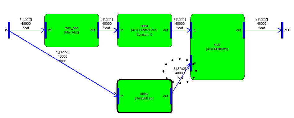

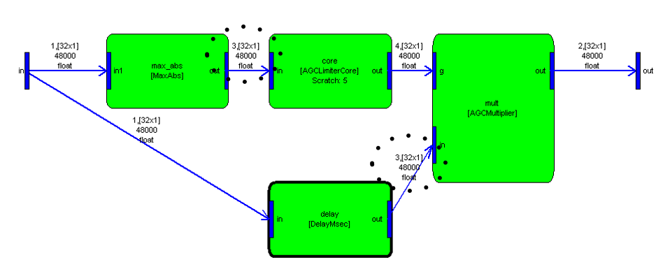

If look at the default subsystem including wiring information, we see:
By default, the input and output pins are mono and the system ends up using 3 scratch wires:
>> SYS=lah_limiter_example_module('LAH');
>> SYS=prebuild(SYS);
>> SYS.scratchPin
ans =
    [1x1 struct]    [1x1 struct]    [1x1 struct]
This subsystem is designed to operate on an arbitrary number of channels. However, the wire allocation shown above is only applicable when the input is mono. (To see this, consider the MaxAbs module. This module always has a mono output and is assigned to wire #3. The signal path through DelayMsec can be N-channel and is also assigned to wire #3). If this system is run with stereo inputs, then the wire allocation is incorrect and the audio processing will fail.
To fix this problem, force the system input pin to have 2 channels by default.
pinType=SYS.max_abs.inputPin{1}.type;
SYS.inputPin{1}.type.numChannels=2;
The pin still holds an arbitrary number of channels, but its default value is 2. When the subsystem is now routed, the wires will be allocated as:
The system now requires a total of 4 scratch wires, with a new scratch wire, #6 assigned to the output of DelayMsec. Furthermore, the buffer allocation is now general purpose and will work with any number of input channels.
