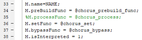

Complete the following edits to the MATLAB files of the module:
  1. Add the line "M.isInterpreted = 1;" to the _< modulename>module.m file (found in the “matlab” folder of your custom module) anywhere after the “M = awe_module(…” assignment in the “matlab/” directory of your custom module.

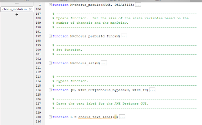

  1. Separate out functions contained in the _< modulename>module.m file to individual .m files.
Figure 2 - Before separating functions into unique .m files
Figure 3- After separating functions into unique .m files
NOTE : Confirm there is a corresponding .m file for any function being defined.
  1. Move any module function up to the same folder as the _< modulename>module.m
  2. Run “make__pack(1)” to create the updated .c and .h files.

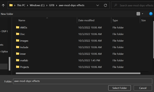

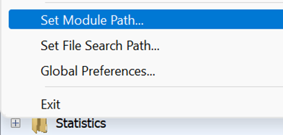

Set Module Path in Designer
In Designer Standard, go File- > Set Module Path, then click Add Folder, select your custom module folder, and click Select Folder. Your module should now show in the modules tab and load into Designer.
Figure 5- Add Module Path

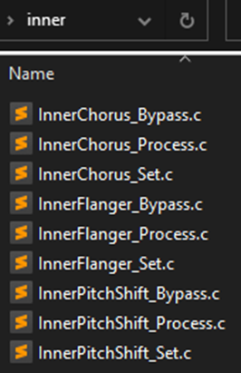

Not all files used to create a custom module are necessary to have present when running the compiled module. The Mod.c and inner.c files may contain sensitive source code, but can be removed from the file path before sending and the custom module will still work.
Figure 6 - Removing Source and Inner c files
