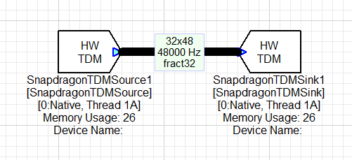

Input to Output Latency
This was measured by connecting the TDMSource directly to the TDMSink as shown below.
We measured the delay with an oscilloscope and the path included:
A/D → A2B → TDMSource → Copy → TDMSink → A2B → D/A
The latency varied based on the block size as shown below:
| Block Size (samples) | Total Latency (msec) | Analog Latency (msec) | Digital Latency (msec) |
| 12 | 1.6 | 1.1 | 0.5 |
| 24 | 2.1 | 1.1 | 1.0 |
| 48 | 3.1 | 1.1 | 2.0 |

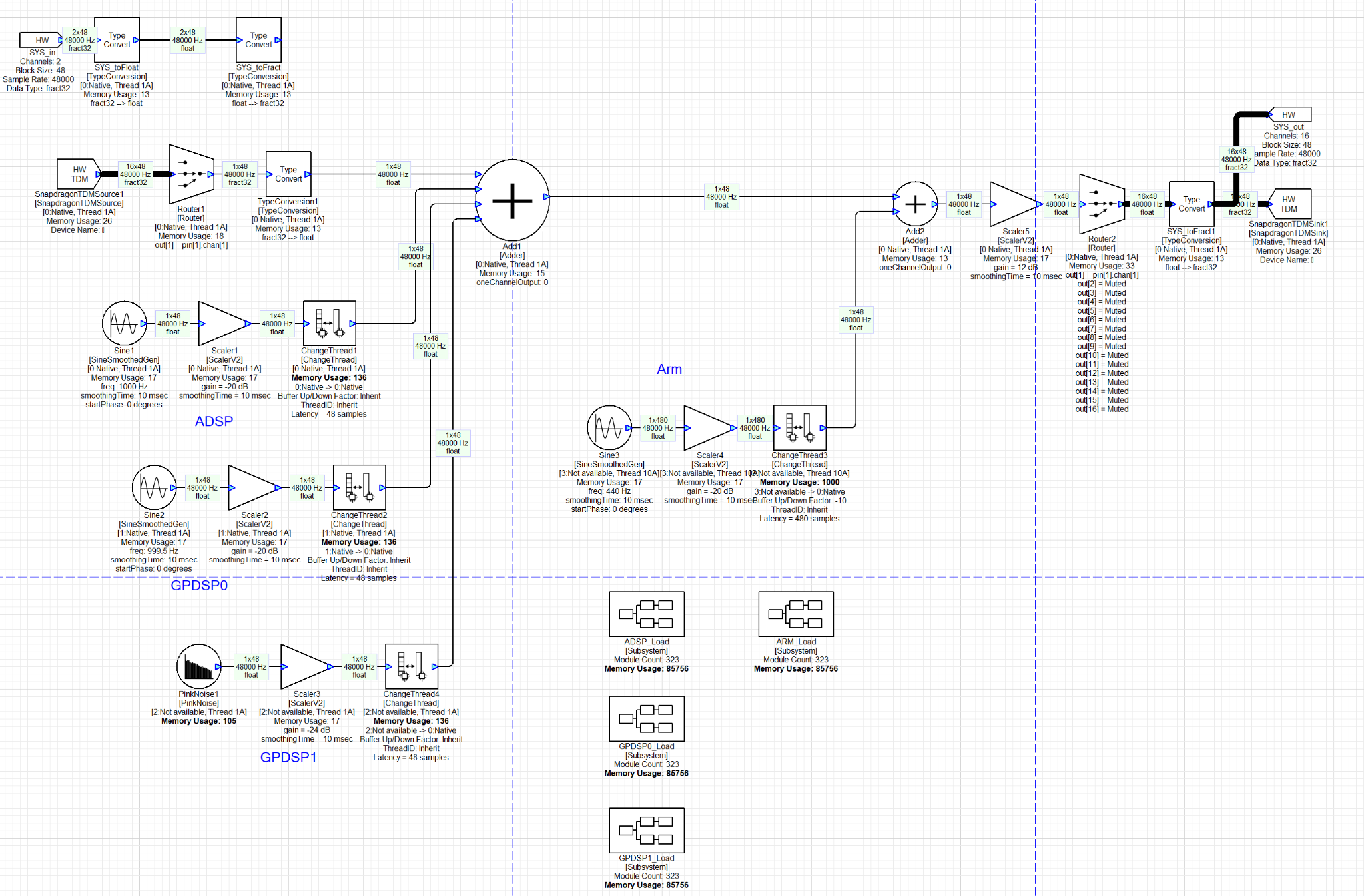

In release R4.0, we are not able to fully measure this KPI. However, we were able to measure the Audio Weaver contribution to the boot time. We instrumented the code and measured the time that the main() function was reached on the ADSP until the time that real-time audio interrupts started.
For the measurement, we used the file “SA8255_Early_Audio_Parallel_with_Load.awdâ€. This contains 1320 modules spread across all four cores. It also had a TDM input and TDM output port, and would generate audio on the A2B output. There was a signal generator on each core (sine wave or noise). The signal flow was designed so that you could distinguish the sound of each core and verify that each core was properly running just by listening. The top-level is simple and there were additional subsystems that would load up each of the cores.
All Hexagon DSPs are part of the early audio group while the Arm booted later. The combined AWB file was 335,760 bytes long and this was split into 4 separate AWBs, one per core:
SA8255_Early_Audio_Parallel_with_Load_0.awb [ADSP. 84,644 bytes]
SA8255_Early_Audio_Parallel_with_Load_1.awb [GPDSP0. 83,656 bytes]
SA8255_Early_Audio_Parallel_with_Load_2.awb [GPDSP1. 83,824 bytes]
SA8255_Early_Audio_Parallel_with_Load_3.awb [Arm. 83,680 bytes]

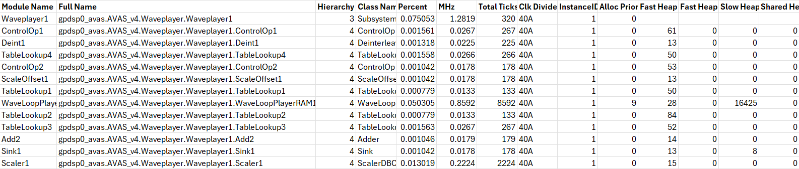

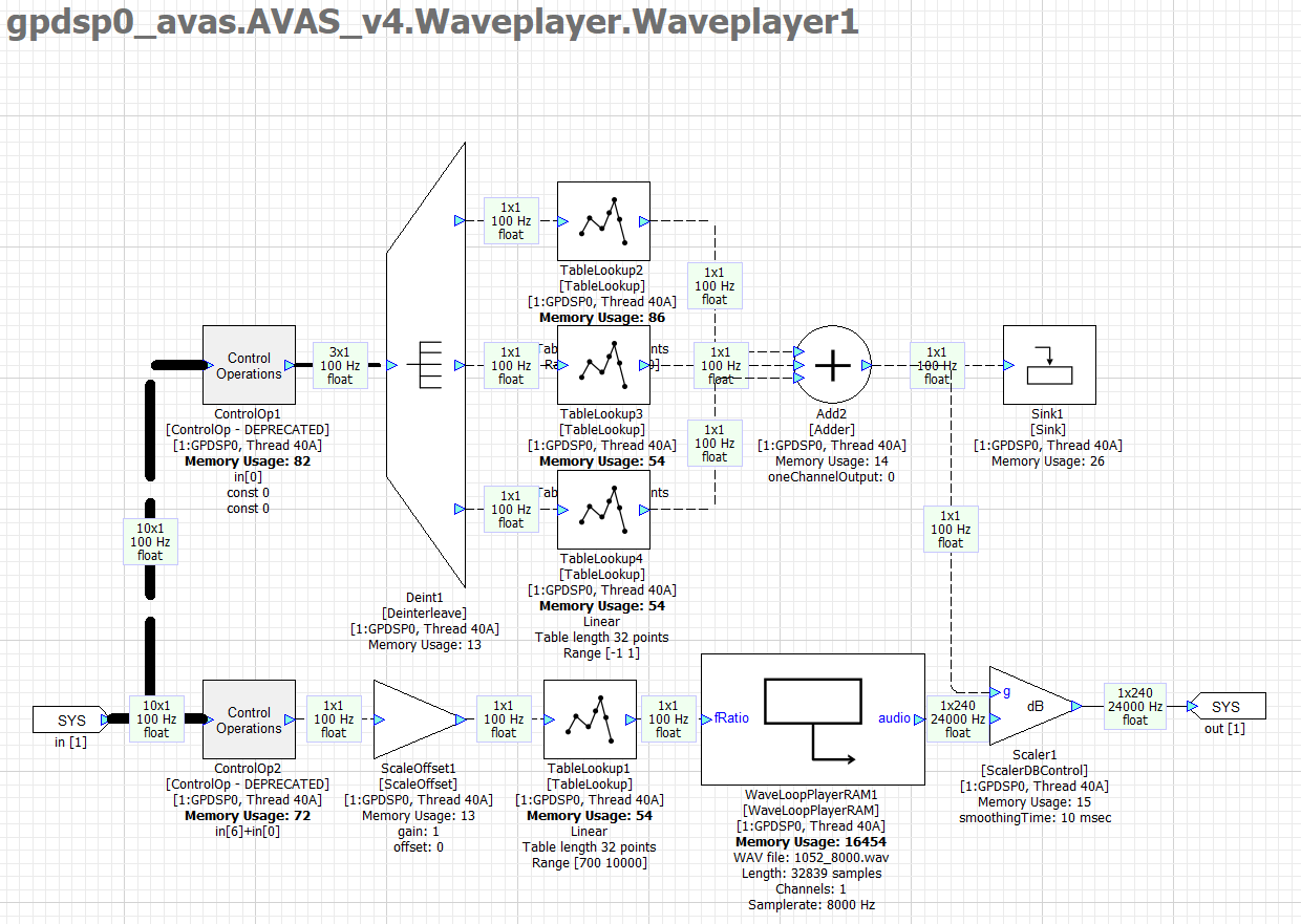

Wave Player Profiling
This measurement was performed on GPDSP0 on the 8255 ADP. The profiling was for a typical looping WAV player used in AVAS applications and all data is in RAM. This player has a variable playback rate and performs fractional sample interpolation. The output data was at 24 kHz and the subsystem for one wave player is shown below:
The total CPU load for this subsystem was 1.28 MHz (out of 1700 MHz). The detailed per module profiling is:

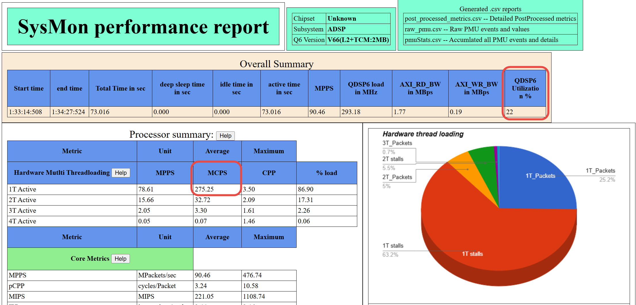

Comparing Audio Weaver Profiling and SysMon
Audio Weaver has sophisticated profiling features which can measure the system load and ensure that real-time performance is maintained. Profiling in Audio Weaver is based on measuring the elapsed time in real-time threads. For example, suppose that the audio processing occurs at 1 msec block size and that it takes 700 usec for this processing to complete. Audio Weaver will then report the CPU load as 70%.
The results from Audio Weaver will match SysMon as long as the system is not overloaded. When overloaded, Audio Weaver stops real-time processing, resynchronizes threads, and then resumes processing. Audio Weaver reports the correct load even when the system is overloaded. Continuing the 1 msec example from before, suppose that it takes 1.3 msec for the processing to complete. Audio Weaver will then report that the load is 130%. Behind the scenes, Audio Weaver is stopping processing, resynchronizing, and then attempting to run again. This sequence continues as long as the processing is overloaded.

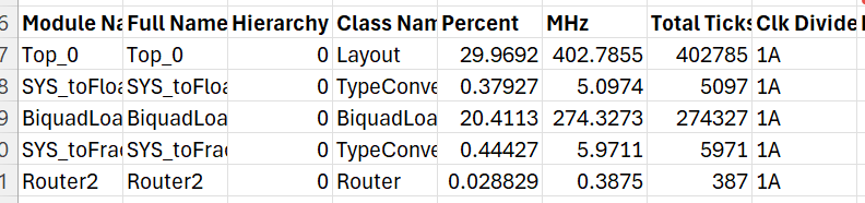

Single Threaded Processing
In this experiment, the system was doing audio I/O with TDM modules and using a BiquadLoading module to increase the CPU load. All processing was on the ADSP.

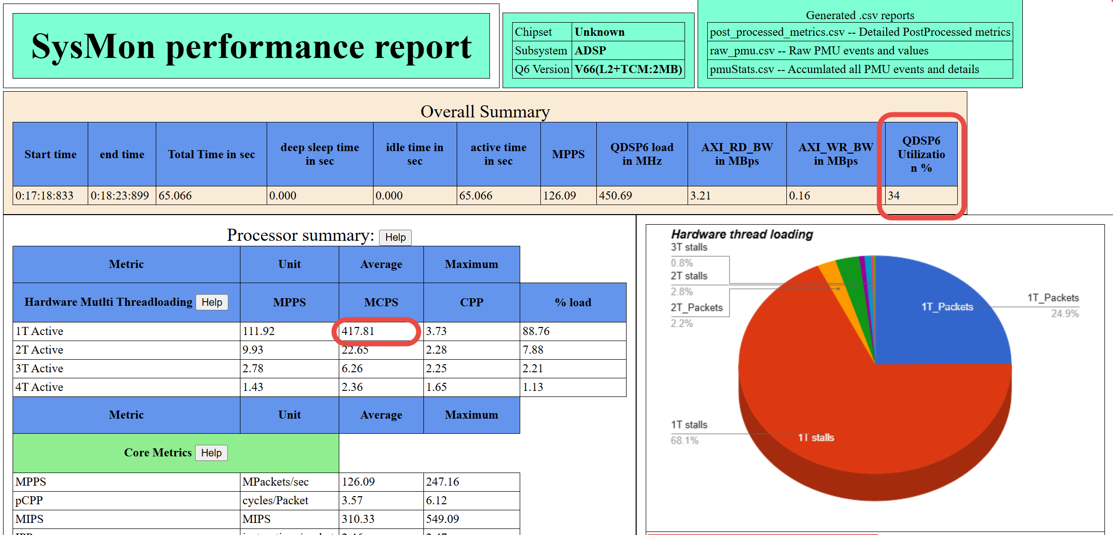

30% Loading in Audio Weaver
SysMon Profile
SysMon reports that the QDSP6 load was 34% and the average load for the 1T thread was 417.81 MHz. This matches closely what Audio Weaver reports.

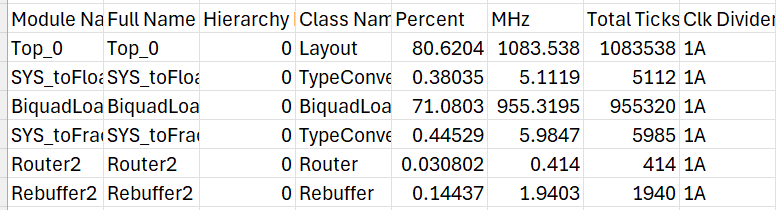

80% Loading in Audio Weaver

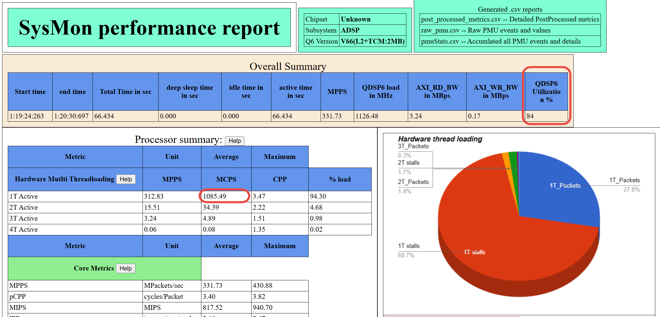

SysMon Profile
SysMon reports 84% total utilization with the average MCPS of 1085 MHz.

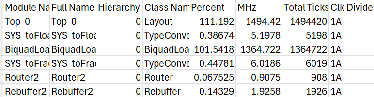

110% Loading in Audio Weaver
This is the overload scenario. Audio Weaver correctly captures the load, but behind the scenes it is stopping processing and attempting to restart.
SysMon Profile
The SysMon profile now only shows 22%. This is because of Audio Weaver’s resynchronization logic.
