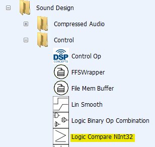

The LogicCompareNInt32 module can be found in Sound Design/Control folder or by using the search window in the module browser.
Figure 1. Location in the Module Browser.
