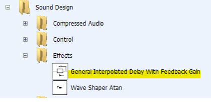

This Application Note explains the use of the Feedback Delay module in the Audio Weaver Application. The Feedback Delay module can be found in Sound Design/Control folder or by using the search window in the module browser. It is called “General Interpolated Delay with Feedback Gain”.

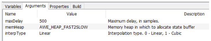

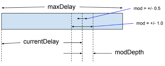

  • maxDelay should be set to the maximum of (currentDelay + modDepth). See below for descriptions of these parameters. All parameters are in samples.
  • memHeap – where to locate the RAM used by the delay module. The available options will depend on the configuration of your BSP.
  • interpType
  • Interpolation allows “between-sample” delay times to allow fine tuning
  • Linear - lower quality, low CPU use
  • Artifacts affect high frequencies
  • Cubic - higher quality, higher CPU use

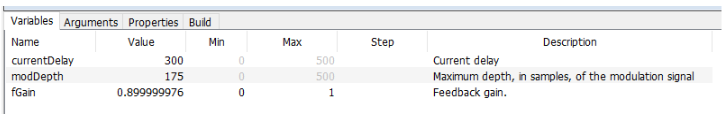

  • currentDelay – the center point of the delay setting. If modDepth = 0, or the value of the mod signal is currently 0, then the actual delay will be currentDelay.
  • modDepth – how far (in samples) to change the delay in response to a modulation signal at its maximum expected amplitude of 1.0.
  • fGain – the amount of feedback gain (linear)
Figure 5. Relationship of settings

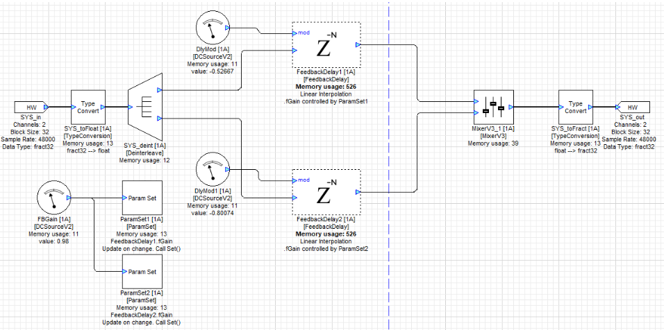

  1. Example dual resonator design
Resonator-Test.awd
The Resonator-Test.awd file shows the use of the Feedback Delay module as a resonator. There are two delay lines panned hard left and hard right listening to the stereo input signal. The delay time settings and modulation levels are individually settable. A percussive drum beat WAV file is included for testing to highlight the action of the resonator.
The feedback gain is set simultaneously on both modules using a pair of ParamSet modules driven by a DC Source. Note that the feedback gain must be around 0.95 or higher before you notice the resonance effect.
Figure 6. Example dual resonator design

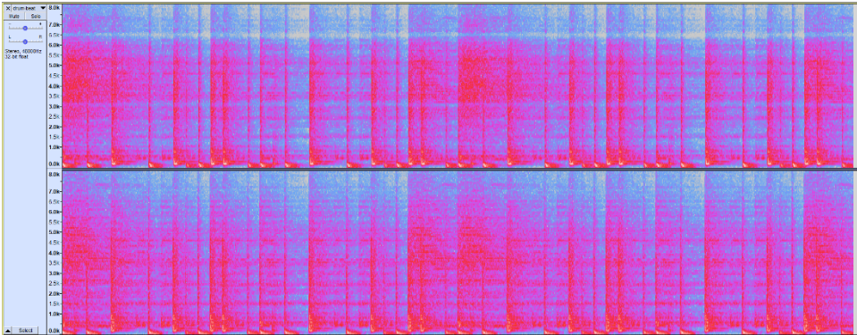

Figure 7. Spectrogram of drum beat WAV file before processing

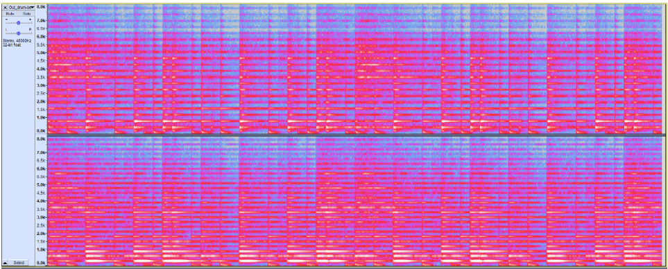

Figure 8. Spectrogram of drum beat WAV file after processing
As you can see and hear, the processed signal has enhanced the signal energy at frequencies whose periods correspond to integer divisions of the delay time. This is shown in Figure 8 by the strengthened horizontal lines indicating the amount of energy. The frequencies are evenly spaced on a linear scale. The spacing for the left and right channels is different as the delay times were different when the recording was made.
By adjusting the delay time, a distinct set of harmonics can be enhanced, which can enhance notes where they already exist, or seemingly create notes from noise. The subjective effect of changing the delay time while processing a signal with broadband energy (such as a drum track or noise) is a tone that gets lower when the delay time is increased, and higher when the delay time is decreased.
