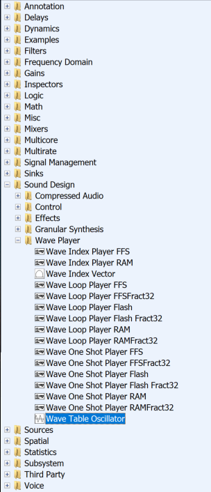

The module can be found in Sound Design ->Wave Table Oscillator in the Module Bar on the left-hand side of AudioWeaver Designer.
Figure 1: Wave Table Oscillator Module Location

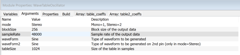

Arguments can be found Rt Click View Properties second tab in the properties as shown. The figure below shows arguments of the Wave Table Oscillator module.
Figure 3: Arguments in Wave Table Oscillator Module

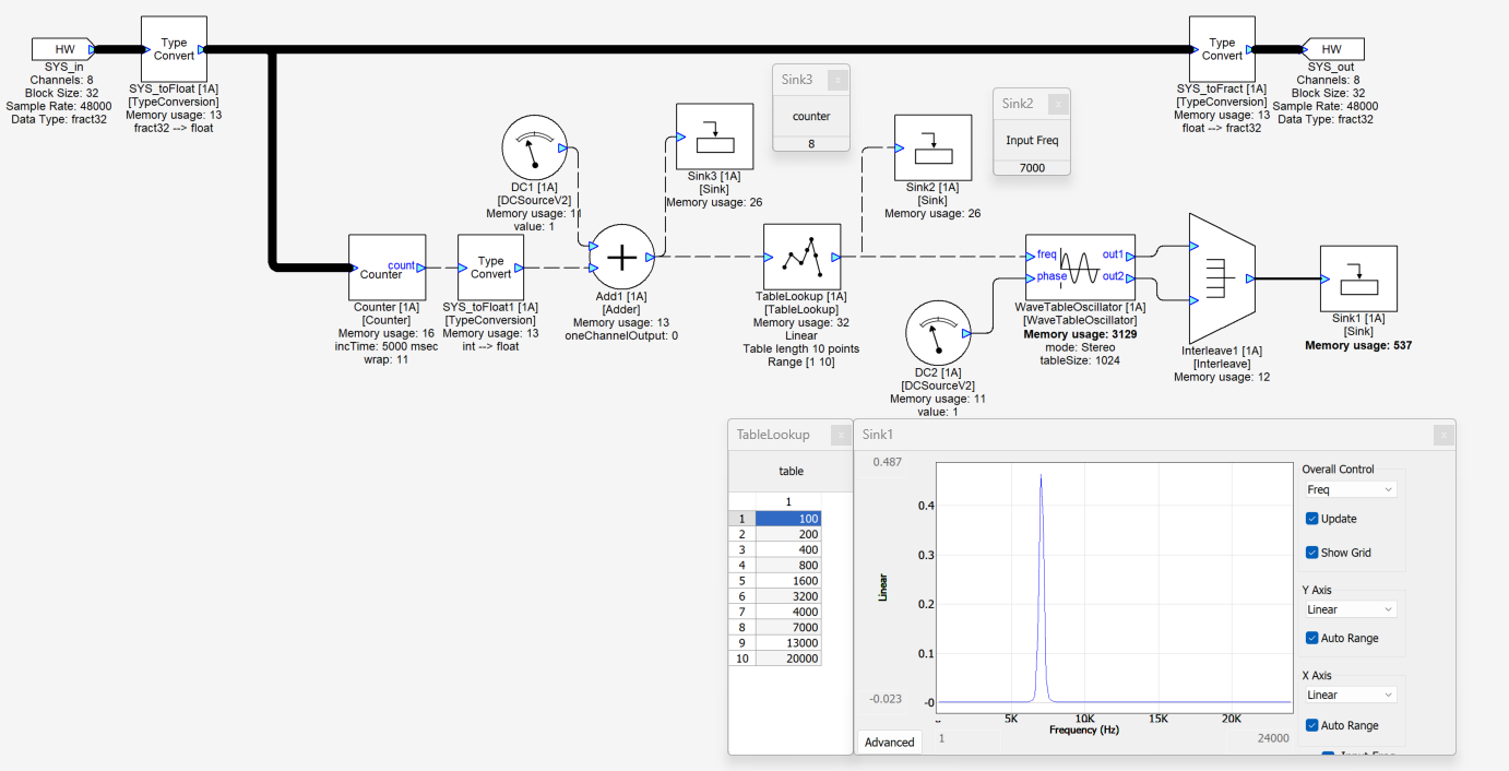

To demonstrate the workings of the Wave Table Oscillator module we are using the example below. We want the module to output a Stereo Channel with 256 Block size, 48kHz Sample Rate, Waveform1 and Waveform 2 are both Sine. We are changing the frequency after every 5secods by Counter module which is set to 5000msec for time increment. The counter output is connected to a Table Lookup module with 10 inputs for frequencies as shown in the Lookup table below. According to the input frequency we get appropriate waveform at the output pins which can be seen at Sink1. Here the counter is at 8 which translates to 7000 Hz in the Lookup table and as seen correctly in the Sink1 module in Frequency mode.
Figure 4: Wave Table Oscillator Module Example

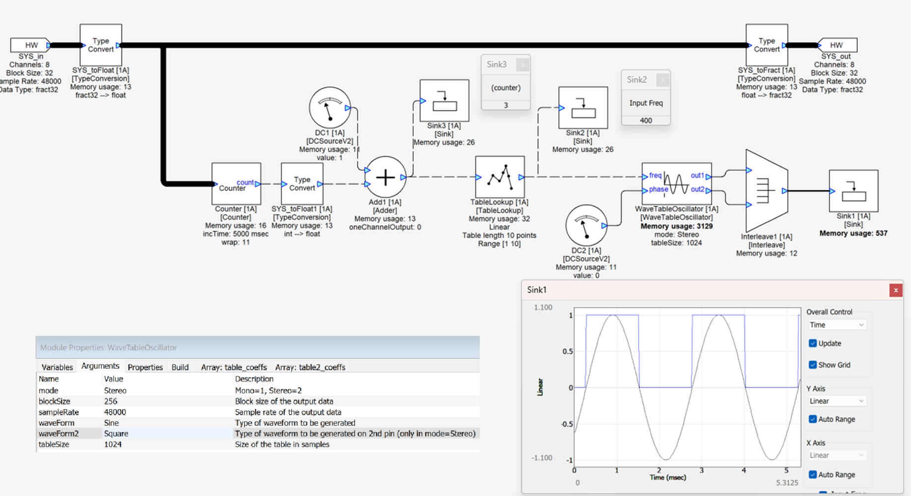

Changing it for the example below we have Waveform at Sine and Waveform2 at Square with the output shown below.
Sine.wav WaveTableOscillator_Example.awd Square.wav
