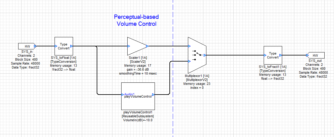

Figure 1 shows an example layout demonstrating the PlayVolumeControl Reusable Subsystem. This example layout is designed to run in Native Mode with a file input; audio signals must be assigned to appropriate channels for running the layout on a target device.
Figure 1: Example layout demonstrating the PlayVolumeControl Reusable Subsystem

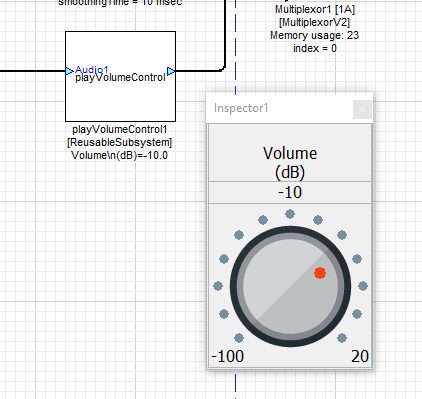

The PlayVoice Reusable Subsystem includes an inspector that allows users to change the volume gain.
Figure 2: PlayVolumeControl Reusable Subsystem inspector window
