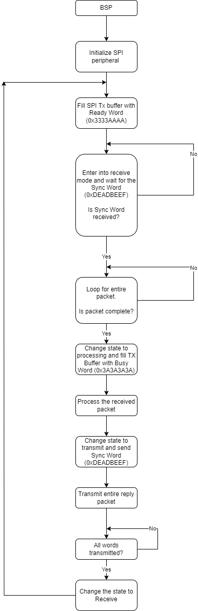

To communicate to the server that the target is ready to receive a message, the entire SPI output buffer must be set to the "ready" word 0x3333AAAA. After a message is received by the target processor and the message is being processed, the entire SPI output buffer will be set to the “not ready” word 0xA3A3A3A3. This will allow a host processor to poll the SPI interface waiting for the target processor to complete message processing. The target processor will continue to transmit the not ready word until the message has been processed. At this point, it will switch over to the "sync" word 0xDEADBEEF followed by the complete message. Once the entire message has been sent, the SPI output buffer must be set to the "ready" word again. See the diagram below for how to implement a SPI based tuning interface:
../images/spi_tuning_protocol_light.png
If the host processor continues to read beyond the end of a reply from the target, then the target will return 0xFFFFFFFF or the last transmitted word, which could be the "ready" word depending on the SPI peripheral configuration.

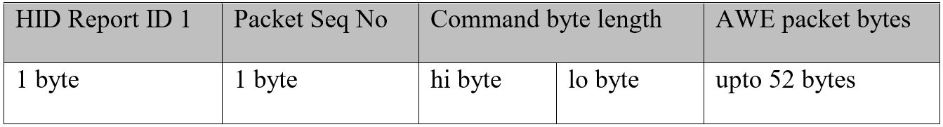

USB Protocol
Audio weaver USB communication is based on the USB HID protocol. Audio Weaver commands and replies are encapsulated in one or more 56-byte HID report packets operating over a 64-byte USB pipe. Each HID report packet starts with the HID report ID. Audio Weaver uses HID Report ID 1. If USB HID communications are used for other firmware features, those features must use a HID Report ID other than 1.
Following the HID report ID is a one byte sequence number and a two byte length field.
../images/hid_protocol.png
